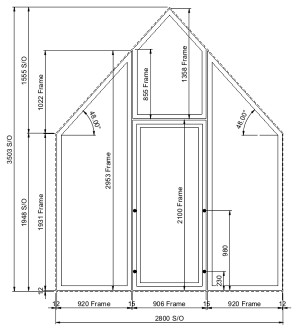

this is our gable end.
73521381_Screenshot2021-07-27at18_37_01.thumb.png.bfc5ce614c08ee816254b30a695e2cc3.png
cost for the glazing (not including the front door and top light above) £4500. triple glazed alu-clad.

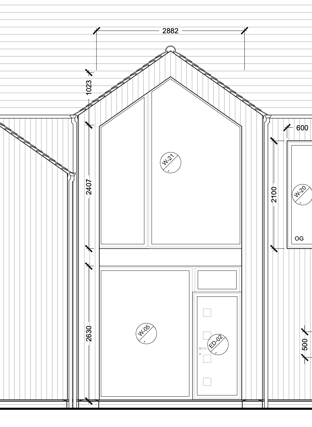

We have glazed gables, with tilt & turn doors, triple glazed alu clad. £3.3K each inc VAT, excl delivery...927336216_Screenshot2021-07-27at18_39_57.png.78544c6dc859b081dabdd3b12ab71766.png

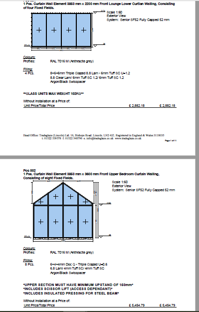

Looking to go with a glazed gable here, local company to me provided a quote, prices for the gable below.  All alumininium windows, including installation eye wateringly 37k, need to re-evaluate all the other windows.  Getting some other quotes off plan at the moment.
That's good to know, it's nice sharing glazed gables! I shall have to see if I can get a plan view of ours up here too.  Looking at all your quotes for the glazed gables I think the ball park for ours at £9k doesn't seem too bad, it may come in at more, I am just waiting for an official quote and that price I'm told will not include installation.
