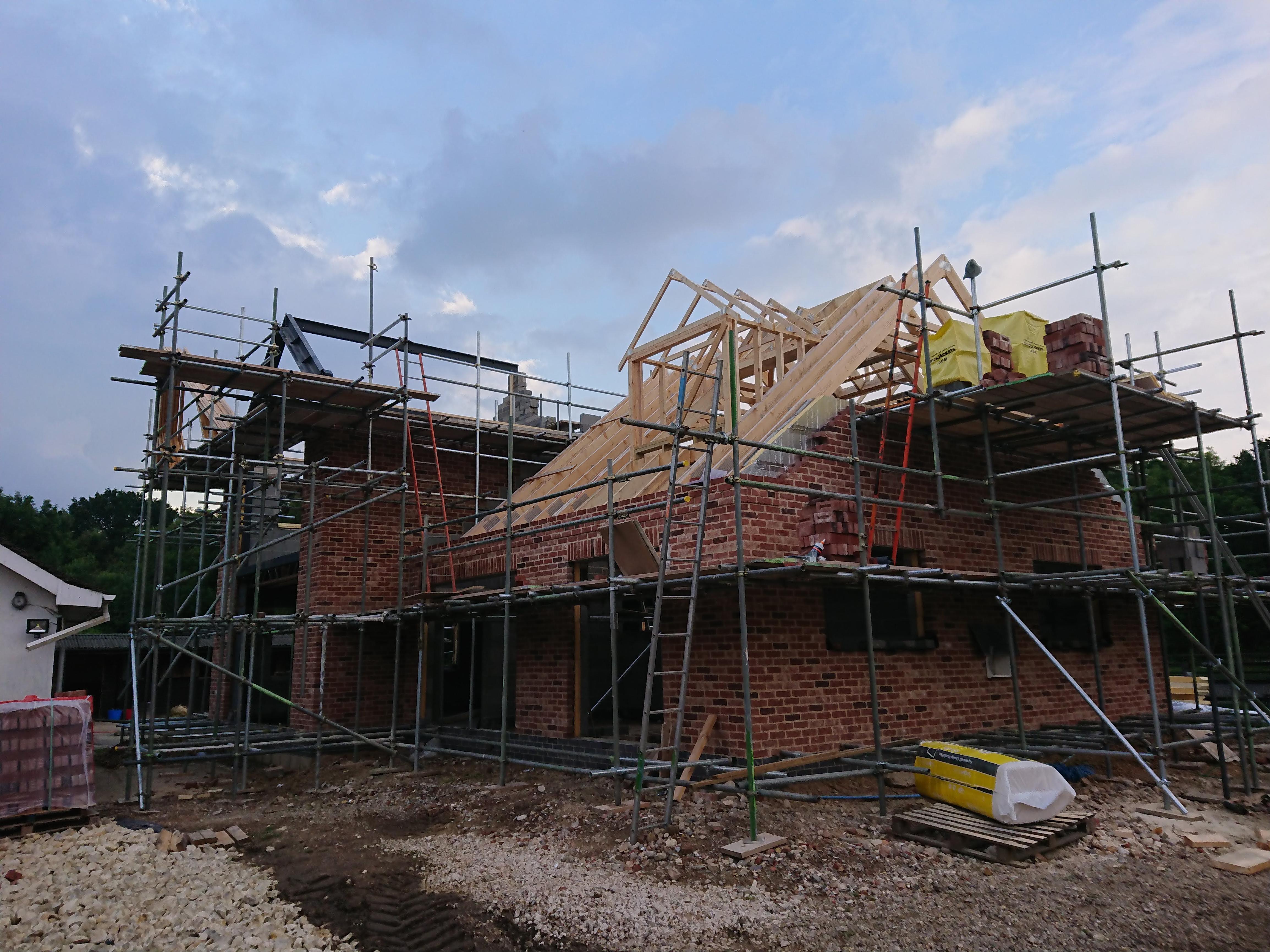

Re: Steels,  Same two storey affair here.  Our steel fabricators managed mine, thankfully!  We had two columns bolted to the foundations, these were about first floor height, then a cross bar was bolted between the two (goal post setup), these had plates welded on top, two more steels were then lifted onto the first floor deck and man handled onto the plates and bolted down.  The angular pieces were also man handled into place and bolted together, and a steel ridge beam was then bolted to the top of the gable.
Hopefully this picture (not the best) gives an idea,

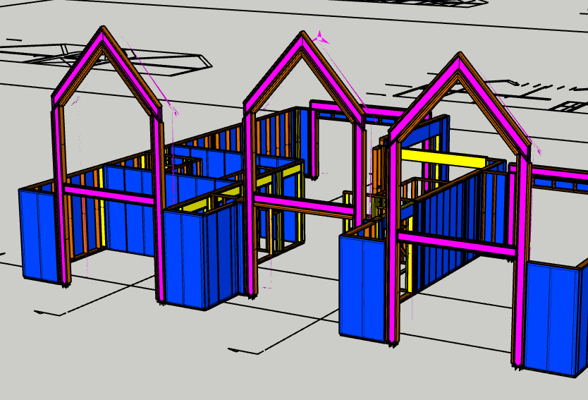

Our steels at the glazed gables are portal frames - below in pink...

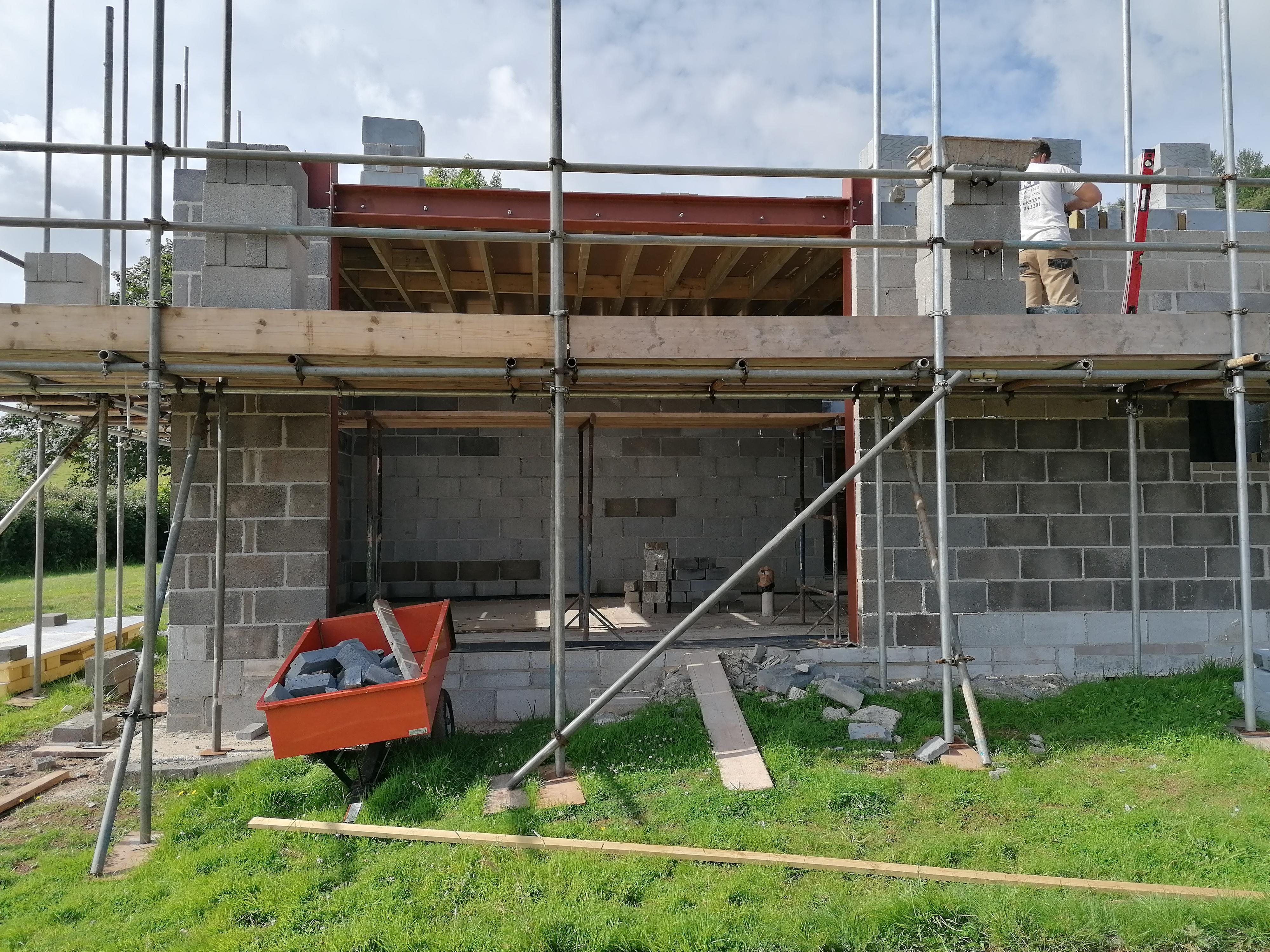

This is our gable as it stands at the moment with the steels having been built around.

Ours is exactly the same set up as yours by the sounds of things so two vertical steels to go on top of the ones already there and then another horizontal at wall plate level (this is a bit different from yours) and then the triangular section.  Amazing to hear your guys manhandled it into position, that must have taken quite some doing!  The structural engineeer wanted the vertical steels to all be one peice, from floor of GF to ceiling of 1st floor, but the builder went back and explained how impractical that was, and so it's been broken into two sections to attach to one another, exactly like yours by the sound of it!
