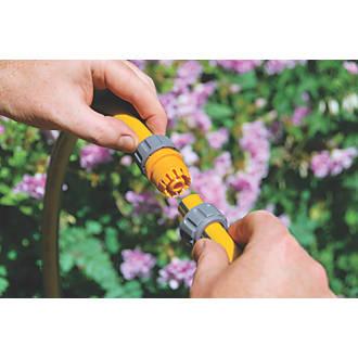

Mulberry View Posted July 14, 2021 Author Share Posted July 14, 2021 5 hours ago, Onoff said: Couple of hosepipes to make a water level. Pretty foolproof imho. Errrr, excuse me?! What is this? Link to comment Share on other sites More sharing options...

Onoff Posted July 14, 2021 Share Posted July 14, 2021 51 minutes ago, Mulberry View said: Errrr, excuse me?! What is this? You can use a garden hose(s) and just attach some clear sections each end with jubilee clips etc. Just make sure the air's all out. Link to comment Share on other sites More sharing options...
