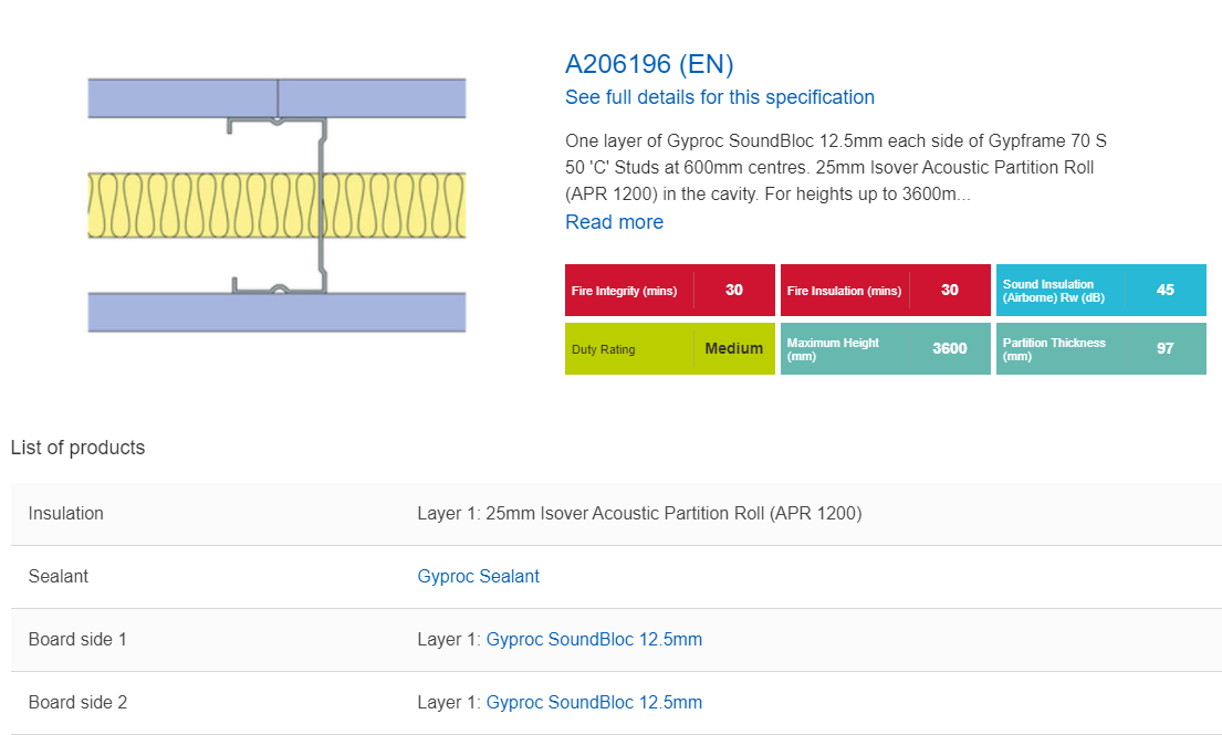

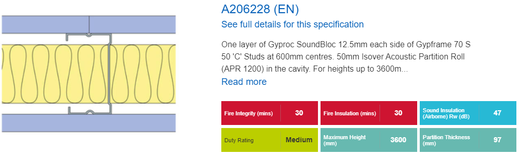

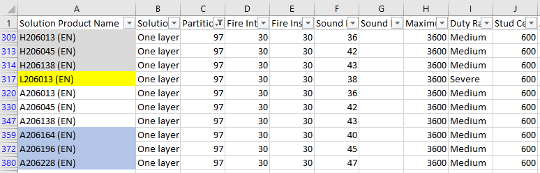

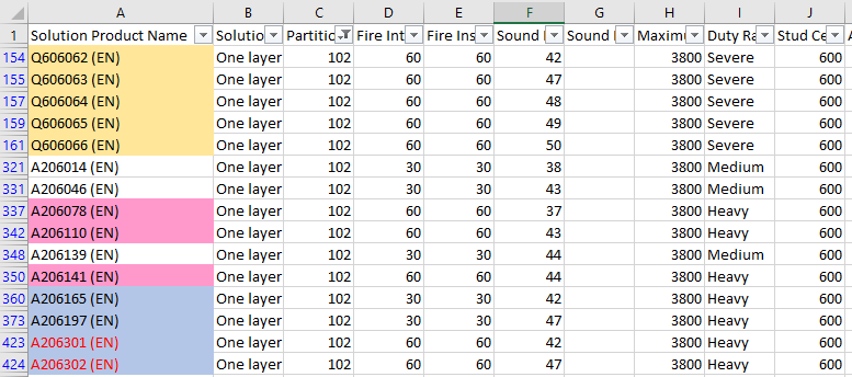

MortarThePoint Posted March 28, 2022 Author Share Posted March 28, 2022 (edited) I wanted to check the effect of varying Acoustic Roll thickness on sound and the headline is adding just 25mm is 5dB better than having none, but adding 50mm is a further 1.5dB better. It may be cheaper to upgrade the plasterboard than double the thickness of the Acoustic Roll (SoundBloc+25mm is better than WallBoard+50mm). The Gory details: Maddeningly, BG have changed their product selector website and it's near useless. Previously I remember you could select which studs and plasterboard you'd use but now its got all the detail codes instead of the stud type. It says "To see all Specifications that use a particular Product, please go to the Product page and look for the ‘Show me all specifications that use this product’ option." but if you select a specific stud type results include other types! Sadly the madness doesn't end when you download the CSV. Although the table includes stud type etc, the columns are messed up so the data can be in the wrong columns 😞 How hard can it be! I added a column that concats all the columns after the abutment one (as many use C studs for abutments but other studs mainly) checked if the concat contains the stud name I want and then filter. {EDIT: easier to use find on column B} Below is some extracts. The colours are Duraline orange, WallBoard white, Fireline pink, SoundBloc blue (red text if SoundBloc F), TileBacker grey, and Habito yellow. Multiple lines as different insulation options, the first of each group is no insulation. The first 5 are the 15mm Duraline with the following insulation (APR 1200 unless says): none (42dB), 25mm Isover Acoustic Partition Roll (APR 1200) (47dB), 50mm Isover Acoustic Partition Roll (APR 1200) (48dB), 80mm Isover Modular Roll (49dB), 75mm Isover Acoustic Slab (50dB) Other sheet types that have less options follow that order though (double check). 102mm Partitions with 70 S 50 C-studs: 97mm Partitions with 70 S 50 C-studs: Edited March 28, 2022 by MortarThePoint 1 Link to comment Share on other sites More sharing options...
