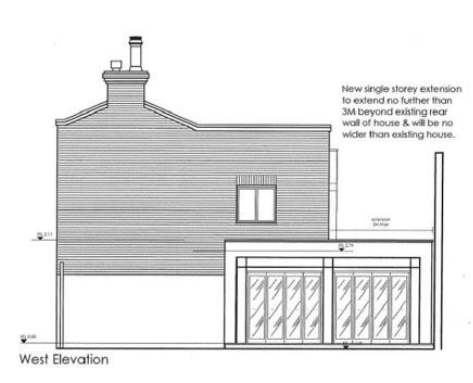

I suspect the problem is with the large flat roof that I assume lurks behind the new parapet wall along the side of the extension. Does this side wall of the upper floor move towards the viewer by about 3m or 4m?
the roof is not very flat and is matching the pattern of all other backs (14 of us), which are all butterflies (I'm told they are called), except one flat who escaped planning scrutiny and sneaked what they fancied..  ?
do you think this could work - with a green living wall feature ?
could look striking but not safe by more sonservative accounts..

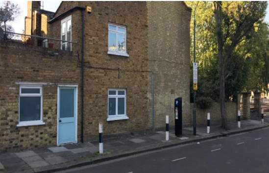

Can I just seek clarification on a couple of points? Are you proposing:
  • two extensions, a ground floor and a first floor
  • with the first floor being extended so that its side wall is flush with the side wall of the existing ground floor (and part of the existing first floor)?
What is in front of that side wall? Is it a street which is perpendicular to the street that your house is on, because being an end of terrace you are on a corner? Or did you say it was a footpath, i can't remember? Just trying to understand who will see that aspect of your project.

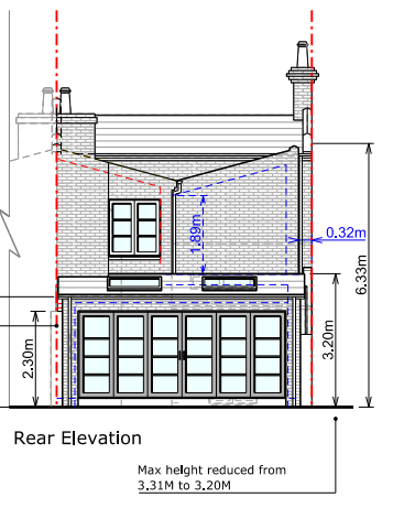

If you can make it work structurally you could set the wall above about 2.4m back 300mm or so to accommodate the living wall this would reduce the overhang of foliage over the footpath and create quite an impressive feature with environmental and sight line benefits I would not slope the bottom as you have but that might work also but with the back set. This would increase costs but, as you would not need to use brick above this line on this face, you won't see them so they need not be there, might not cause onerous structural issues.
PS I would also take it to full height.
  • Thanks 1
like your ideas thank you! we thought of the wall setback and green feature as option2 for the application but the structural costs would be a lot higher so we didn't apply for it in the end. worth considering if all else fails with the appeal - it could look very pretty indeed. But that would mean moving the window to the back wall and overlooking the neighbour again ?

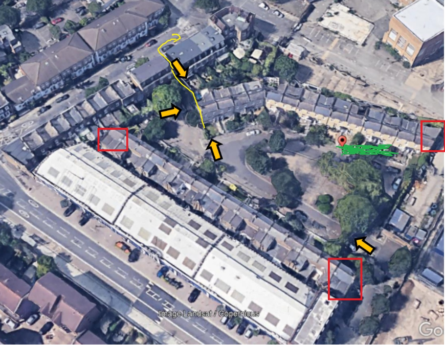

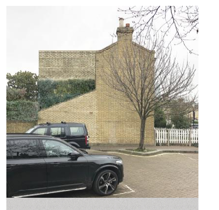

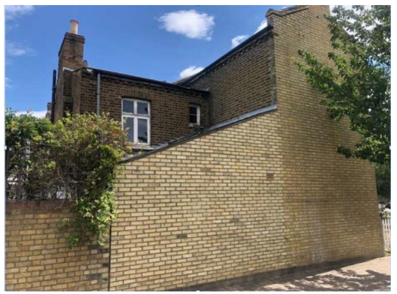

that's right, 2 extensions of about 150 sq ft in total, with the side wall flush with the existing ground floor
the map looks like this - yellow arrows point to our building, and the yellow line is the tiny footpath - only residents of the square would use it to get to the main street north bound, hardly anyone walks there, most people arrive/leave by car
red blocks are other end of terraces, which are all extended, you can see below their extensions
facing our side wall is open space, trees, some parking - we are not the focal point of the square, the open spaces are everywhere. looking at it from proportions point point of view - we are a tiny drop in the ocean, surrounded by much taller neighbours (directly behind us is the one who objected). Massive new redevelopments to the north, east and south from our building
they allowed this on end of terrace 1
and this at the other end 2

Can I just check buttercup - the green wall was not part of the planning application and refusal. Are you suggesting we appeal whilst also run with the new green wall application in parallel? Or is it possible to propose a condition on us to include green wall and move windows to the back - as part of the appeal process?

In relation to MikeSharp01's suggestion,  I think if you get a hint that sustainability is an issue,  then his idea would be one way of delivering that.  Mike always has good ideas.....
  • Thanks 1

2 hours ago, MikeSharp01 said:
You could talk to the planners about the green wall before going to appeal so you give them the option to "look again"  before committing to appeal which will cost them a heap of time and money. You have 320mm backset to play with and the green wall can sit quite comfortably just adjusting out the slope.
I would advise preparing for an appeal (argumentation etc) and then get a local planning consultant to discuss this with the planners, with a 'look again' option held out as a way for them to gracefully stand down.
We achieved this simply by producing some axiometric (i.e. as viewed on a 45o angle) drawings and low and behold the objections evaporated - it did not require changing the scheme, which had already been toned down once following the original refusal.
