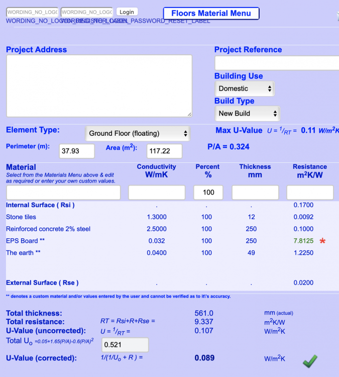

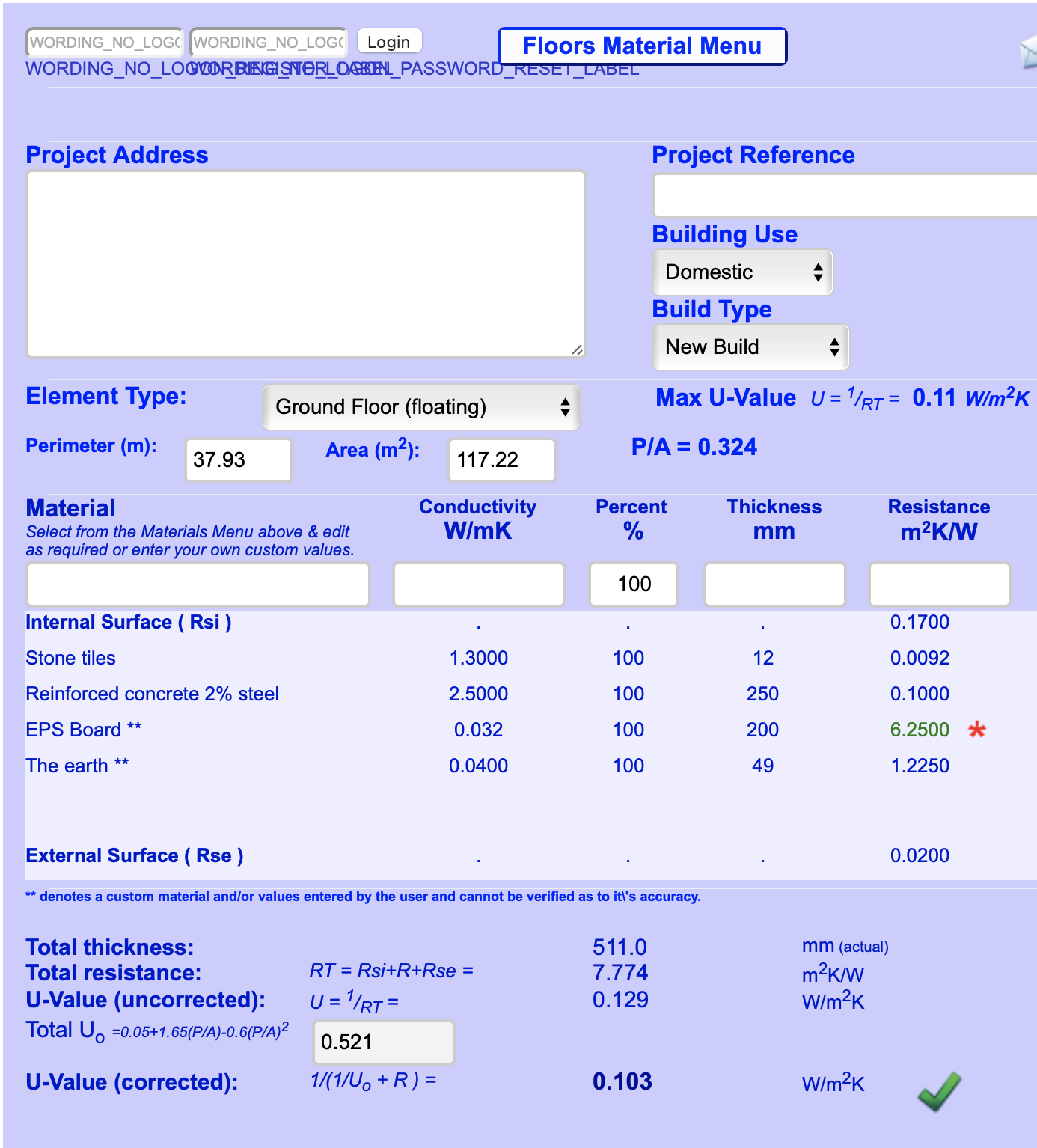

40 minutes ago, Dan F said:
Have you recalclulated without PIR?
comes out to 0.103W/m2K when adding the 3.5m below ground insulated effect (14mm x 3.5m of 0.04W/mK insulation)
690793094_Screenshot2021-04-21at18_42_52.thumb.png.906f51524a4d2510355a6c2f1cea0119.png
which will do me just fine.

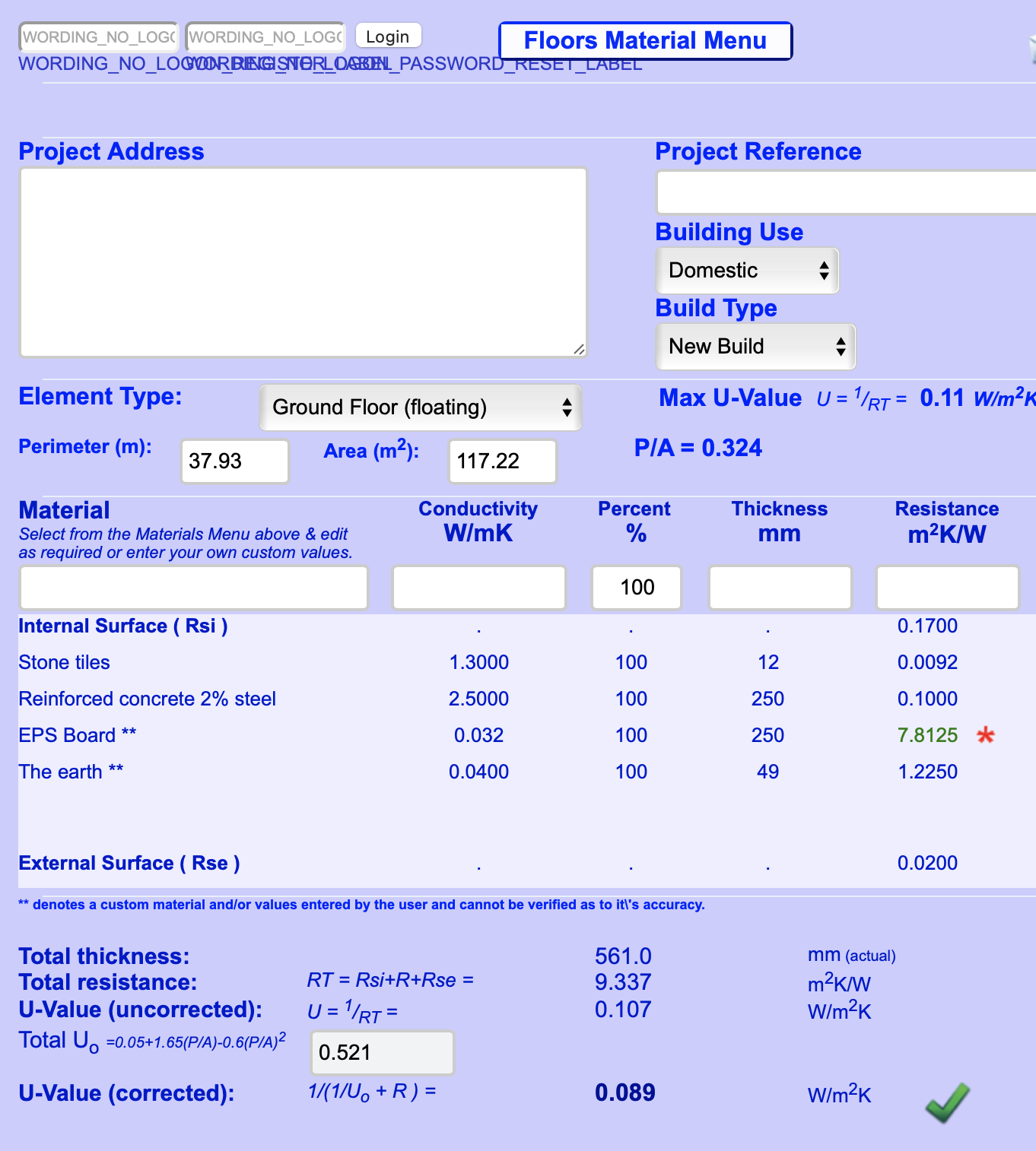

increasing it to 250mm EPS300 gives 0.089W/m2K
1203058855_Screenshot2021-04-21at18_43_08.thumb.png.9aa7a18de255a3ea908856036c3e96ce.png
which, when you consider the extra cost of dig out and muck away over the area and the cost of the extra EPS300 and labour to lay it, I'm not sure it's worth it.
