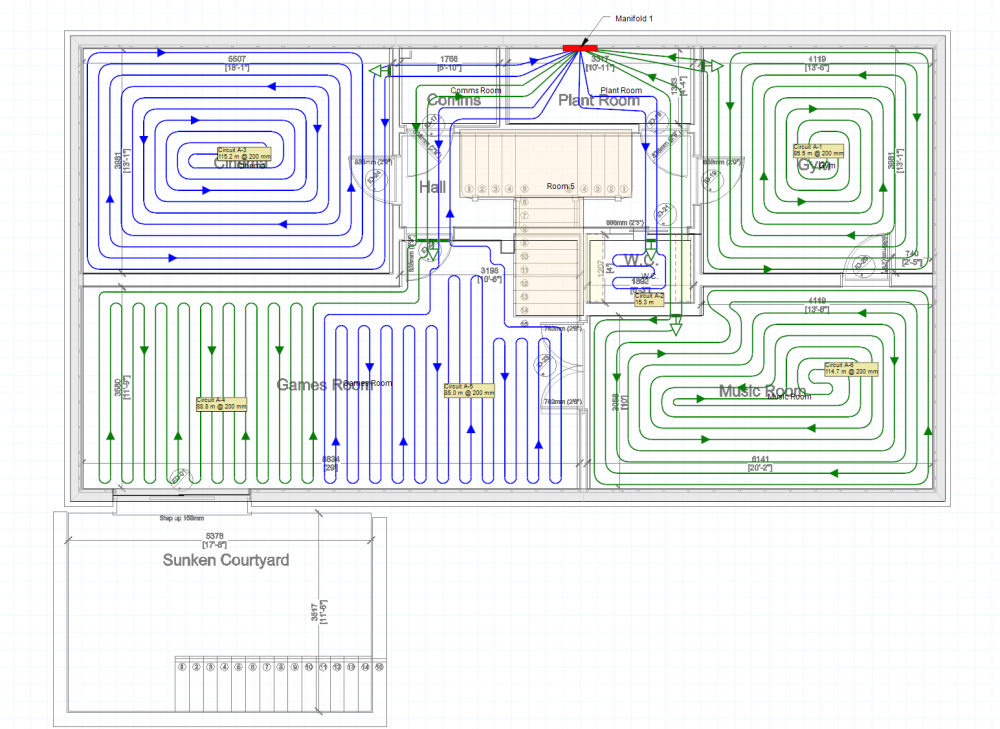

Can a slab be too thick to have UFH pipes in it?

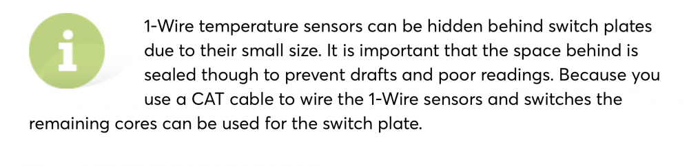

5 x 3m 3wire 1-wire temp probes ordered from eBay and delivered ready for installation!

If you are buying DS18B20 sensors make sure they are the real thing, not copies and work properly.  They all have a unique serial number. Someone on here bought a load and calibrated them, I think 3 out of 20 failed.
would agree with that, I got 15, so far used 6 (7) one was faulty. Also had to add a calibration factor to all of them. All were reading high, max was 2 deg, min was 0.5 degrees. Used a medical thermometer as the ref.

On 21/04/2021 at 15:54, Thorfun said:
I know a large number of folks on here have insulated slabs where generally the slab is 100mm thick and the UFH pipes are cable tied to the rebar.
We're going this route now for our basement UFH but our slab is 250mm thick with 200mm EPS underneath.
I was just wondering if a slab ever got to a thickness where putting the pipe within the slab became the wrong thing to do?

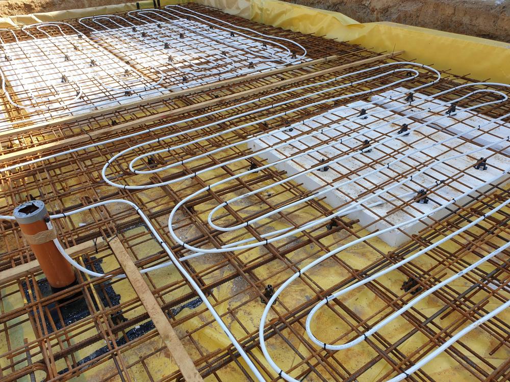

Bit of general comment from me re slab thickness and UFH, pipe abrasion / expansion, concrete slab shrinkage and stuff. Excuse the spelling and grammer please as I'm off duty.
I'll start with my plumbing / concrete hat on, also bringing to the table that I've been "experimenting / sefl building" with different UFH designs for the last 30 years.
Ok if you have structural slab you probably want to put the crown of ( the top of the pipe) UF pipe say 40-50 mm below the surface. This allows for a sensible construction tolerance and the unexpected pipe overlap when you make design changes at the last minute. There are some that advocate for less but this is self building.. cut yourself and the builder some slack.
**This is self building.. you generally don't have the same control over workmanship as say on a major contractor project.. keep things simple stupid. If you are anal and want to tie down your builder to tight tolerances then you either need to be able to check this or you will end up paying for something that never gets delivered. I see this all the time!
Now if we have a simple ground bearing slab on say EPS then I would put the anticrack rebar mesh near the top of the slab. I have on several occasions tied the UFH pipe to the mesh.. with zip ties. Now this can be great thing to do yourself. It gives you that feeling.. here we are putting in the pipes that are going to make our home warm.. it's romantice and gives you a spurt of joy / keeps the spiits up. I say this as I've done this and felt it more than once.
Get the builder to lay in the mesh and tie down your own UF pipes! A good way of getting it right.
Now lets look at the behavoir of the concrete and the UF pipe preparation. Most UF pipe is rated to 10 bar (it decreaes depending on temperature). I tend to pressurise the UF pipe to 4 bar and hold that for a couple of days.  Now I lay the concrete. The concrete has plastic shrinkage ( first 7/ 8 -24  hours / then drying shrinkage. My own experience tells me that the concrete shrinks a little (a mircon of two) away from the pipe and the rebar. Pretty much all heating sytems have a pressure relief valve set at 3 bar. In the round my view is that pipe abrasion can be shown by calculation to be negligeable / none at all.
BUT .. SE hat on now. If you have a concrete slab is a structural raft with big point loads then you can still put your UFH pipes in but I'll tell you where you can't put them. Generally it's not to onerous but you'll need to pay me a bit more to do you a couple of drawings.
