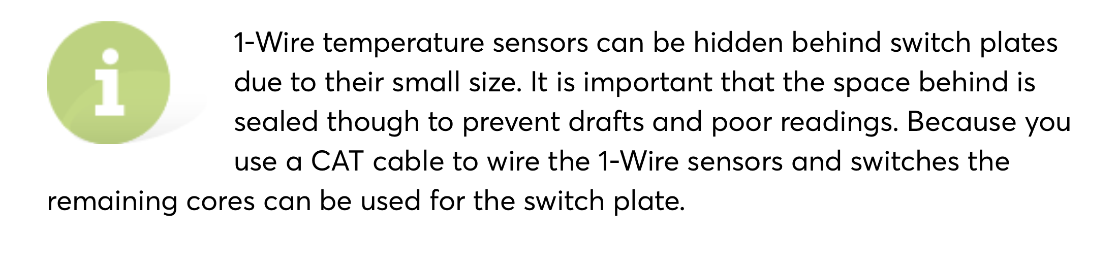

It's interesting that you mention powering independently rather than parasitically helps. I am just doing more reading on 1-wire and was interested to know the benefits of one over the other but I've yet to get that far in my reading.
I think I'll go for the approach of bringing a conduit near to a wall with back plates. those back plates could always be switches and Loxone seem to say that you can then use the other pairs of the CAT 7 cable for the switches.
from https://www.loxone.com/enen/kb/wiring-1-wire-devices/ that @Dan F linked previously....
1153669079_Screenshot2021-04-26at13_41_53.thumb.png.bac2e4e9c6481212bd157a10beea69e5.png
so was thinking of running the probes to the location where the switch plates would eventually be. seemed quite a sensible idea.

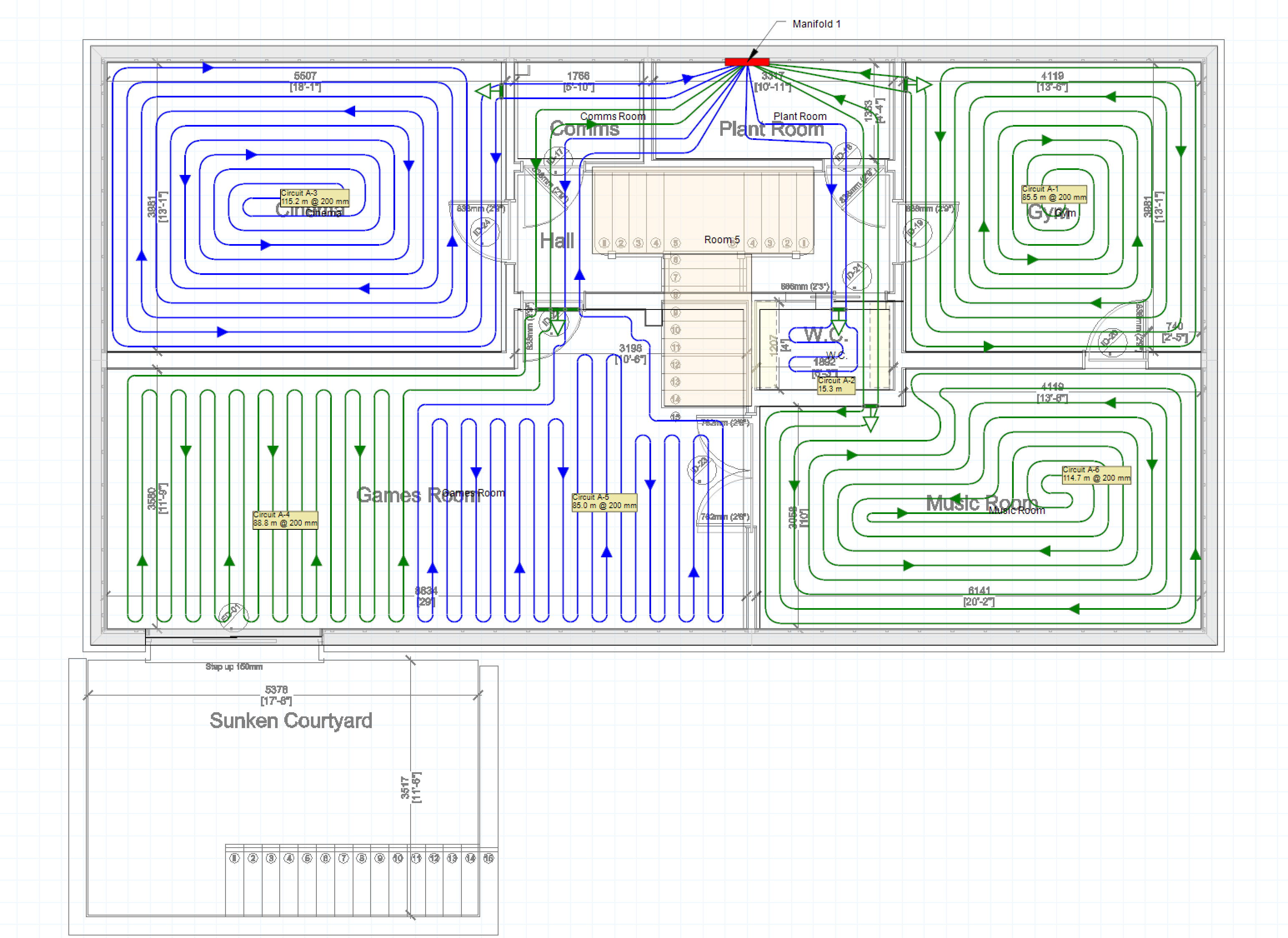

put my plans in LoopCAD and came up with this:
377876170_Screenshot2021-04-26at17_07_41.thumb.png.e8f5d68746be6bce5040d2f09c07250b.png
I'll see how it compares to Wunda's design but I'm pretty happy with what I came up with.
doubt I need that loop in the WC but I figured what the heck!
was going to put 1 x temperature probe in each of the 4 main rooms just in case I decide to zone the basement. I ordered 5 of these at 3m length. it'll do me for now.
ps. all the internal walls are block so no penetration of the slab is required. which is why I'm comfortable running pipes under the walls in places.
