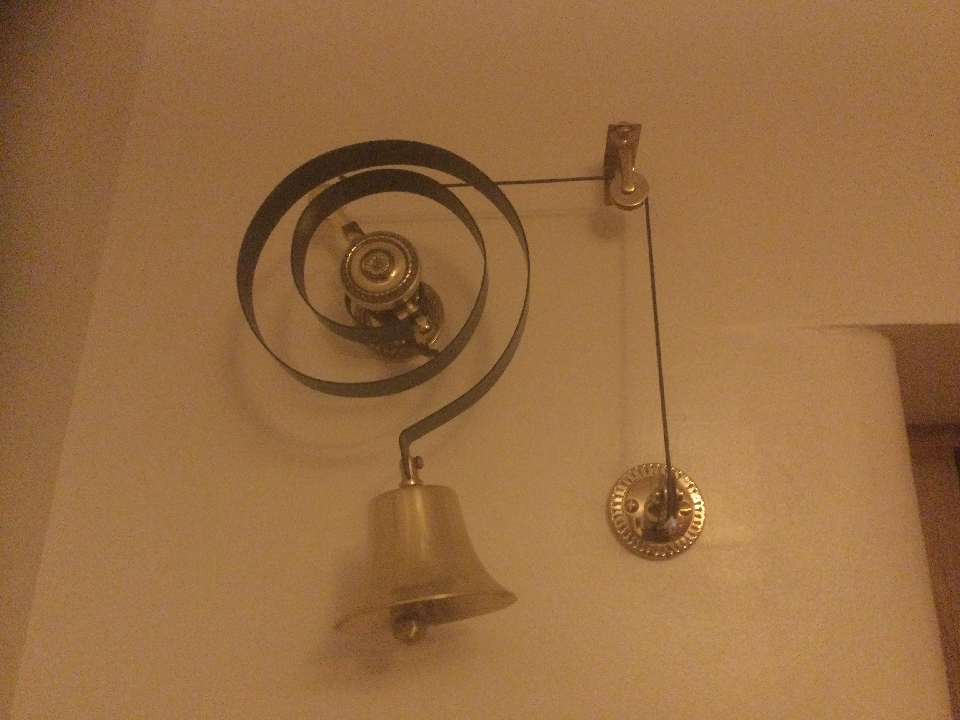

joe90 Posted April 11, 2021 Share Posted April 11, 2021 1 hour ago, ProDave said: . Yes I am old school. Not as old school as me...... 1 Link to comment Share on other sites More sharing options...
