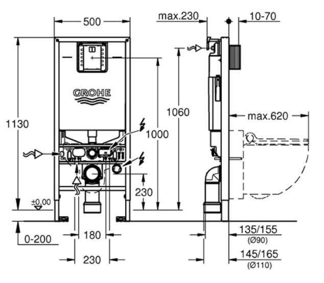

Adsibob Posted April 4, 2021 Author Share Posted April 4, 2021 2 hours ago, Nickfromwales said: Concealed cistern + wall hung pan? Concealed cistern + floor mounted pan? Which one fella? ? Well both actually. For most of our toilets I want them wall hung, but we don’t have the thickness in the wall to do this with one toilet, so for that the pan will be floor mounted, but if possible I’d still like to conceal the cistern. How much wall thickness do I need just to conceal the cistern? Link to comment Share on other sites More sharing options...
PeterW Posted April 4, 2021 Share Posted April 4, 2021 2 minutes ago, Adsibob said: but we don’t have the thickness in the wall to do this with one toilet, so for that the pan will be floor mounted, but if possible I’d still like to conceal the cistern. How much wall thickness do I need just to conceal the cistern? Same thickness as a frame so about 110mm. Link to comment Share on other sites More sharing options...
Nickfromwales Posted April 4, 2021 Share Posted April 4, 2021 36 minutes ago, Adsibob said: How much wall thickness do I need just to conceal the cistern? You can get a 90mm odd one into a 100mm ( 4” ) stud wall.Link The thickness of the soil connection will rule the terminal thickness, but you can squeeze these in with a bit of engineering. Done a few with great success. The issue becomes one of sound ( noise ) transmission to the next room, and if BC are involved they may not be happy ( if they know about it ) so you’d probably need to double up on acoustic plasterboard on the reverse wall, plus stuff as much acoustic insulation in / around as possible, making sure you don’t cause any compromise with condensation from the uninsulated parts of the cistern. Grohe are bombproof, and the mention of moving parts / leaks is only relevant if you have a concealed cistern. The cistern in the frames is one-piece and never leaks, ever. All the components replace through the flush plate aperture so you can box / tile them in and not ever have to get to the frame etc again. Been fitting Geberit for nearly 2 decades without a single failure. Link to comment Share on other sites More sharing options...
