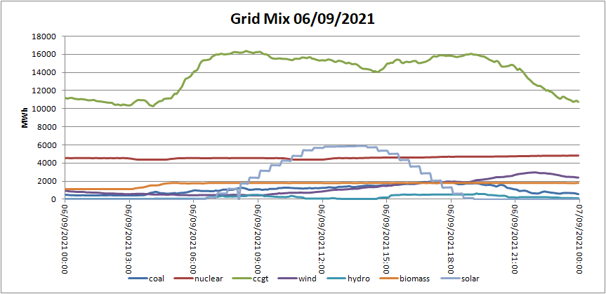

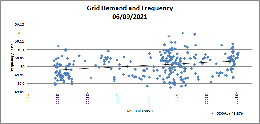

SteamyTea Posted September 7, 2021 Share Posted September 7, 2021 First day back at school after the holidays. Couple of charts. Link to comment Share on other sites More sharing options...

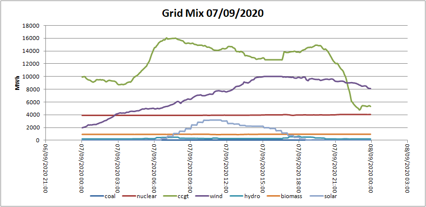

SteamyTea Posted September 7, 2021 Share Posted September 7, 2021 And Last year Link to comment Share on other sites More sharing options...

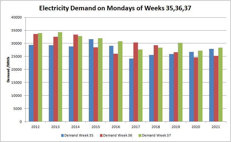

SteamyTea Posted September 7, 2021 Share Posted September 7, 2021 (edited) Just had a look at the last ten years worth of electrical generation data. I picked Mondays during weeks 35,36 and 37 as these will always take in the Bank Holiday and the main start of school. I suspect you will be getting cheaper power next week. I can't be bothered to look up when school started each year, but others can. Edited September 7, 2021 by SteamyTea Link to comment Share on other sites More sharing options...
Russdl Posted September 7, 2021 Share Posted September 7, 2021 @SteamyTea interesting stats but why does the first day back at school cause such a spike? @joth Agile has been very hit and miss for us, they seem to have plenty of problems but so far, with time, they’ve fixed our import/export issues. It took months and it’s all going Pete Tong again now but I trust them to sort it... eventually. @pdf27 so why the high spot gas prices? Is that all connected to the kids going back to school? I don’t get the connection at all. I guess I’m just slow! Link to comment Share on other sites More sharing options...
pdf27 Posted September 7, 2021 Share Posted September 7, 2021 2 minutes ago, Russdl said: @pdf27 so why the high spot gas prices? Is that all connected to the kids going back to school? I don’t get the connection at all. I guess I’m just slow! It isn't just us, the whole of Europe has the same issue. Seems to simply be a matter of supply and demand, so expect very high gas prices this winter. https://www.bloomberg.com/news/articles/2021-09-06/europe-faces-energy-price-shock-with-gas-and-power-at-records 1 Link to comment Share on other sites More sharing options...
SteamyTea Posted September 7, 2021 Share Posted September 7, 2021 32 minutes ago, Russdl said: interesting stats but why does the first day back at school cause such a spike Mondays are generally a high demand day as people return to work and industry ramps up after the weekend. This year has probably been more pronounced as many people who have not been working because of holidays (last week was very good weather) and the drawing to an end of Furlough. 1 Link to comment Share on other sites More sharing options...

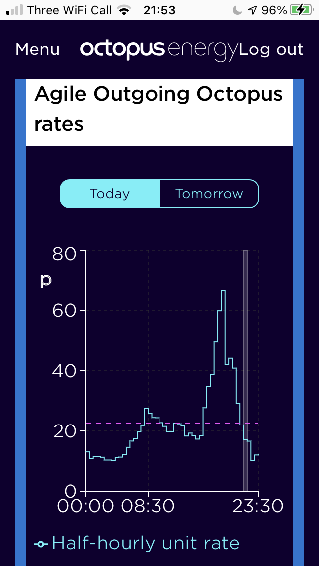

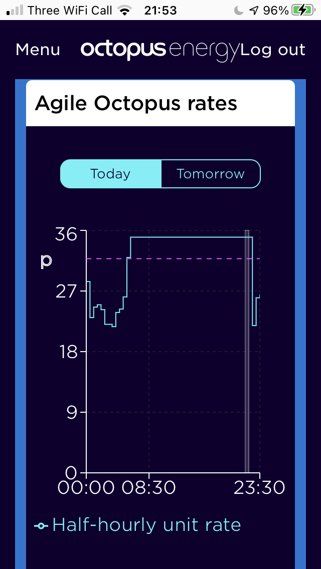

Russdl Posted September 15, 2021 Share Posted September 15, 2021 On 07/09/2021 at 15:09, SteamyTea said: I suspect you will be getting cheaper power next week. As it happens, we’re not. The Agile import rate is hitting its capped price of 35p/unit early in the morning, 07:30 today, and staying there til late at night, 23:30 today. It’s a similar story most days. The export rate exceeds the import rate at 16:30 today (49.49p a unit) and stays way above the import rate til 21:00. It peaks at 235.93p/unit at 19:30 - over 6 times the import price! It was way above 200p/unit yesterday evening as well. Link to comment Share on other sites More sharing options...
SteamyTea Posted September 15, 2021 Share Posted September 15, 2021 1 hour ago, Russdl said: As it happens, we’re not. The Agile import rate is hitting its capped price of 35p/unit early in the morning, 07:30 today, and staying there til late at night, 23:30 today. It’s a similar story most days. The export rate exceeds the import rate at 16:30 today (49.49p a unit) and stays way above the import rate til 21:00. It peaks at 235.93p/unit at 19:30 - over 6 times the import price! It was way above 200p/unit yesterday evening as well. Those numbers seem insane. Is there anything on the ELEXON portal to show this as a general trend, or has Octopus over promised and under bought. Link to comment Share on other sites More sharing options...
