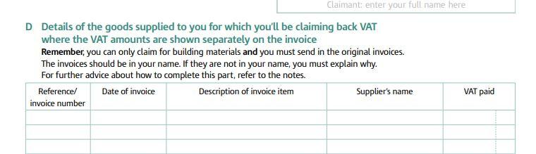

jack Posted March 22, 2021 Posted March 22, 2021 32 minutes ago, Moonshine said: As for recording materials I am thinking a massive spreadsheet record and scanned receipts. You need to supply original receipts, but do scan them and record them in a spreadsheet as you go. Not doing this means a massive job at the end. The spreadsheet doesn't need to be anything special - just include the same column headings as in the form and you can print it out and include it with the reclaim form. Add a sequentially numbered column to the left and pencil the number onto the corresponding receipt. The order isn't at all important. 10 minutes ago, Wagas said: I started taking photos of each receipt, to keep on file, but gave up as it would have taken too long. Maybe if you do it as you go along it's not so bad. Given how much could be at stake, I think scanning or photographing each receipt/invoice as it comes in is good practice. I wouldn't be surprised if we misplaced the odd one here and there along the 6 year journey from starting the build to making the claim. Also, in the unlikely event the parcel goes missing when you send it to HMRC, you at least have a record of what's been lost. 10 minutes ago, Wagas said: Cannot claim VAT on labour or hire. Hire won't be zero rated, you just have to pay the VAT unfortunately Note that hire with an operator can be claimable. We missed a trick with this: we had a large telehandler with operator for a day to help install the windows. That should have been zero rated, but it was too late to correct it by the time we realised. Not claimable afterwards - if there's a labour component to the invoice, the whole thing must be zero rated at supply.

ProDave Posted March 22, 2021 Posted March 22, 2021 My suggestion is print out the VAT claim form NOW and as each invoice comes in, write it down (yes with a pen) on the claim form and file the invoice in a box file in the same order it goes on the form. That would save the boring job at the end of going through the stack of invoices and filling in the form all on one go,. I am not sure what purpose "scanning" the invoices has? Other than a backup in case the claim gets lost in the post, as you are supposed to sent the original invoices. 1

jack Posted March 22, 2021 Posted March 22, 2021 1 hour ago, ProDave said: I am not sure what purpose "scanning" the invoices has? Other than a backup in case the claim gets lost in the post, as you are supposed to sent the original invoices. It's exactly that. I suspect the chance of the bundle being lost on the way to HMRC is low, but given the amount of money involved, the time spent scanning to make sure we had a clear record of what was sent seemed sensible. 9 minutes ago, ToughButterCup said: My reading is as follows Where there is a properly completed invoice That invoice needs to be provided. No receipt is required. Where a receipt is the only evidence of a purchase That original receipt needs to be provided. 1 hour ago, ToughButterCup said: Just checking : where a valid VAT invoice exists, no receipt is required to be presented as evidence is it? Tight sphincter moment if I have this wrong...... No, a receipt is not required if you have an invoice. I imagine it's pretty rare for any business to issue both a (till) receipt and an invoice. I can't think of one instance of that in the 300+ invoices/receipts we processed. We had all sorts of stuff allowed - pro-forma invoices, invoices showing part payment as a deposit, till receipts with no name, invoices in the name of our tiler (his trade discount saved us way more than the VAT refund would have been, so this wasn't much of a risk), one invoice in the name of some random company we had no idea about (we believe it was an over the counter purchase where we didn't have an account, and the invoice just showed the last customer). We made a brief note in the covering letter explaining every oddity, and all were allowed first time without so much as a follow-up question.
ToughButterCup Posted March 22, 2021 Posted March 22, 2021 Just now, jack said: ..... I imagine it's pretty rare for any business to issue both a (till) receipt and an invoice . .. Vanishingly rare. My panic was founded on the mis-reading of your earlier post 3 hours ago, jack said: You need to supply original receipts, but do scan them and record them in a spreadsheet as you go. I mis-read that as ... in all cases you must provide a receipt. To be absolutely clear; Of those purchases which are based on an invoice, the invoice must be supplied Of those purchases where the only evidence is a till receipt, you need to provide the original till receipt. Further evidence may be required in the case of a till receipt - such as the supplier's VAT number Jumpy? Me? Naaaah
jack Posted March 22, 2021 Posted March 22, 2021 1 minute ago, ToughButterCup said: I mis-read that as ... in all cases you must provide a receipt. To be absolutely clear; Of those purchases which are based on an invoice, the invoice must be supplied Of those purchases where the only evidence is a till receipt, you need to provide the original till receipt. Further evidence may be required in the case of a till receipt - such as the supplier's VAT number Jumpy? Me? Naaaah Sorry, "receipt" there should have read "receipt/invoice". Nearly all till receipts include the supplier's VAT number. I cant recall any that didn't. I think we had 4 out of well over 300 that didn't have the VAT separated out on the invoice/receipt.

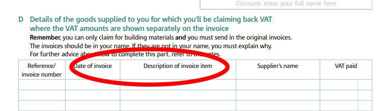

Thedreamer Posted March 22, 2021 Posted March 22, 2021 Just to say from my own experience of recently completed the VAT reclaim. I had just the one rejection and now resubmitted this invoice and will obtain back every penny due. The building merchant did not put sufficient information on a VAT invoice provided. This was for velux windows and was recorded as an individual line 'velux windows' on the invoice but the HMRC wanted to see the individual items listed for each velux window ordered on the invoice. This was oversight by me as I should have gone back to them then, but it was the busy point of the build and I had loads of invoices. They were pretty quick at come back to me when I explained the problem and provided the revised invoice. Just for reference here is what your invoices should show. https://www.gov.uk/vat-record-keeping/vat-invoices 2
