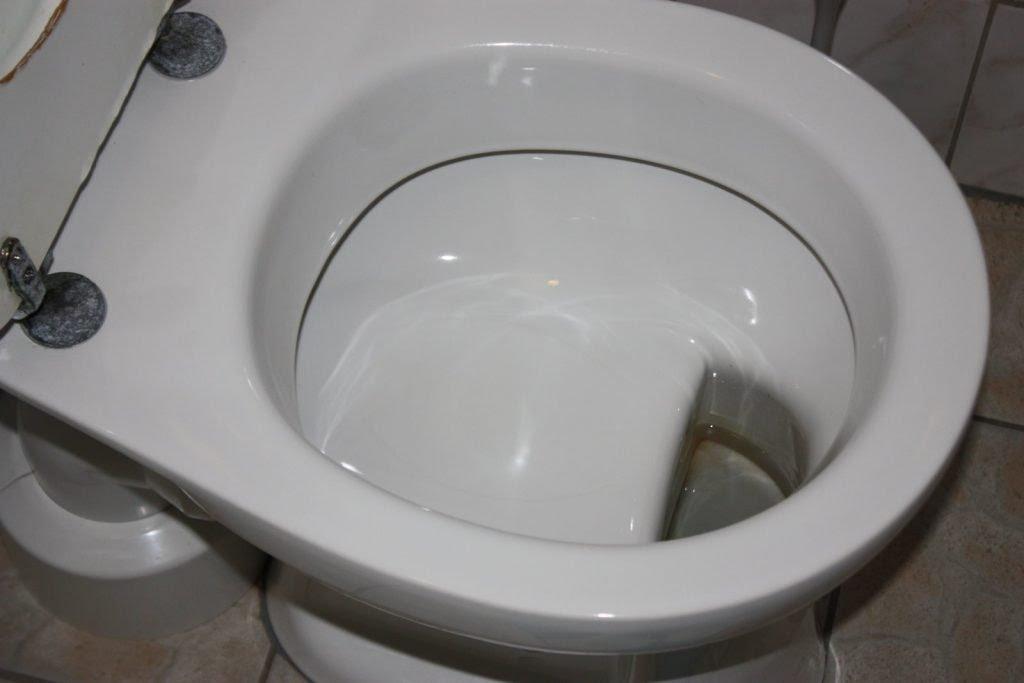

ToughButterCup Posted March 26, 2021 Posted March 26, 2021 Ah toughen up the lotta ya! Go and sit on an old style German crapper. That'll make men out of you.
PeterW Posted March 26, 2021 Posted March 26, 2021 Just now, ToughButterCup said: Ah toughen up the lotta ya! Go and sit on an old style German crapper. That'll make men out of you. Ahhh the lovely “flachten turden inspektion platten” 2
ToughButterCup Posted March 26, 2021 Posted March 26, 2021 And consequently lower bowel cancer rates.... 1

SimonD Posted April 4, 2021 Posted April 4, 2021 On 26/03/2021 at 20:10, ToughButterCup said: Ah toughen up the lotta ya! Go and sit on an old style German crapper. That'll make men out of you. Man, that takes me back. We had those in our house in Switzerland when I was growing up. What really toughened me up was what we had outside the cottage in Sweden. Something looking like this: Shovelling the sh*t every year was something I thankfully managed to avoid! 1

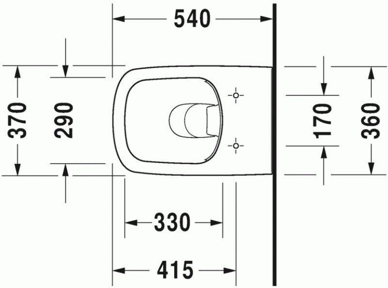

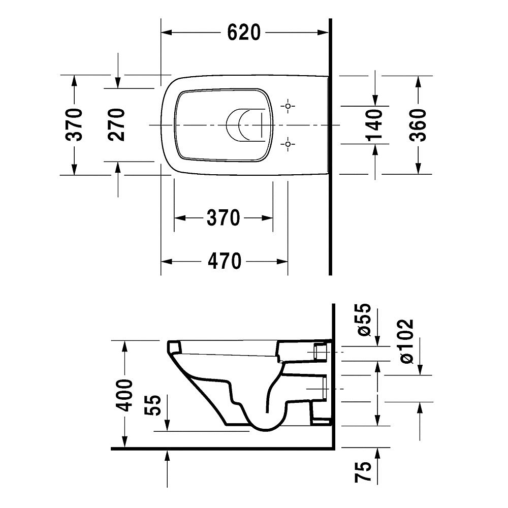

Adsibob Posted May 3, 2021 Author Posted May 3, 2021 So I had decided on the 620mm projection Duravit Durastyle wall hung rimless toilet having finally managed to make my way to the showroom and try it out for size. Very comfy and as reported earlier in the thread, no dangling issues (as measured by my finger!) The only issue is that now that the build is progressing I'm wondering if I have space for it. Duravit also make the same toilet in a shorter 540mm projection. The two toilet diagrams are shown below. Having not tried the 540mm model (they didn't have it in the show room) I'm now wondering whether it will be feel that much smaller. The 80mm difference is partly accounted for by the 45mm difference between the hingepoint of the seat and the rim of the seat, but that doesn't seem so meaningful. Or is it? What projection toilets have you installed in your builds?
