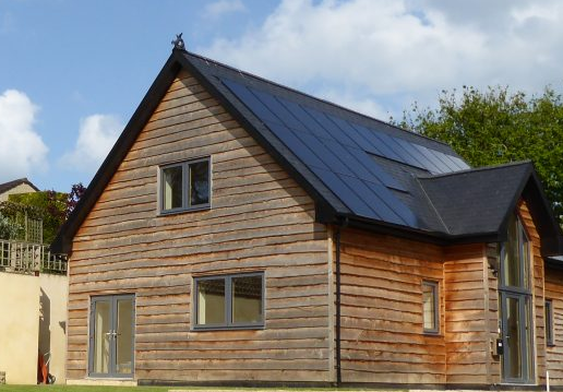

GrantMcscott Posted March 18, 2021 Share Posted March 18, 2021 Hi Is there any way you can hide down pipes? Due to the windows on my house being in the roof and the wall (see pic)it is causing the need to have lots of downpipes for the guttering. If the guttering goes past the window it will be in line with your eye. On the elevation there is actually another set of the windows so 5 in total Is there any clever solutions to solve this. Link to comment Share on other sites More sharing options...
ToughButterCup Posted March 18, 2021 Share Posted March 18, 2021 I take it there is a flat roof above each window? Not sure this is clever: run the gutter across the windows (say the group of three on the RHS) along to the left-most (pair of?) windows and put your downpipe there. This would mean that rainwater disposal drives the window design - not clever. Might a rainwater chain be an idea? Might be clever. If you can't beat it, join it..... make the downpipes fun - interesting The idea is from Germany (sorry you have to get used to that from me ?) Clever but expensive. 2 Link to comment Share on other sites More sharing options...
GrantMcscott Posted March 18, 2021 Author Share Posted March 18, 2021 14 minutes ago, ToughButterCup said: I take it there is a flat roof above each window? No it is a pitched roof. Was thinking about brining the down pipe inside and putting it in the service cavity. Link to comment Share on other sites More sharing options...

Construction Channel Posted March 18, 2021 Share Posted March 18, 2021 My only suggestion would be to create a fake mansard/ tile hung section between the windows so you could bring the gutter line to below the sills. Not sure how good it would look but it would solve the problem. What was the original design to deal with the downpipes? Or is that your last pic with red line.. Link to comment Share on other sites More sharing options...
GrantMcscott Posted March 19, 2021 Author Share Posted March 19, 2021 13 hours ago, Construction Channel said: My only suggestion would be to create a fake mansard/ tile hung section between the windows so you could bring the gutter line to below the sills. Not sure how good it would look but it would solve the problem. What was the original design to deal with the downpipes? Or is that your last pic with red line.. That is the issue there is no design for it it is a miss and know the roof is on it is like a bit of Sh*t what do I do moment. I was thinking that due to the lengths of guttering being in small sections then the area of roof is very small the water is collected from. Due to this the flow rate will be greatly reduced thus I can get away with a smaller drainage pipe. I could connect a 32mm MDPE pipe to the back of the gutter and run it down the cavity or inside the house and out the bottom. This would have no joins in it and if in the house can insulate it so no noise. I could put a mesh at the top to stop it getting blocked. Link to comment Share on other sites More sharing options...

Ferdinand Posted March 19, 2021 Share Posted March 19, 2021 23 hours ago, GrantMcscott said: Hi Is there any way you can hide down pipes? Due to the windows on my house being in the roof and the wall (see pic)it is causing the need to have lots of downpipes for the guttering. If the guttering goes past the window it will be in line with your eye. On the elevation there is actually another set of the windows so 5 in total Is there any clever solutions to solve this. OK. Help me understand. This is a nearly finished self-build with a glitch in the design? Am I correct that the horizontal black lie at the bottom of the roof is a gutter than runs in front of the half-high window frame section? Or is it 2 separate windows with the upper set back? If it is a newbuild, who made the design cockup? Not properly considering drainpipes counts as a cockup. (There may be comeback on an architect, depending.) And am I correct that the entire wall is rough stonework - not just a decorative section? Do you have a photo? Of both problem elevations? I understand that this is both elevations of the house. I have thoughts, but could you just comment on the Qs. Cheers Ferdinand Link to comment Share on other sites More sharing options...
GrantMcscott Posted March 19, 2021 Author Share Posted March 19, 2021 6 minutes ago, Ferdinand said: OK. This is a bastard problem. Help me understand. Is this an old house that is being restored, or a nearly finished self-build with a glitch in the design? Am I correct the area you need to drain here is the entire roof? Am I correct that the horizontal black lie at the bottom of the roof is a gutter? If it is a newbuild, who made the design cockup? Not properly considering drainpipes counts as a cockup. And am I correct that the entire wall is rough stonework - not just a decorative section? Do you have a photo? I understand that this is both elevations of the house. I have thoughts, but could you just comment on the Qs. Cheers Ferdinand Hi Here is a phot of one of the elevations. It is a new build and the black line will be roughly where the gutter will be but not running past the windows. The whole roof will need to be drained by the gutter and the windows have a hidden gutter in them that drains into the main gutter. The walls will be a mix of render in bit and sections of stone. 1 Link to comment Share on other sites More sharing options...

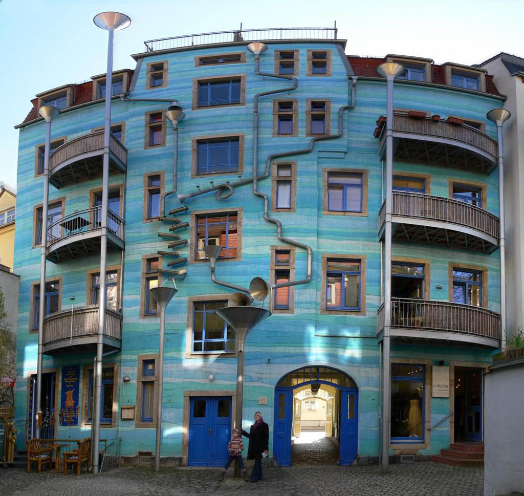

ToughButterCup Posted March 19, 2021 Share Posted March 19, 2021 1 hour ago, Ferdinand said: .... Not properly considering drainpipes counts as a cockup. (There may be comeback on an architect, depending.) ... Oooooofff. ? There isn't much wiggle room on this one is there? I suspect the idea isn't popular, but if you cant work the problem through, work with its weakness. Make rainwater disposal visual fun. 1 Link to comment Share on other sites More sharing options...
Ferdinand Posted March 19, 2021 Share Posted March 19, 2021 3 hours ago, ToughButterCup said: Oooooofff. ? There isn't much wiggle room on this one is there? I suspect the idea isn't popular, but if you cant work the problem through, work with its weakness. Make rainwater disposal visual fun. No, there isn't. BH (or at least my bit of it) is "husk-off". Though I admit I have just come from debating Ursula VDL with certain Brussels based journos who seem to view themselves as (very) amateur press officers for the institution of the EU, and are trying to blame everything on anybody else - specifically us. So it has been robust ?. And that may have stuck to me. Yes, ve can vork it through. F Link to comment Share on other sites More sharing options...

ToughButterCup Posted March 20, 2021 Share Posted March 20, 2021 17 hours ago, Ferdinand said: .... Or you could try that simply with bold copper ... pipes and lay them out to look attractive. .... I'll second that. Trouble is you spend a million dollars to make it look worth half a million dollars. And, in the words of our local friendly Mr Plod " ...make it worth knicking...." 1 Link to comment Share on other sites More sharing options...
