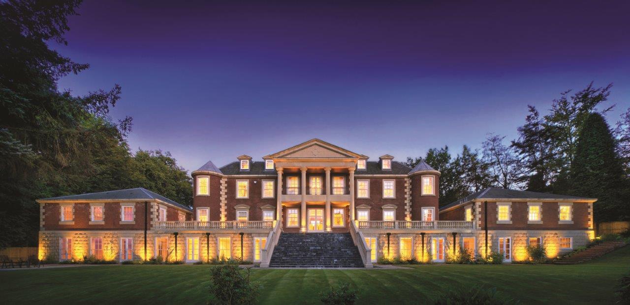

dawsonhousehold Posted April 1, 2021 Author Share Posted April 1, 2021 (edited) Thanks for all the replies, haven’t visited for a little while. The plot prices are what they are here and yes that is the stumbling block as I didn’t want to get too deep in "Again!" I’ve been on the estate 20 years and as the houses come up for sale they are updated or knocked down. The problem with Russel Griffiths comment is that there are lots of million-pound houses here and there are only so many millionaires to buy them! (in the north anyway) I’ve included a picture the most expensive a couple of streets away. A little too overdeveloped for my liking (21,000 Sq ft) Edited April 1, 2021 by dawsonhousehold 1 Link to comment Share on other sites More sharing options...
Blooping Posted June 27, 2021 Share Posted June 27, 2021 On 01/04/2021 at 16:15, dawsonhousehold said: Thanks for all the replies, haven’t visited for a little while. The plot prices are what they are here and yes that is the stumbling block as I didn’t want to get too deep in "Again!" I’ve been on the estate 20 years and as the houses come up for sale they are updated or knocked down. The problem with Russel Griffiths comment is that there are lots of million-pound houses here and there are only so many millionaires to buy them! (in the north anyway) I’ve included a picture the most expensive a couple of streets away. A little too overdeveloped for my liking (21,000 Sq ft) Ah Ponteland, the land of footballers houses! Was it this plot (even though it says 0.6 acres)? https://www.rightmove.co.uk/commercial-property-for-sale/property-79525922.html Link to comment Share on other sites More sharing options...
