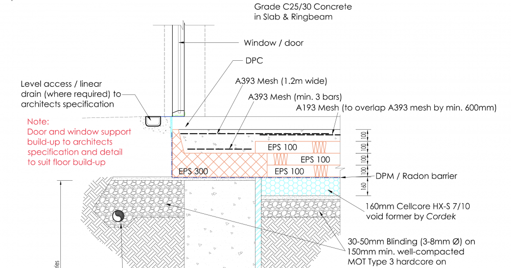

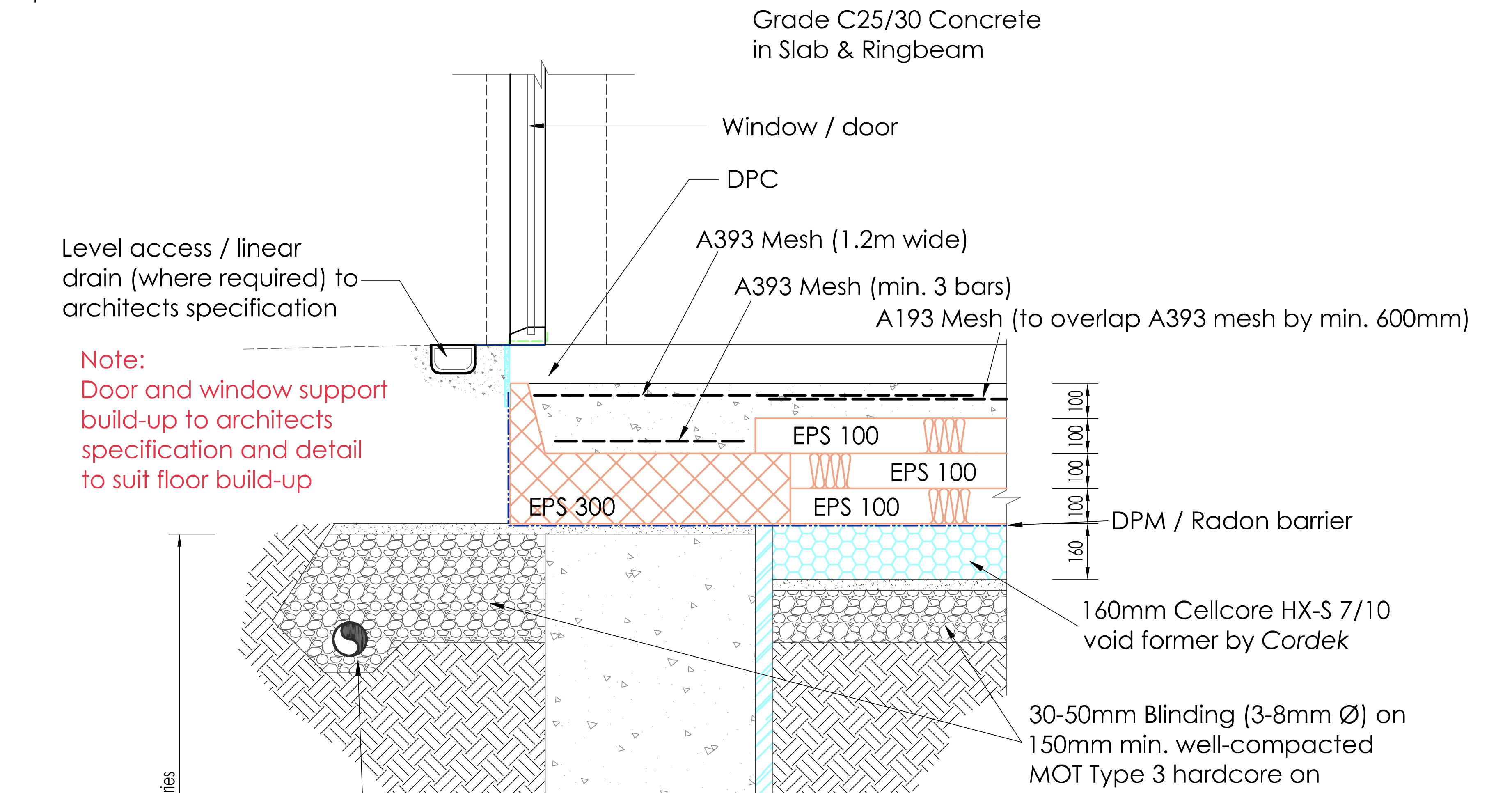

jack Posted February 22, 2021 Share Posted February 22, 2021 Yes, the upstands are above ground level. Here's the equivalent detail for ours - you can see the radon barrier, although its path isn't that clear (sorry for the resolution - this is all we were given): Pretty-well matches what you've posted above, although our DPM/radon barrier as installed continues down the outside edge of the upstand most of the way to the bottom edge, from memory. Link to comment Share on other sites More sharing options...
BotusBuild Posted February 22, 2021 Share Posted February 22, 2021 1 hour ago, AliG said: We have basically this build, but our footpath level is level with the slab. Ali, The Radon/DPM (Damp Proof Membrane) shown in blue on your diagram is, I believe, the DPC (Damp Proof Course) you referred to in your original post Link to comment Share on other sites More sharing options...
jack Posted February 22, 2021 Share Posted February 22, 2021 4 minutes ago, BotusBuild said: The Radon/DPM (Damp Proof Membrane) shown in blue on your diagram is, I believe, the DPC (Damp Proof Course) you referred to in your original post I think that diagram is just one he's found elsewhere, rather than being related to his plans. Link to comment Share on other sites More sharing options...
BotusBuild Posted February 22, 2021 Share Posted February 22, 2021 Agreed Jack. Just pointing out the wonders of acronyms and the different names we have to put up with deciphering ? (and I thought the IT industry was bad!!) 1 Link to comment Share on other sites More sharing options...

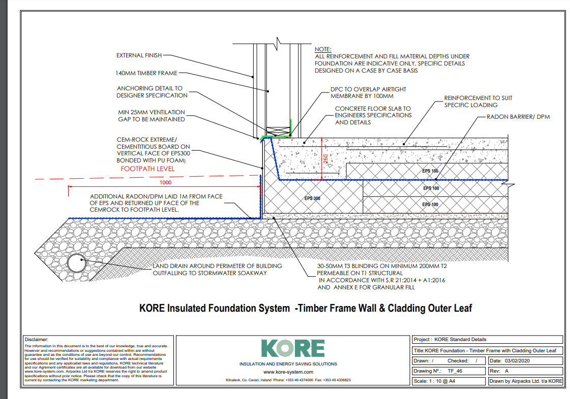

AliG Posted February 22, 2021 Author Share Posted February 22, 2021 Yes, I just found this standard detail from the Kore website, it wasn't shown on our plans. The house will differ in being at ground level, not 150mm above and we aren't sure if that causes an issue as normally a DPC would wrap over a brick in the external skin raising it off the ground, but we don't have a brick course. Link to comment Share on other sites More sharing options...

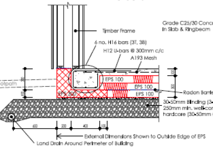

Thorfun Posted February 22, 2021 Share Posted February 22, 2021 does this help? not MBC foundation but designed by Tanners for a Kore system and a level threshold entrance. 1 Link to comment Share on other sites More sharing options...
