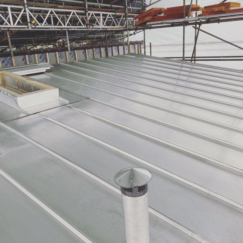

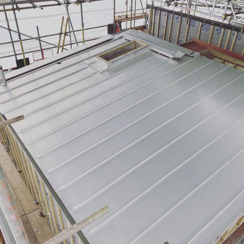

JamesP Posted March 17, 2021 Posted March 17, 2021 (edited) I fitted a warm / vented roof using Tata - Catnic panels. Insulation above the rafters, breather membrane, batten and then panels. Unconventionally I did not use a deck to fully support the panels.Air can circulate directly underneath which I hope also keeps excess heat away from the warm roof. Zinc was not an option due to budget and a task beyond my abilities. Edited March 17, 2021 by JamesP

Bramco Posted March 17, 2021 Posted March 17, 2021 10 minutes ago, JamesP said: I did not use a deck to fully support the panels Interesting - everyone we've spoken to says you need the 18mm ply or OSB. From a lay persons perspective we couldn't really see why this was necessary - unless it is a way of trying to prevent 'oil canning'. If so it's an expensive way of doing it! Simon
Dunny1234 Posted March 17, 2021 Posted March 17, 2021 11 minutes ago, Bramco said: Interesting - everyone we've spoken to says you need the 18mm ply or OSB. From a lay persons perspective we couldn't really see why this was necessary - unless it is a way of trying to prevent 'oil canning'. If so it's an expensive way of doing it! Simon My guys suggesting no ply/osb on top of insulation. Just vapour barrier, zinc and a plastic thermal fixing down into the rafter.
JamesP Posted March 17, 2021 Posted March 17, 2021 25 minutes ago, Bramco said: Interesting - everyone we've spoken to says you need the 18mm ply or OSB. From a lay persons perspective we couldn't really see why this was necessary - unless it is a way of trying to prevent 'oil canning'. If so it's an expensive way of doing it! Simon The Tata / Catnic panels are fairly rigid, oil canning is inevitable but minimal in my experience. I did not want to puncture a solid deck with yet more fixings. The only downside to supporting the panels with just 3 battens is the noise when windy as the panels do ripple. I cannot confirm this but laying panels directly onto a solid structure even with matting must create condensation. However Zinc roofs have been fitted and lasted for decades.

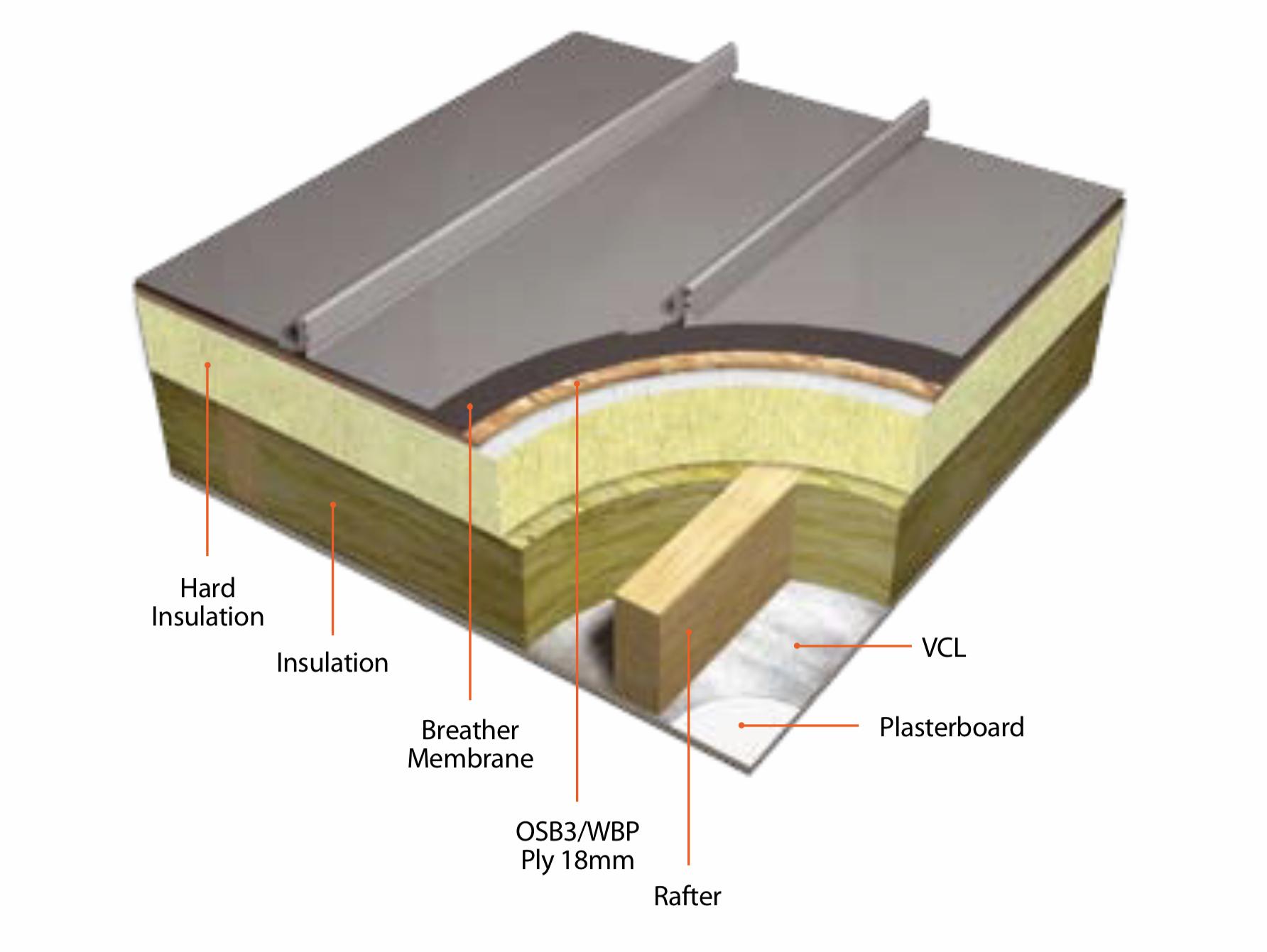

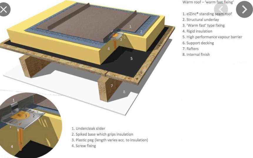

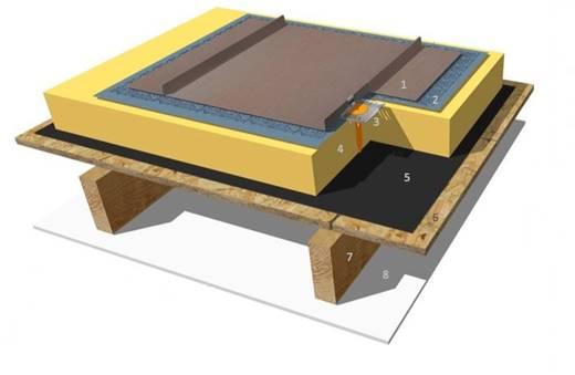

Dunny1234 Posted March 21, 2021 Posted March 21, 2021 Hi all, interesting stuff. Its funny how different metal roof providers give different types of guidance with they’re installation requirements. I think the only difference between to 2 types in the pics, are 1 has an additional layer of ply on top on the pir insulation which the clip are attached too (I can only assume that this reduces any thermal bridging problems with the insulation). And with the other type of standing seam, the roof sheet goes directly onto the insulation, a warm roof plastic fitting go down through the insulation and screws into the ply way below. *obviously, a vapour barrier is installed on both under the metal sheets is there advantages/disadvantages between these systems, or are both okay to use? thanks
Russell griffiths Posted March 21, 2021 Posted March 21, 2021 @Dunny1234, you need to stick to your roof manufacturers approved method if you want a warranty. As to which is best, that’s up to you to decide. You need to do your own research and pick which you think is best. Every manufacturer will say his is the best. 1
Kevin J Posted March 21, 2021 Posted March 21, 2021 @Dunny1234 consider also the cost in your comarison. Clips that attach to a substrate are fixed £69.00 per 1000 and expansion £59.00 per 400 You use a specific arrangement to offer security (fixed) and thermal expansion of the roof. Thermoseam Clips which are supplied as clip with tube to go through the insulation are more expensive. Ball park on average you will use up to 10/m2, soon adds up! You will also need the correct fixing to go down the tube appropriate to the anchoring material as well as a drive bit to insert in the tube. Note: some distributors will charge for the tube and the stainless clip as separate items. The structural reliance of the rigid insulation is paramount for the life of the building. Someone else may need access to the roof area after the metal is installed 1
