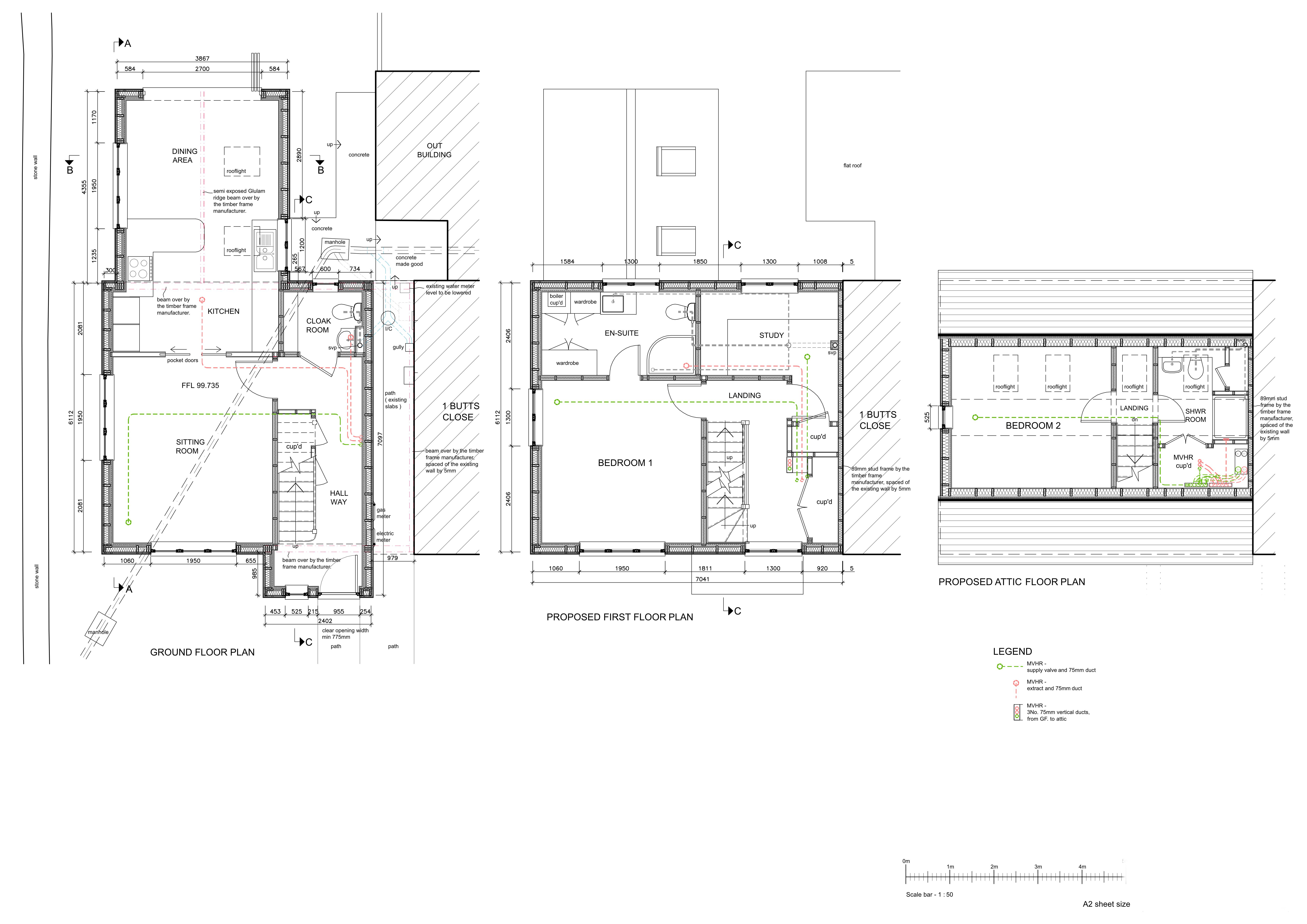

WWilts Posted January 29, 2021 Share Posted January 29, 2021 What would you do? (Jargon used here, but pls don't assume I understand it or know all about these matters) SAP fail mainly due to walls being 0.27 Architect design for cavity walls: Block inner 100mm Celcon Jumbo blok hi strength with thin joint mortar Dritherm 37 insulation 100mm Brick outer 100mm (reconst stone on front elevation) Windows & door double glazed. 2 rooflights, one west facing in entrance porch. Other north facing in attic, mainly to allow light to storage space & allow ventilation/air changes on hot days. SAP consultant suggested increase loft insulation from 300 to 400mm, and use Megaflo cylinder OR combi for hot water. Then if air test set to 4.0, can pass without changing walls What would you do? Context: We are likely to have to move in a few yrs, so cost-effectiveness over a 5 yr horizon is important to us. Both installation and running costs over 5 years. Expense welcome only if it will boost the eventual selling price. Idea so far: Better walls (if planner will permit render, then cavity wall outer leaf Celcon Jumbo blok Solar grade outer leaf with thin joint mortar + monocouche render) Might ease the pressure on air test / boiler spec / thickness of attic insulation (insulation welcome, but freedom to stay with 300mm insulation in parts of attic also desired) You might well spot options to which we are blind Link to comment Share on other sites More sharing options...

PeterW Posted January 29, 2021 Share Posted January 29, 2021 Make the cavity 150mm and use blown beads. 100mm can no longer pass unless you use insulated plasterboard - your architect should know that. Ditch the jumbos with thin joint - they are expensive crap with expensive wall ties and brickies hate them. Go for a standard block and mortar. 2 Link to comment Share on other sites More sharing options...
ProDave Posted January 29, 2021 Share Posted January 29, 2021 And aim for an air test of much better than 4.0. Detail it properly and get a much lower actual air test value. Are you fitting mvhr? What do you want from the house? A really comfortable house that needs very little heating, or as cheap as possible build to just scrape through building regs and have higher heating costs? 1 Link to comment Share on other sites More sharing options...
A_L Posted January 29, 2021 Share Posted January 29, 2021 (edited) 1 hour ago, WWilts said: Dritherm 37 insulation 100mm Changing to Dritherm 32 could make more carbon savings than adding 100mm to loft insulation if walls have greater m2 than roof and improve wall U-value to about 0.24 Edited January 29, 2021 by A_L remove typo 1 Link to comment Share on other sites More sharing options...
Conor Posted January 29, 2021 Share Posted January 29, 2021 (edited) Your architect needs a slap for coming up with such a poorly performing design that isn't even meeting minimum standards. Even though you'll be moving on in a few years, please bear in mind your house will be around for another 100 years or more. You should be aiming to blow through the SAP requirements, not scrape though. As above, make cavities 150mm wide, put in 150mm insulation in the floors, 400mm in the loft and consider higher performing windows and doors. And airtightness, makes a huge difference. It will of course add some cost to your build, but you'll have a much more comfortable house and a better legacy for the future. Edited January 29, 2021 by Conor 3 Link to comment Share on other sites More sharing options...

MikeGrahamT21 Posted January 29, 2021 Share Posted January 29, 2021 Calculations incorrect?? ubakus.com tells me 0.26U with 40 grade wool insulation with 32 grade wool insulation this goes to 0.22U Link to comment Share on other sites More sharing options...

Iceverge Posted January 29, 2021 Share Posted January 29, 2021 (edited) 5 years is a long time and a lot could change by then. In terms of energy saving the lowest hanging fruits to improve on building regs are. 1.Triple Glazing 2. MVHR 3. Airtightness Added insulation is only an incremental gain in comparison. You could probably ditch the rads upstairs too in all but the bathrooms. Edited January 29, 2021 by Iceverge 2 Link to comment Share on other sites More sharing options...

Iceverge Posted January 29, 2021 Share Posted January 29, 2021 Just now, WWilts said: Underfloor heating upstairs? No heating at all upstairs. In a new house you won't need it. 1 Link to comment Share on other sites More sharing options...
ProDave Posted January 29, 2021 Share Posted January 29, 2021 No mention of renewables like solar PV? 1 Link to comment Share on other sites More sharing options...
ProDave Posted January 29, 2021 Share Posted January 29, 2021 Just now, Iceverge said: No heating at all upstairs. In a new house you won't need it. Only if insulated properly and nicely air tight. I suspect this house might want some. 1 Link to comment Share on other sites More sharing options...
