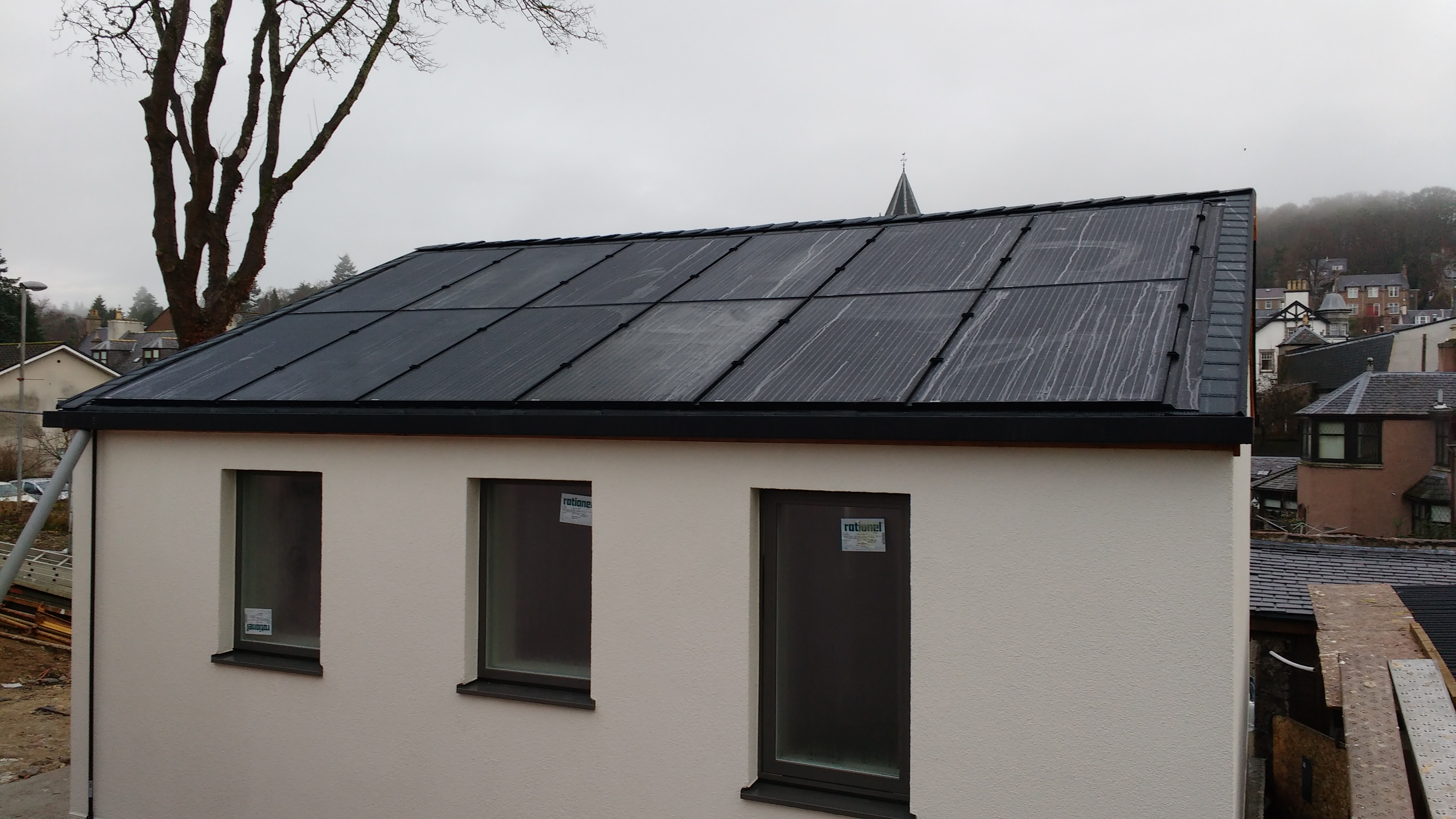

Auchlossen Posted February 7, 2017 Posted February 7, 2017 I have just put in 12x285w panels in-roof, cost of kit = £2874 + vat inc delivery to site My son put the panels on the roof for a modest fee Plus fee to PV installers for wiring and fit application = £950 against which there is saving on roof slates and slater [tho not much saving there, since fiddling around to fit slates on roof beside and above solar panels took as long as slating the north roof. I am sure that it can be done cheaper, but all installers were excellent.

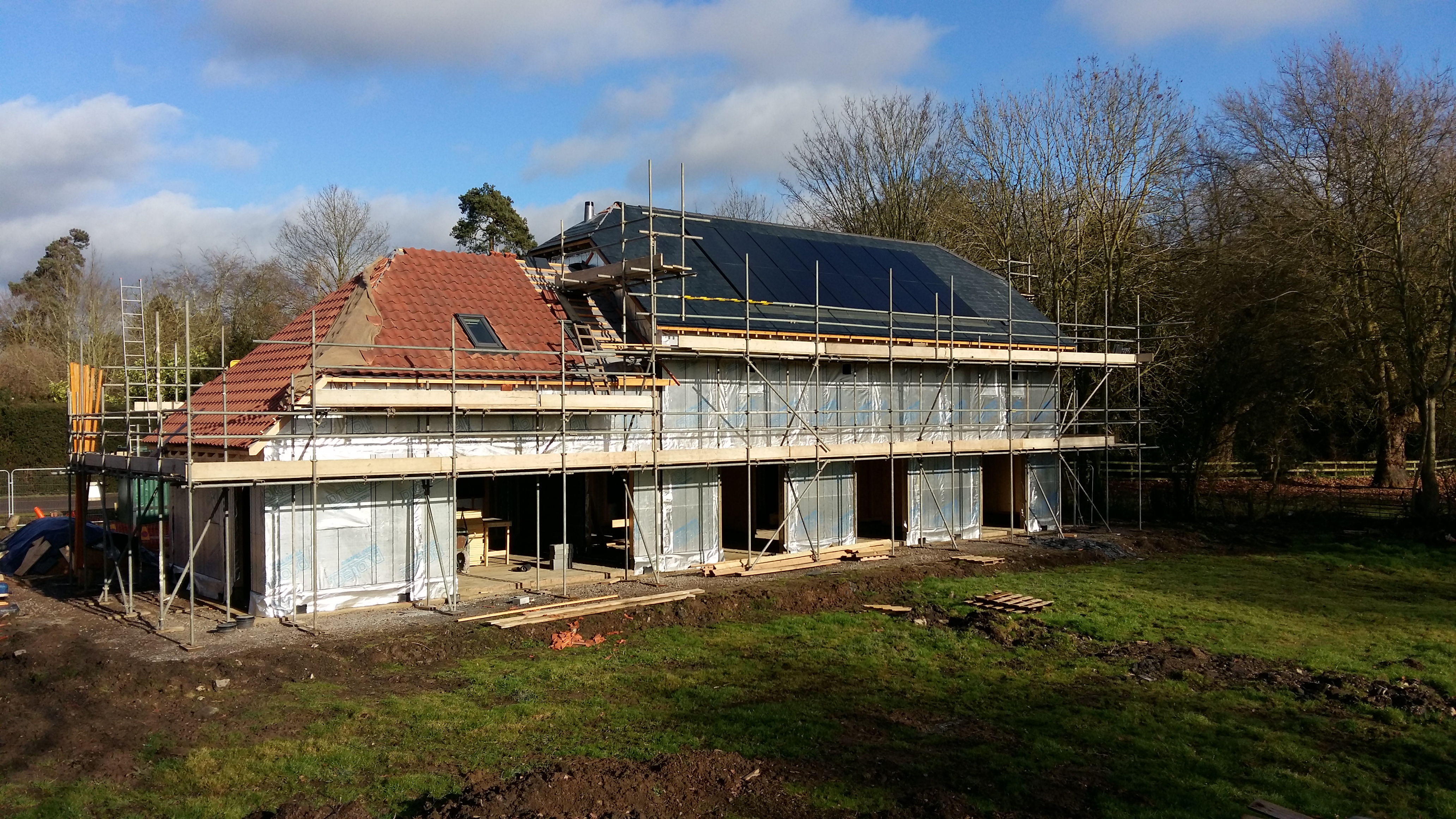

Roundtuit Posted February 8, 2017 Posted February 8, 2017 Hi. For what it's worth, I've just had an integrated 4kw Viridian Clearline Fusion system put in for £5.3k, all in. I reckon I could have done it cheaper, but the installers are linked to the roofing company, so it took some of the hassle and risk out of it for me. It also saved 32 sq m of slating to off-set the cost. Probably also worth mentioning that the local conservation officer has taken a particular interest in this site, so aesthetics were quite high up the priority list... 2

Rossek9 Posted February 9, 2017 Author Posted February 9, 2017 £5.3k for a 4kw in roof system doesn't seem too bad. Works out at £1350 per kw. Would be interested to hear company as well at these prices. This is an mcs system registered for fit?
Roundtuit Posted February 9, 2017 Posted February 9, 2017 Yes - mcs registered, from Manor Solar based near Peterborough. As the roof is being done by their sister company, it may be that there has been some off-setting of costs that isn't fully visible, but the total cost of the job isn't a million miles out. To be honest, it hasn't all been plain sailing (pm if you want details), but I can't fault the quality of the roof installation ( and I've crawled all over it!)
