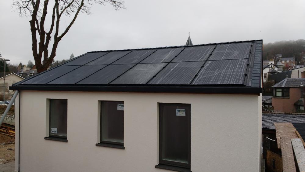

April 8, 20179 yr Author Just an update on this. Ive just received my first quote back for an in-roof 3kw system for £4.2k. This is for a mcs system registered for fit so doesn't seem too bad. This price didn't include vat..........should this be zero rated?
April 8, 20179 yr That price seems reasonable and yes, it should be zero rated for a new build, as it's supply and fit. Our PV supplier wasn't aware that new builds should be zero rated, so as well as send them a chit with the planning details etc on, I also emailed them links to the HMRC guidance.

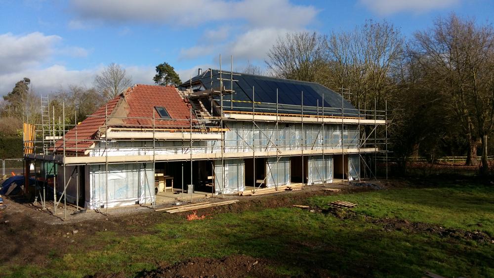

April 8, 20179 yr We bought our PV array for the outbuildings from Wagner Renewables http://wagnersolarshop.com/ on recommendation from someone on ebuild. They put together a complete kit, even down to the labels to make the whole thing compliant. At the time they were very competitive price wise (after a haggle).
April 8, 20179 yr 2 hours ago, Barney12 said: We bought our PV array for the outbuildings from Wagner Renewables http://wagnersolarshop.com/ on recommendation from someone on ebuild. They put together a complete kit, even down to the labels to make the whole thing compliant. At the time they were very competitive price wise (after a haggle). Think that may have been me, but not sure ..!! Wagners have priced for me in the past and as you say they are very competitive on pricing especially if you will take the panels they have in stock. They do the whole in roof system too

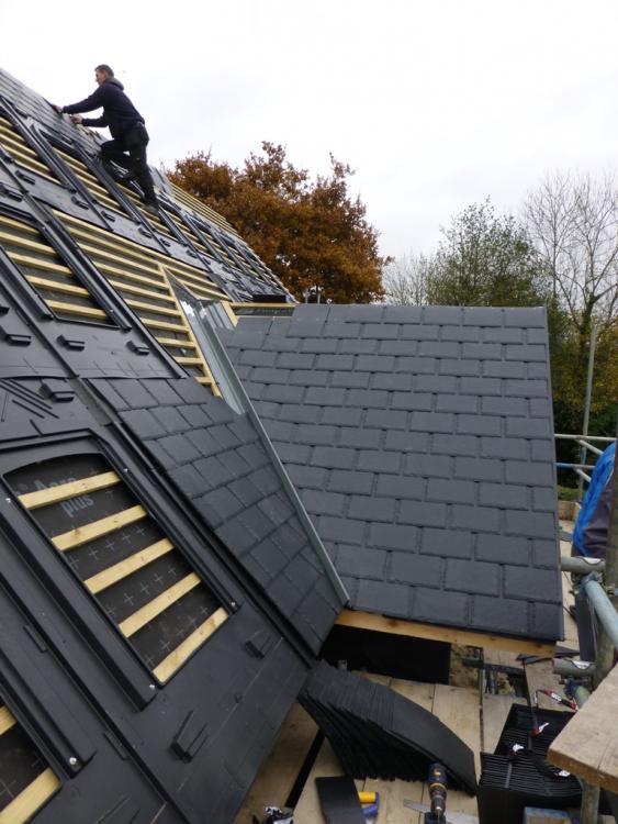

April 9, 20179 yr 30 minutes ago, Steptoe said: Just to add, has anyone considered the degradation of the efficiency of the panels,? Obviously an in roof system will be a lot more expensive to replace than an on roof system. That doesn't seem right to me. The panels simply sit in the roof trays, a few clamps to unbolt and they're out. Arguably they are as simple to remove and replace than an "on" roof system. Plus you don't get the very widely reported issues of leaks due to penetrations in the roof tiles/slates caused by on roof systems.
April 9, 20179 yr 46 minutes ago, Steptoe said: Just to add, has anyone considered the degradation of the efficiency of the panels,? Obviously an in roof system will be a lot more expensive to replace than an on roof system. In my professional opinion, if your payback is >10years, then it's not worthwhile, any solar PV system i have installed has generally a payback of 6-7years max to be viable, otherwise it's just not worth it when maintenance costs are taken into account. I have degradation at about .5% per year according to research. I also think I have a guarantee, which may expire with the company and be futile. But I also have Solaredge which should help if a panel dies (though I could be misunderstanding and would not be surprised if I was). But just as I was about to place the final order I rang up and asked for a couple of spare panels and Solaredge modules, which they just gave me as a clinch the order freebie. I think the idea came from a Jeremy. If I was doing a normal install I think one spare panel might be realistic - my install has 35 panels. F Edited April 9, 20179 yr by Ferdinand
April 9, 20179 yr 37 minutes ago, Barney12 said: That doesn't seem right to me. The panels simply sit in the roof trays, a few clamps to unbolt and they're out. Arguably they are as simple to remove and replace than an "on" roof system. Plus you don't get the very widely reported issues of leaks due to penetrations in the roof tiles/slates caused by on roof systems. It may seem that way in principle, But getting the exact same panel in 5 (or 10) years time may be an issue, and getting it made water tight, well, let's not even go there.
April 9, 20179 yr 55 minutes ago, Steptoe said: It may seem that way in principle, But getting the exact same panel in 5 (or 10) years time may be an issue, and getting it made water tight, well, let's not even go there. Sorry im not following you? I accept your point re the sizes of replacement panels but what do you mean by watertight? The GSE system is very good and follows almost an identical flashing system to a velux roof window.
