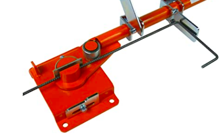

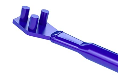

BotusBuild Posted January 20, 2021 Posted January 20, 2021 Anyone done it? What did you use? FYI - I'm DIY'ing as much of the build as possible to minimize costs I will be needing 10's of L shaped pieces of rebar (all about 2m long) as part of the build. I figure there must be a straight forward method of making 90 degree bends and have come up with: 1. hydraulic benders (expensive bits of kit) 2. manual benders (two arms hinged together that you bolt to a large piece of wood) 3. As above but also calls itself a pipe bender (so I am a bit dubious) 4. A bar with 3 prongs at the end (a hickey bar I think its called) - vary in price from £30 upwards 5. One of these (this one up to 14mm rebar) for about £70-80 Then I saw this Youtube video (skip first 15s) - brilliant. Now searching for a "forged eybolt"
