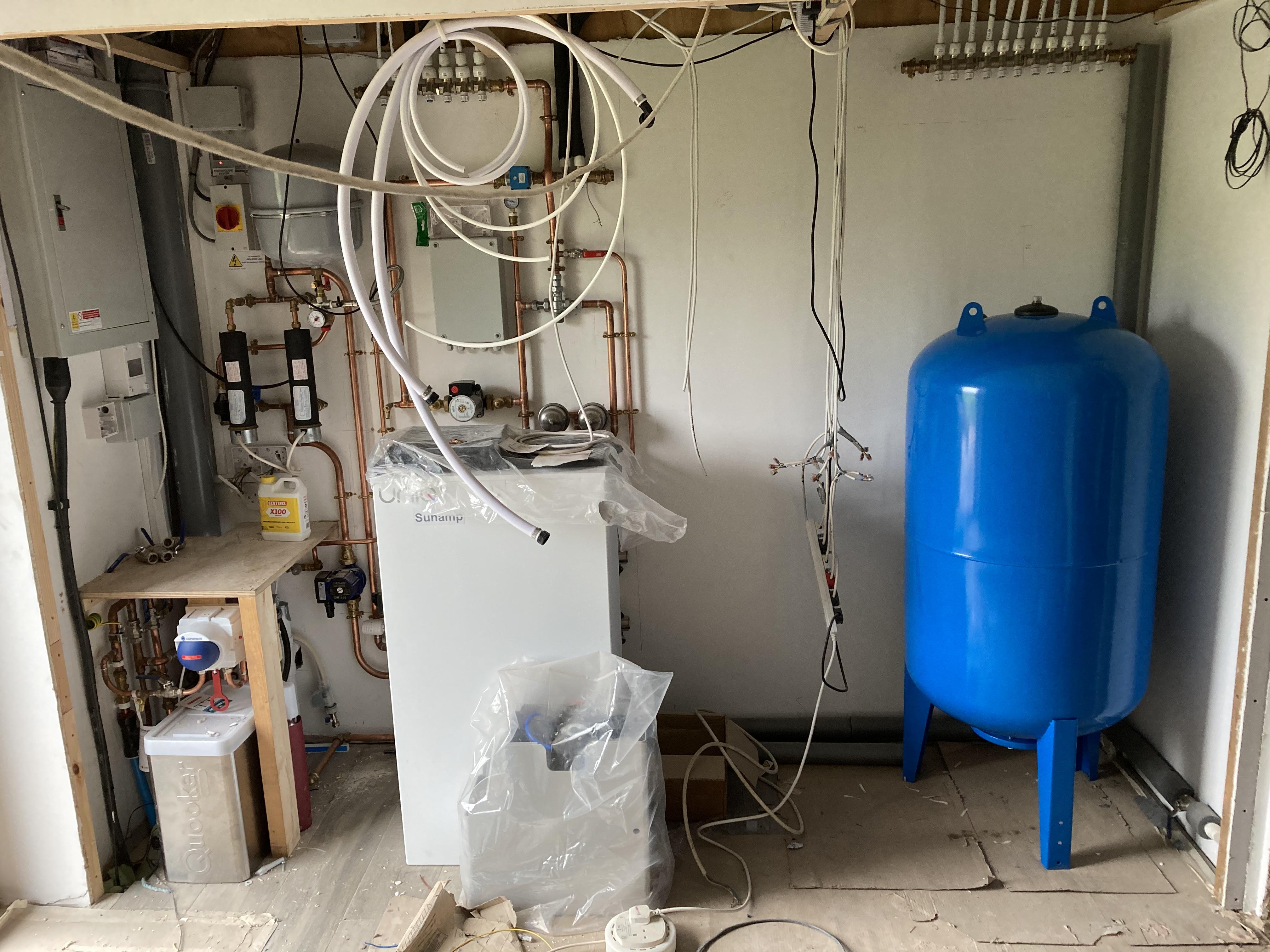

Russdl Posted January 9, 2021 Posted January 9, 2021 @dnoble I’m no plumber, though I suspect I’m going to have to learn fast. This is our set up, sadly still not up and running after many months so I can’t comment on its efficiency or otherwise. The Willis heaters are on the right of the picture with a grey buffer (or is it expansion?) tank above it. The UFH manifolds are hidden behind the non commissioned sunamp.

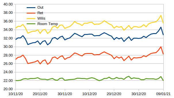

TerryE Posted January 9, 2021 Posted January 9, 2021 (edited) Yup, we have a stone-clad 3 storey MBC TF house with UFH in the groundfloor slab. This UFH is heated by a single Willis heater. Though typically Dec -> Feb or thereabouts I also have a small electric oil-filled heater in an office that also dumps some kWh into the first floor during E7. The single Willis could do everything, but using the heater means that we do most of the heating on E7. The house stays at ~22.3 °C with maybe a ½-1°C ripple over the day. We've also got the ducting in place for an external ASHP, but after over 2 years living in the house, I haven't bothered to buy and to install one. It might save maybe £4-500 p.a. on electricity charges, but then I've got the purchase and installation costs to amortise and this only makes economic sense if I do the work. If I get an installer to do it, then I won't even recover the costs over the expected lifetime of the ASHP, and I would also need to consider an annual maintenance contract. Nope, I think that "keep it simple, stupid" is the best option for us. BTW, no buffer tank. No extra pump. The slab is the buffer, all 27 tonnes of it. The UFH manifold does include a TMV but this is because it was std in the Wunda kit. It is always set to open so the single pump will always cycle the water through the UFH loops (which are configured as a single zone) and the Willis. Each night at midnight my NodeRED control system calculates the heating estimate based on the forecast temp for the next 24 hours and the delta between the actual average house temp for the previous day and the set point (22.3). This number is then used to plan the heating profile for the Willis the next day. I don't really get involved in the day-to-day control; the system just does its thing. Edited January 9, 2021 by TerryE 5

TerryE Posted January 9, 2021 Posted January 9, 2021 2 hours ago, dnoble said: I think just a timer so it comes on for 6 hours overnight would be as much control/monitoring I’d need I personally think that just using a timer could be a bit problematic. Read my blog posts on how I set my system up. I use a Raspberry Pi based system with 4 solid state relays (SSRs) switching the 2 × SunAmps, the circulating pump and the Willis. I take a lot of temperatures and a met-office feed to drive the calculation of how many minutes of heat I need each day. This might seem complicated, but not for me: I have been programming for over 50 years and helped develop some real control systems in my time. This approach for me is straightforwad and cheap. I don't say that a simple timer based system couldn't be made to work satisfactorily, but more that I simply haven't done this so I don't know. However if you are going this route then IMO you will need to limit the out temperature of the water going into the slab to no more than, say, 35 or 40 °C by trimming the thermal cut-out on the Willis heaters or having a separate on on the manifold out. Just for interest here are the peak out, return and Willis temperatures as well as the average ground floor hall temp for the last couple of months. The average outside temp can shift from 10°C to 2°C in a day or two and this has a big impact on the daily heat losses and therefore how much you need to add back in to keep the house temperature stable.

TerryE Posted January 9, 2021 Posted January 9, 2021 (edited) 4 hours ago, joe90 said: @Jeremy Harris built his own programming a bit like @TerryE but stopped using it in favour of a simple room stat which he found worked better ( I know zilch about programming ?). Actually our approaches were different. Jeremy used a buffer tank and attempted to micro-control the UFH circulation temperature. My program just does some calcs every midnight to work out, say: tomorrow I'll need 20 kWh of heat going into the slab. As much heat as possible is dumped in during the E7 window and the rest in short bursts each hour once the hall temp falls below 22 °C. If in reality I needed 25 kWh then no big deal: the house temperature fails by maybe 0.1 °C, and because I have a delta temperature feed forward compensation, the system will adjust for this and put in a bit more the next day to compensate. Using a fixed time each night will probably work so long as the flow temp into slab is max limited (and yes this is to avoid over stressing the system). However you will need to do a similar compensation manually: what is the temperature forecast over then next few days; is the house slowly heating up or or cooling down and adjust the timer setting accordingly. A small hassle every couple of days, that I don't have because my calculation is automated. Edited January 9, 2021 by TerryE

dnoble Posted February 3, 2021 Author Posted February 3, 2021 Thanks for input everyone. I’ve got it up and running with a Willis heater off amazon (labelled “Tesla” rather unexpectedly) and a cheap mechanical timer. The manifold + pump was the main outlay around £400. It took about 3 days continuous running the get the slab up from 18 to 25deg. Now I’m running it only from 12.30 at night till 7.30am when I get cheapo electric. The floor doesn’t feel “warm” but it no longer sucks the heat from your body when you walk on it and everyone’s stopped moaning. The house feels remarkable warmer! Temp is hanging around 20deg. Here’s a pic. All the gubbins is under the counter in the utility room next to the Sunamp 4 1
