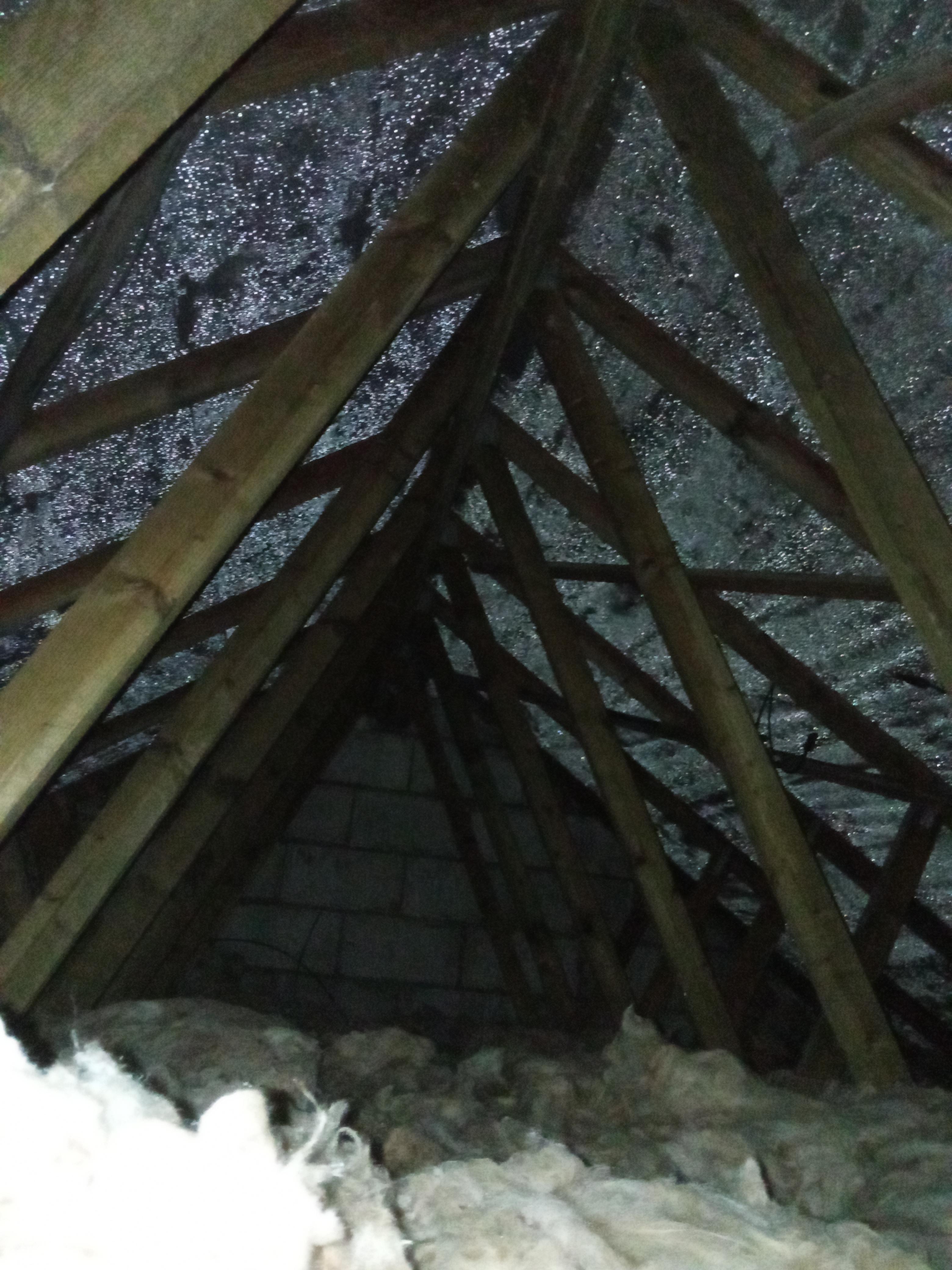

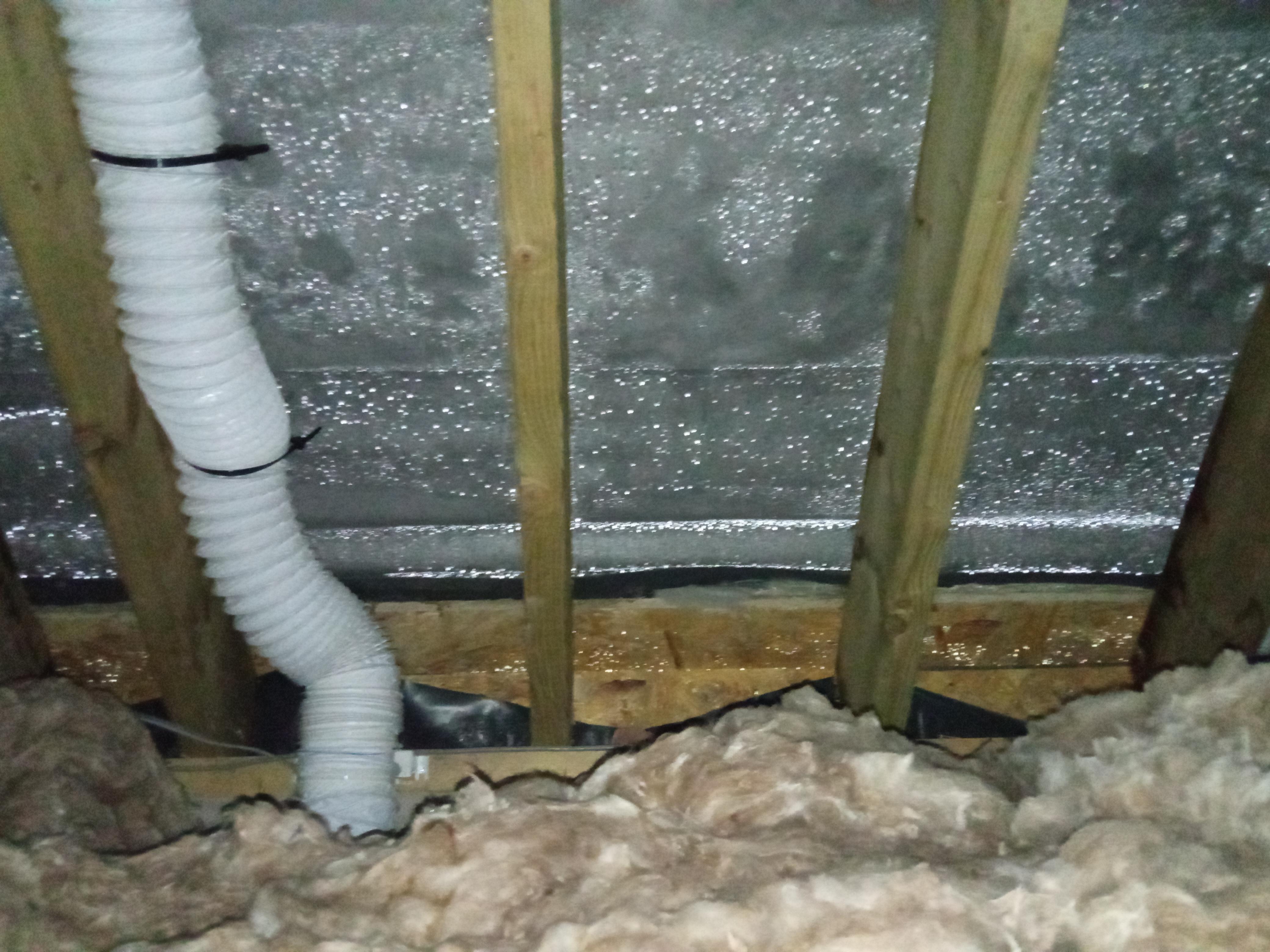

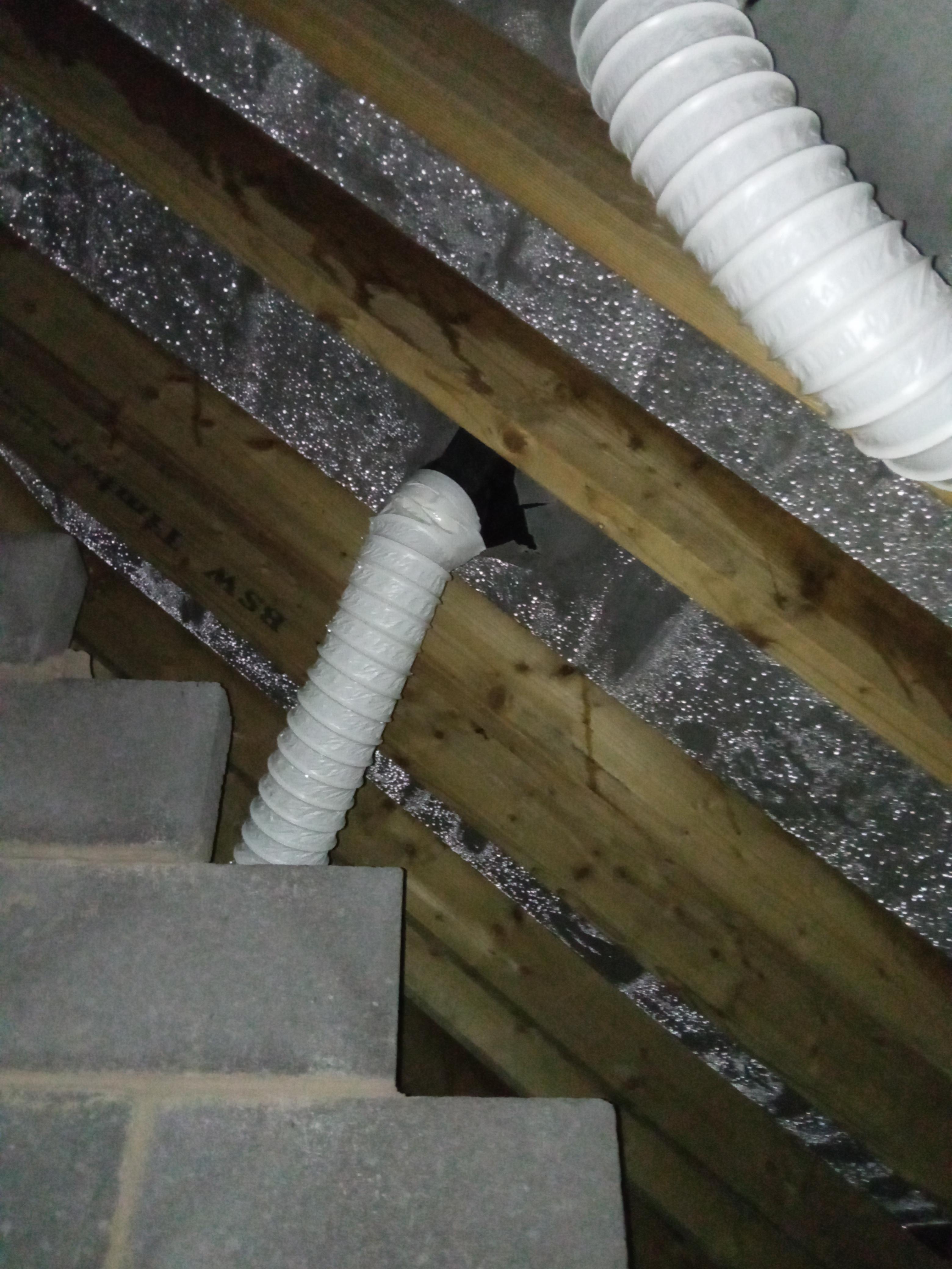

canalsiderenovation Posted January 3, 2021 Share Posted January 3, 2021 (edited) Ok, I don't know if this is right but we went up the bungalow loft with a view to putting the Xmas decorations up and it's looking pretty wet on the roof and is dripping a bit in that the insulation is a bit damp. Should it be like this? We have already got one very long snagging list gone to the builder already and I want to check if this is something else we should be mentioning or not so if I'm making a mountain out of a molehill please tell me! And no we don't have snow on our roof currently. We still have bits of cladding needing to be sorted but that's on the pitched but with no loft and I don't want to create vents or gaps because we always seem to be a magnet for wasps and bluetits nesting. We already caught one trying to nest in not yet fitted hole to the utility extractor! We had our EPC done a few weeks ago and they didn't make any suggestions on loft insulation. There are in two different areas of the loft as you will recall we almost have two pitched roof areas and then the flat roof. The first pic is above our bedroom/dressing room which have in roof solar panels. This sort is above a bathroom. IMG_20210103_135015.jpg Edited January 3, 2021 by canalsiderenovation Link to comment Share on other sites More sharing options...

joe90 Posted January 3, 2021 Share Posted January 3, 2021 (edited) Heat from your house is getting into the loft by the sounds of it and the moisture is condensing on the cold roofing felt, the loft should have adequate ventilation (from outside) to remove any moisture that is there. I have come across loads of lofts where the insulation is sodden and the felt running with water. Definitely ask your builder why this is happening (then post that here so we can see if it’s BS ?♂️.) Edited January 3, 2021 by joe90 Link to comment Share on other sites More sharing options...

Onoff Posted January 3, 2021 Share Posted January 3, 2021 If up in the loft you should be able to push the insulation aside and see the vapour barrier atop the plasterboard. This is the concept the green membrane atop the plasterboard. Viewed from up in the loft where there's no insulation you see the green vcl that's above the plasterboard. Tbh I've punctured my vcl in so many places with speakers and lights etc I need to make good. Link to comment Share on other sites More sharing options...
Onoff Posted January 3, 2021 Share Posted January 3, 2021 2 hours ago, canalsiderenovation said: IMG_20210103_135015.jpg 0 B · 1 download Are those roof timbers wet? Link to comment Share on other sites More sharing options...
canalsiderenovation Posted January 3, 2021 Author Share Posted January 3, 2021 (edited) 53 minutes ago, Onoff said: Are those roof timbers wet? Yes in one of those pictures. I've emailed the builder so I'm sure we will have a response this week. He's coming tomorrow. Edited January 3, 2021 by canalsiderenovation Link to comment Share on other sites More sharing options...

Mr Punter Posted January 3, 2021 Share Posted January 3, 2021 2 minutes ago, joe90 said: But this should be under the vapour barrier ?. Should be but it is not a vapour barrier. If it exists it is a vapour control layer at best. Probably loft hatch, pipes, wires and ducts penetrating. VCL is probably not contiguous with the outer leaf. The roof needs low and high level ventilation. Soffit and ridge. 1 Link to comment Share on other sites More sharing options...

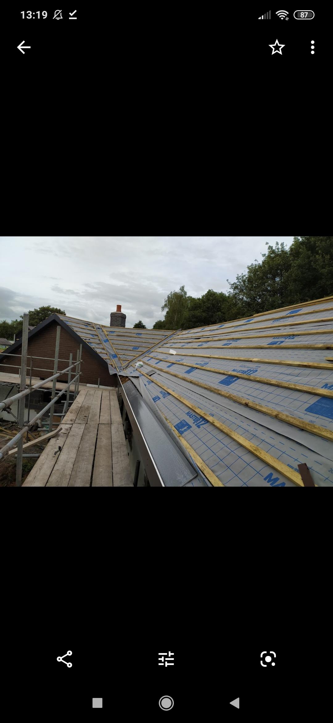

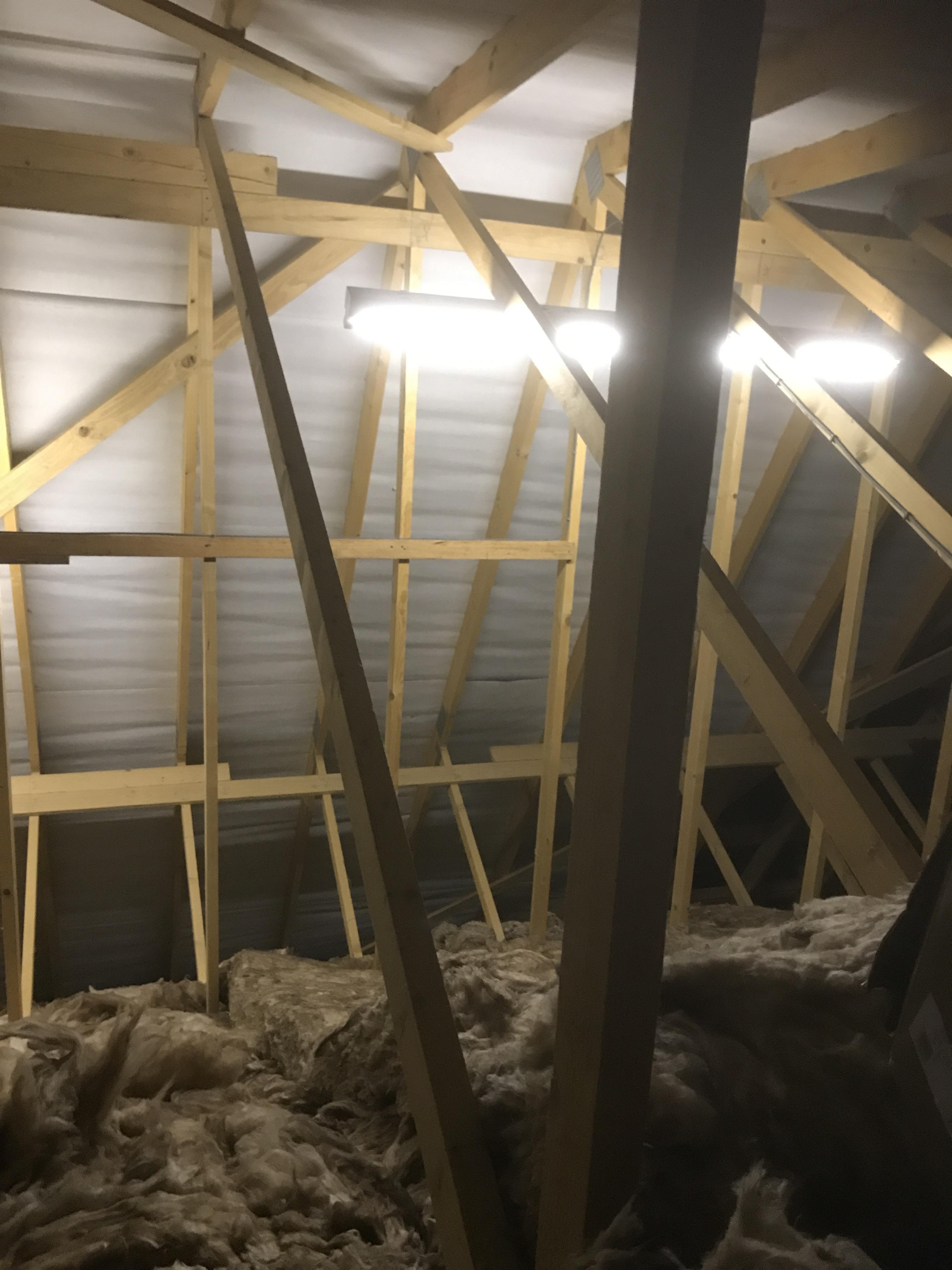

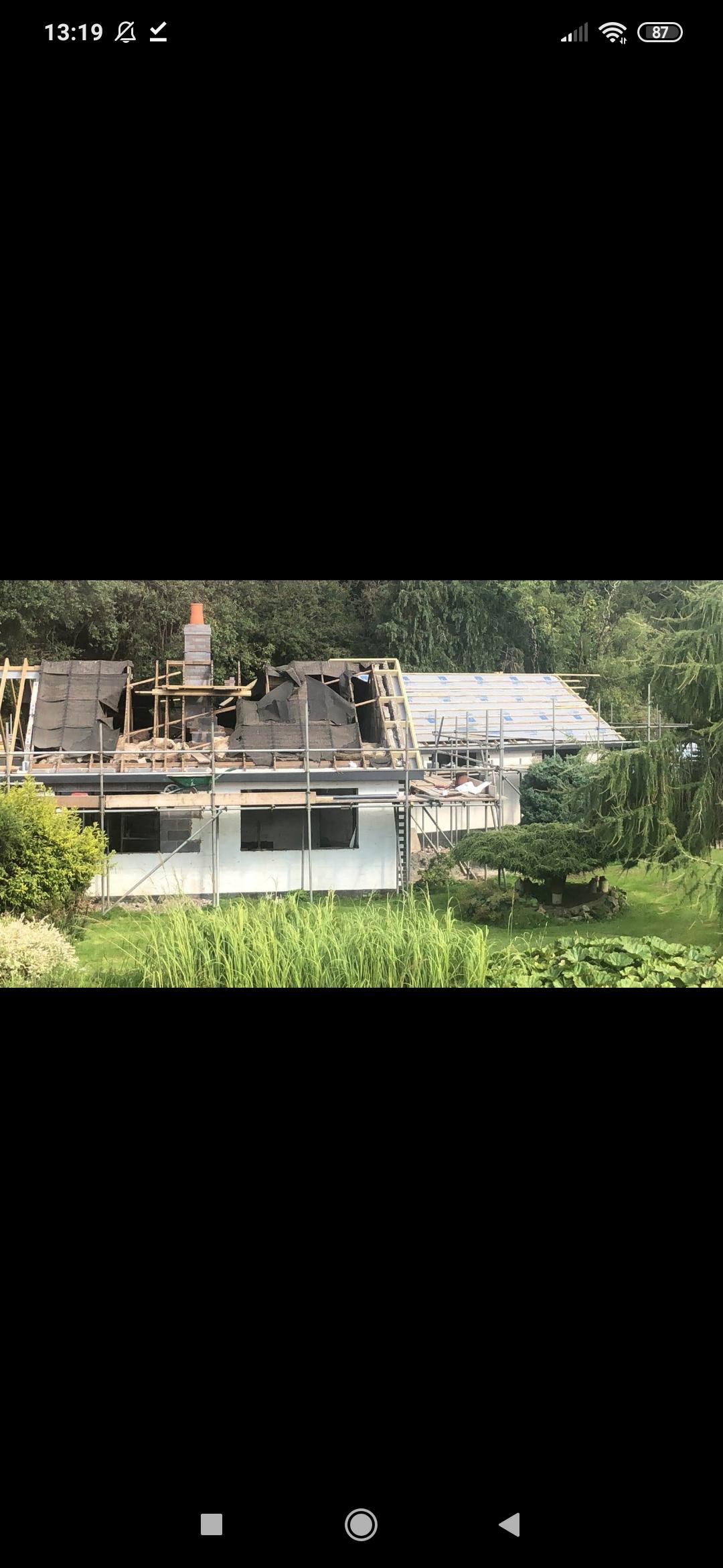

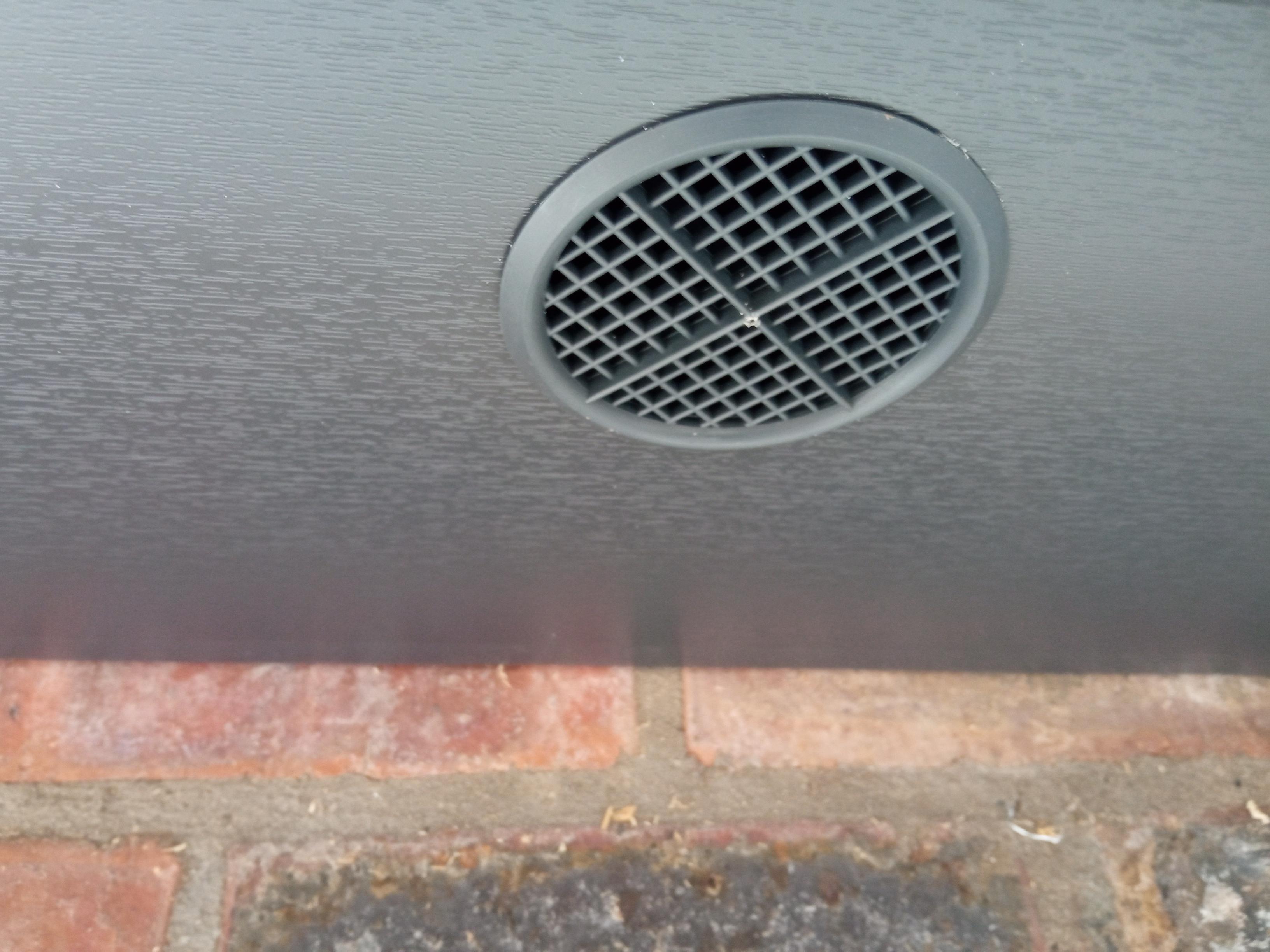

canalsiderenovation Posted January 4, 2021 Author Share Posted January 4, 2021 Ok so there is not a vapour barrier as this was not specified, only for the extension for the gym which we didn't end up having. The parts we have condensation are ultimately what was existing but we had the roof tiles, felt, ceilings etc replaced. There is ridge ventilation and he is going to check all the insulation and look at putting in some fascias/soffit vents and is addressing this urgently. I did find some pics of work in progress. Link to comment Share on other sites More sharing options...
Mr Punter Posted January 4, 2021 Share Posted January 4, 2021 (edited) You need the low level as well. It could be the over fascia type or soffit. You should be able to feel cold air coming in. Make sure the air path is not blocked by the insulation. Having almost no wind does not help. Try hanging out some wet washing in the current weather and you can see that evaporation does not happen quickly. Edited January 4, 2021 by Mr Punter Link to comment Share on other sites More sharing options...
canalsiderenovation Posted January 4, 2021 Author Share Posted January 4, 2021 6 minutes ago, Mr Punter said: You need the low level as well. It could be the over fascia type or soffit. You should be able to feel cold air coming in. Make sure the air path is not blocked by the insulation. Having almost no wind does not help. Try hanging out some wet washing in the current weather and you can see that evaporation does not happen quickly. Yes he is going to check all of this Thursday, Friday and Monday and is concerned so I'm sure it will be put right. We have very little wind here as the old railway embankment keeps us very sheltered. Link to comment Share on other sites More sharing options...

canalsiderenovation Posted January 17, 2021 Author Share Posted January 17, 2021 So we raised this with the builder and some of these vent things were put in the fascias pretty much a couple of days after this post. Not seen anyone since due to Covid and I've just been up the loft and it's pretty much the same as it was in the first pic with condensation, so around a week ago? Should these have had some impact by now? Link to comment Share on other sites More sharing options...
