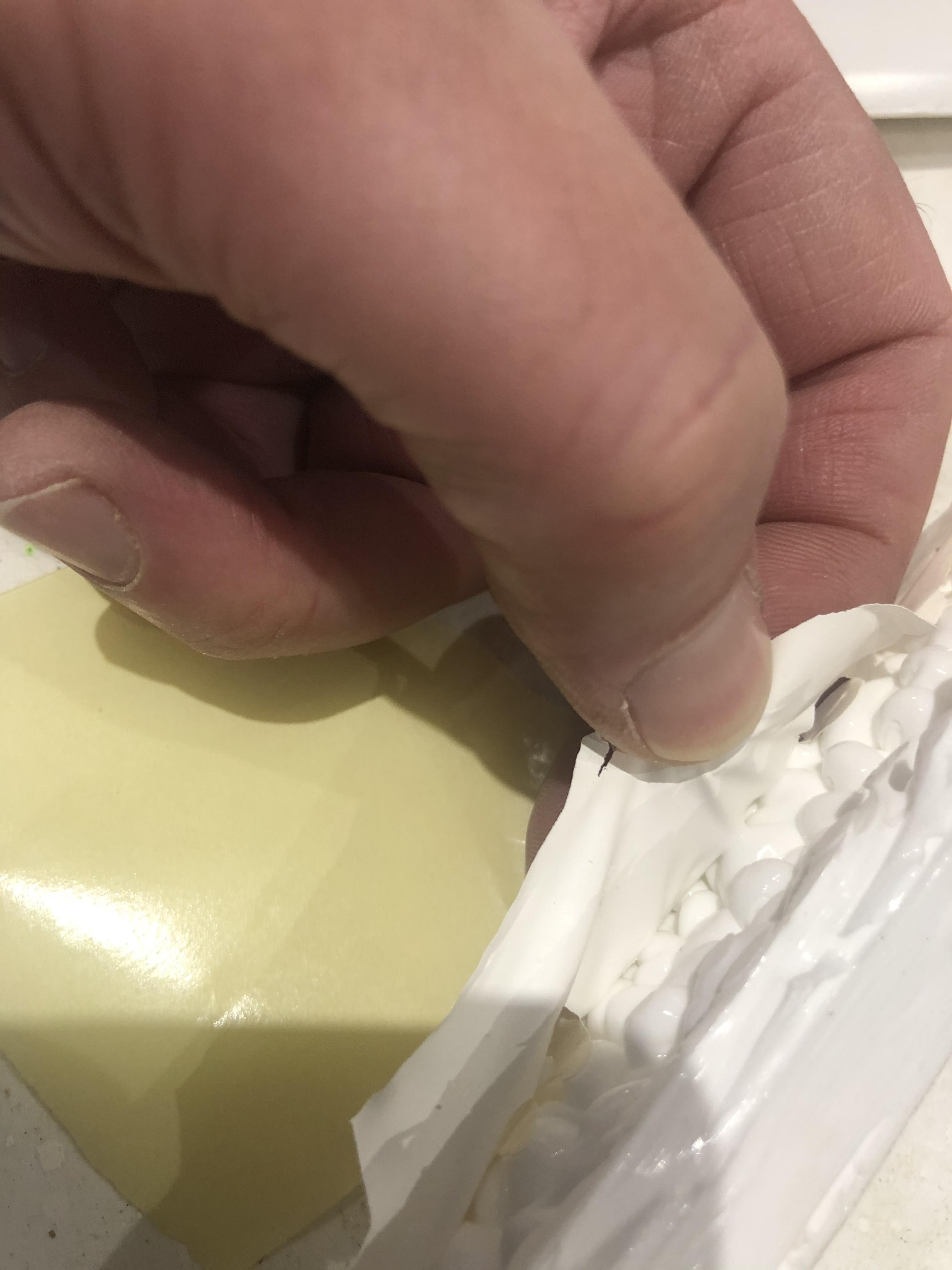

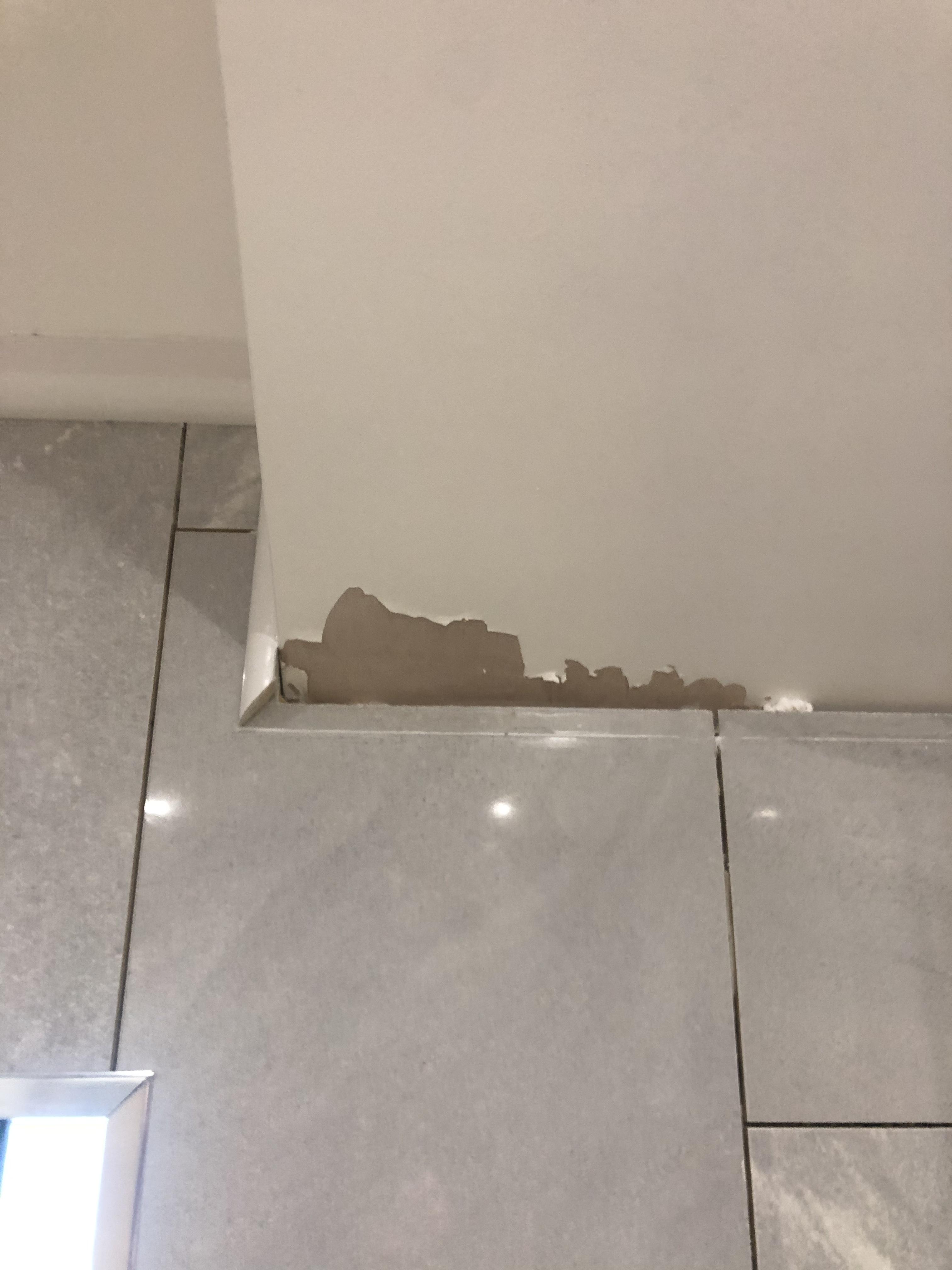

Pocster Posted December 14, 2020 Posted December 14, 2020 I was so careful had to remove some beading but took the paint off ? This was sprayed on . So what’s the best way to ‘fix’ this - so it looks perfect again. ? Worried if I brush or roller first will look wrong . PVA the edges of the torn paint layer down first ?? grrrrrrr 1

joe90 Posted December 14, 2020 Posted December 14, 2020 Sand, paint, sand paint, repeat with a fine roller (or cover your walk on glazing).?
Pocster Posted December 14, 2020 Author Posted December 14, 2020 41 minutes ago, joe90 said: Sand, paint, sand paint, repeat with a fine roller (or cover your walk on glazing).? Sand ? . You mean the paint edging ? . Shouldn’t I just stick that down ??

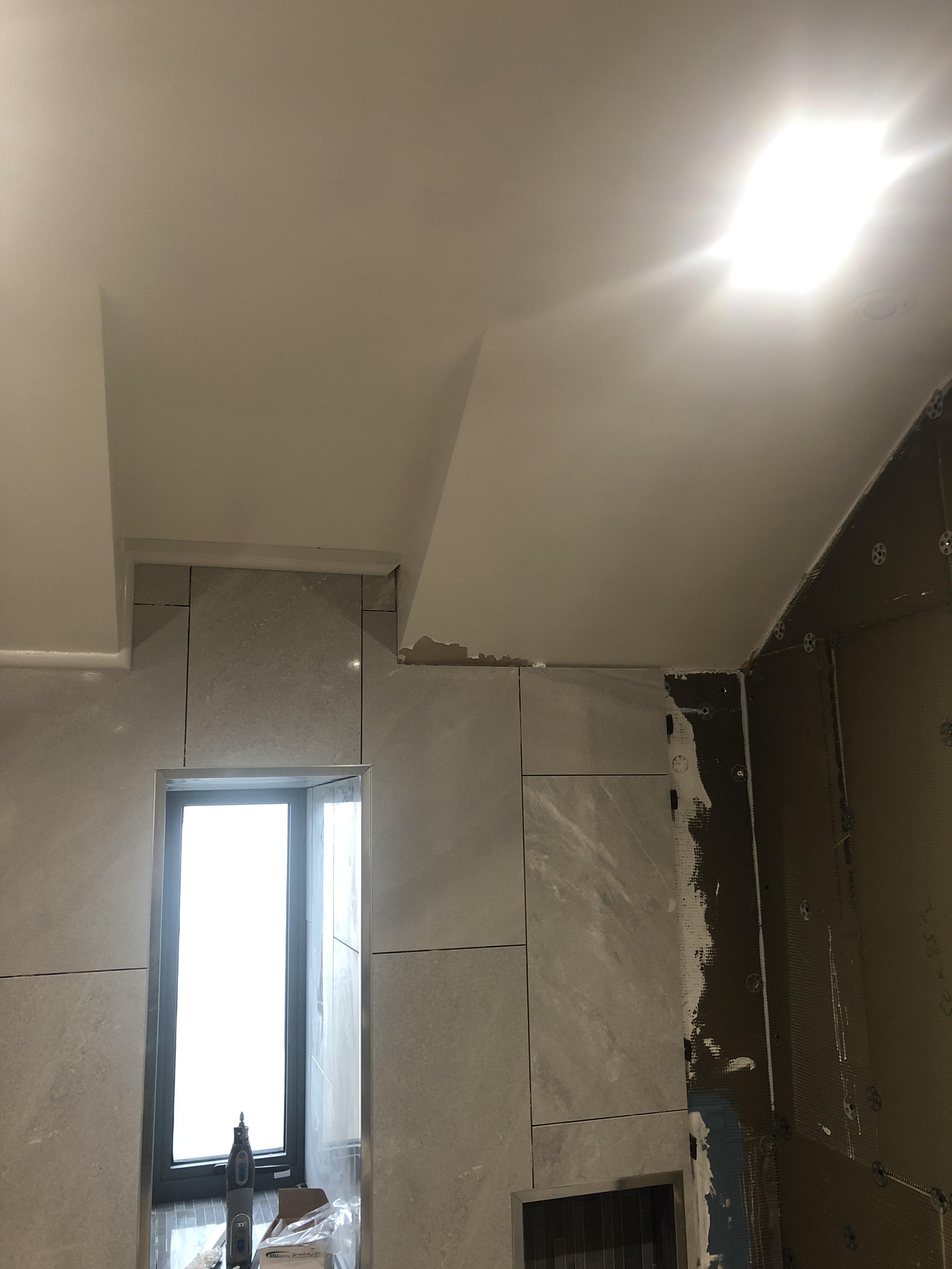

Mr Punter Posted December 14, 2020 Posted December 14, 2020 It is difficult to match up sprayed paint finish. You need to lose the edges with some fine sandpaper and do as @joe90 says. It that a ceiling or a floor? It is a bit hard to tell in your place.
Pocster Posted December 14, 2020 Author Posted December 14, 2020 20 minutes ago, Mr Punter said: It is difficult to match up sprayed paint finish. You need to lose the edges with some fine sandpaper and do as @joe90 says. It that a ceiling or a floor? It is a bit hard to tell in your place. So just finely sand the torn paint back to good I.e stuck paint ? Then fine roller ? . I could set the sprayer up just for this bit if I really really have to !! Photo to help place issue 1
Pocster Posted December 14, 2020 Author Posted December 14, 2020 Fine sand paper removes the plaster bot the paint . Paint is a silk type Adair so like a ‘skin’ on the plaster
joe90 Posted December 14, 2020 Posted December 14, 2020 1 minute ago, pocster said: Fine sand paper removes the plaster bot the paint . Paint is a silk type Adair so like a ‘skin’ on the plaster I might tend to peel any paint off that’s not stuck, loads of paint on the plaster (many coats) which you can then sand back to match the sprayed paint, them maybe a mist coat sprayed on to blend it in..
Ferdinand Posted December 14, 2020 Posted December 14, 2020 If I didn't know better I would say that is walkon glazing in a floor, with a not-quite-plumb wall. Now serious. Slightly concerning that it is coming off in a sheet - is it all that loose? Any idea why that is? If it isn't gloss I might be inclined to overpaint the whole ceiling with a slightly different shade.

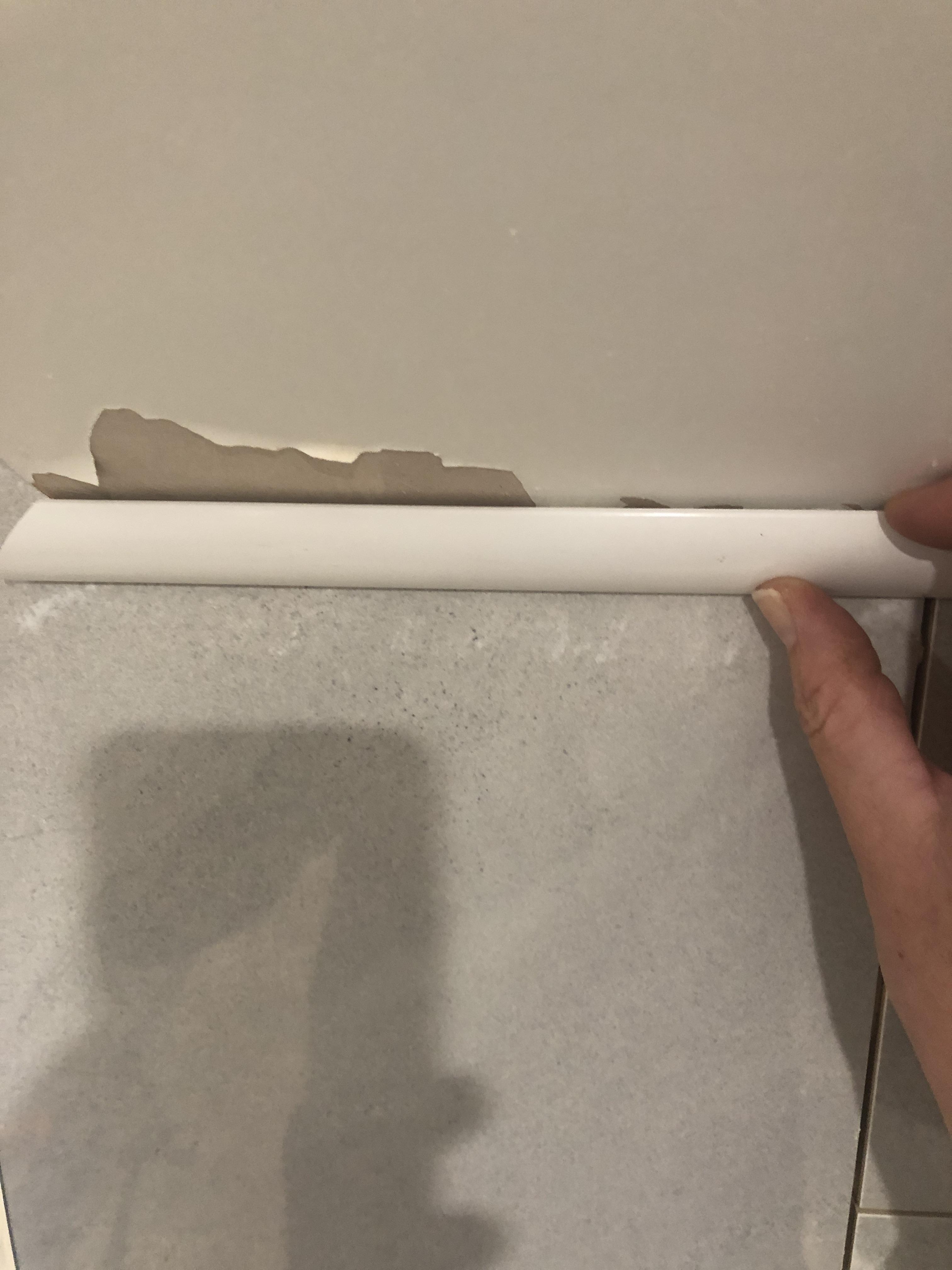

Pocster Posted December 14, 2020 Author Posted December 14, 2020 1 minute ago, joe90 said: I might tend to peel any paint off that’s not stuck, loads of paint on the plaster (many coats) which you can then sand back to match the sprayed paint, them maybe a mist coat sprayed on to blend it in.. It doesn’t ‘tear’ its a ‘film’ . The larger bit I got off was surprisingly stretchy . Bathroom type ; moisture resistant paint not like emulsion ...
Pocster Posted December 14, 2020 Author Posted December 14, 2020 1 minute ago, Ferdinand said: If I didn't know better I would say that is walkon glazing in a floor. Slightly concerning that it is coming off in a sheet - is it all that loose? Any idea why that is? Because I ripped some beading off that had a line of Mastik stuck to the paint . 1
ProDave Posted December 14, 2020 Posted December 14, 2020 I am concerned that the sprayed on paint just peels off. I don't think I have ever been able to peel off painted or rollered emulsion paint like that.
Pocster Posted December 14, 2020 Author Posted December 14, 2020 It’s like a stretchy ‘plaster ‘ . Actually quite hard to tear . Well ! Apart from the bit I ripped off .

Onoff Posted December 14, 2020 Posted December 14, 2020 Think I'd be running a scalpel around the damaged area to define an "edge" beyond which is guaranteed stuck down paint. 1
Russell griffiths Posted December 14, 2020 Posted December 14, 2020 And this is why you back roll sprayed surfaces. 1
