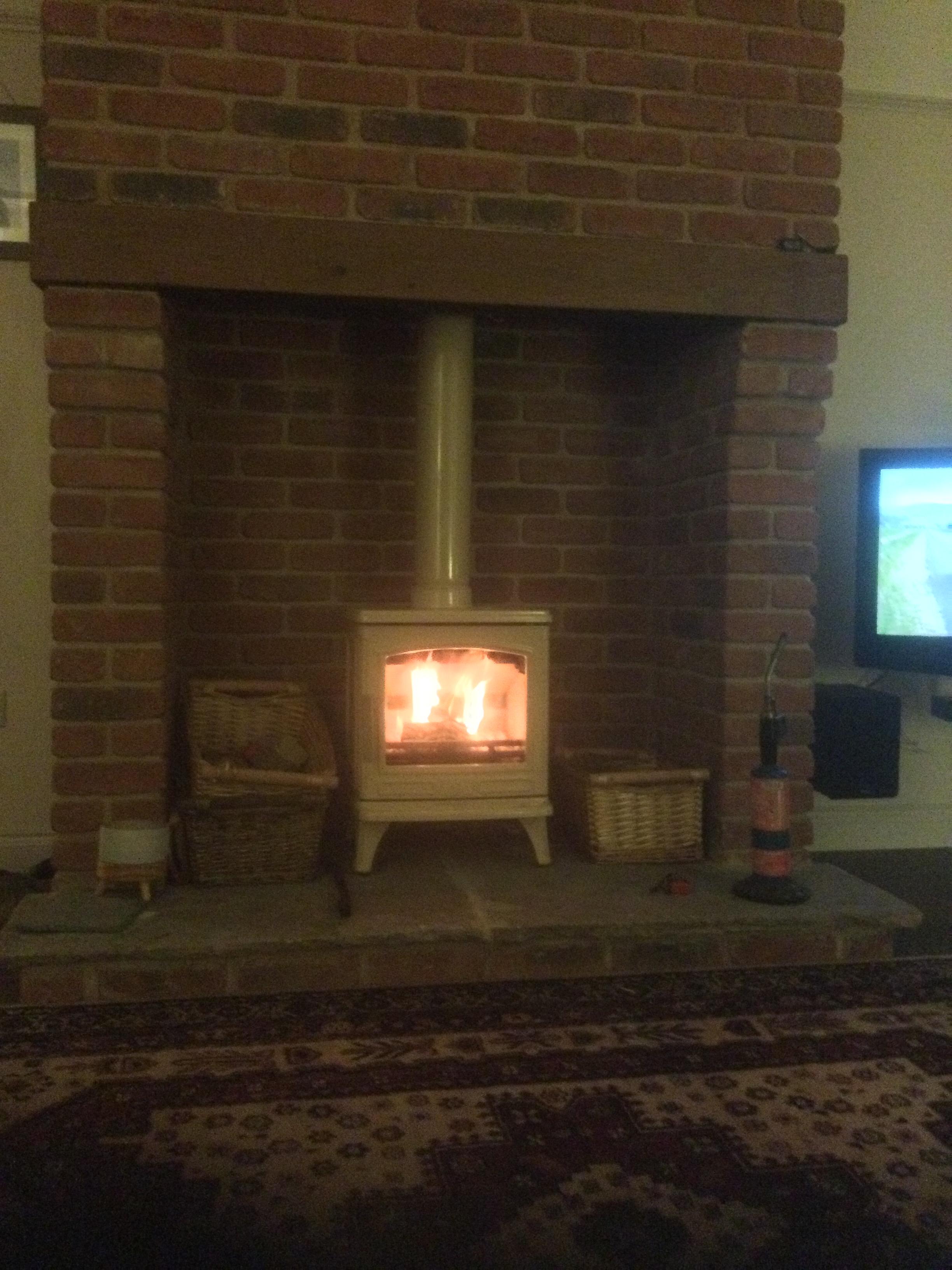

joe90 Posted December 7, 2020 Posted December 7, 2020 11 minutes ago, SteamyTea said: Weigh the amount of timber you put in, and every 15 minutes, note the rise in air temperature. Work out the mass of air in the room, then calculate. And while you are at it, count the number of 'rings' on each log, work out the mean, and compare the number of years it takes to grow, compared to the number of minutes it takes to burn. I did not instal a woodburner to be efficient, it’s the asthetics.

joe90 Posted December 7, 2020 Posted December 7, 2020 (edited) 7 minutes ago, Declan52 said: I have a wbs that gets lit maybe 6 times a year. You can't have it roaring or the living room and kitchen gets to 28 degrees+ very quick. mine gets lit more than that but only fir about an hour, maybe two, it’s currently 25’ in here (the lounge, in my tee shirt) but I have been Outside working and got thoroughly cold so enjoying the warmth. The house will be still be warm in the morning so saving me lecky fir the ASHP. ? Edited December 7, 2020 by joe90

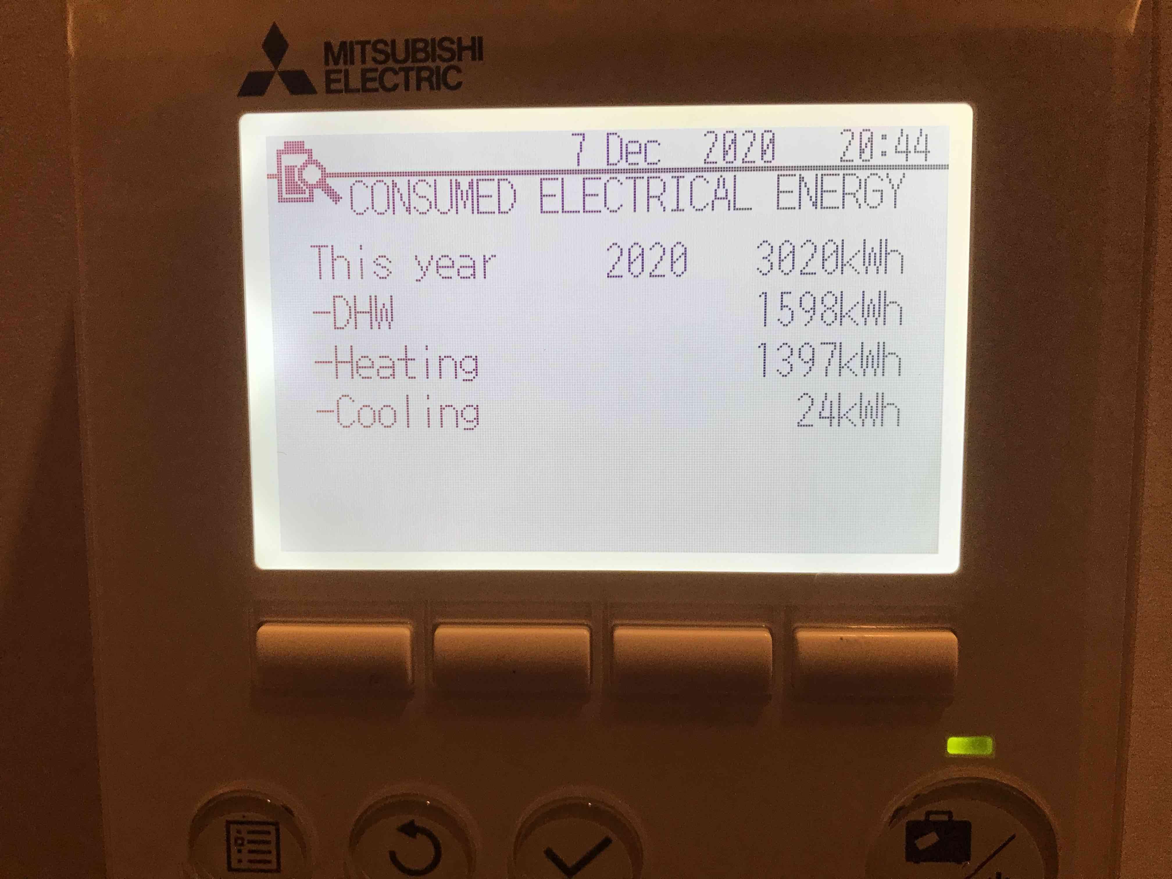

Nestor Posted December 7, 2020 Posted December 7, 2020 (edited) 1 hour ago, Oz07 said: Similar in roof too then? Do you have an insulated foundation? Same in the roof. Foundation is 100mm concrete, 150mm Celotex, 40mm screed. Figures below are for just over 10 months. Edited December 7, 2020 by JamesP

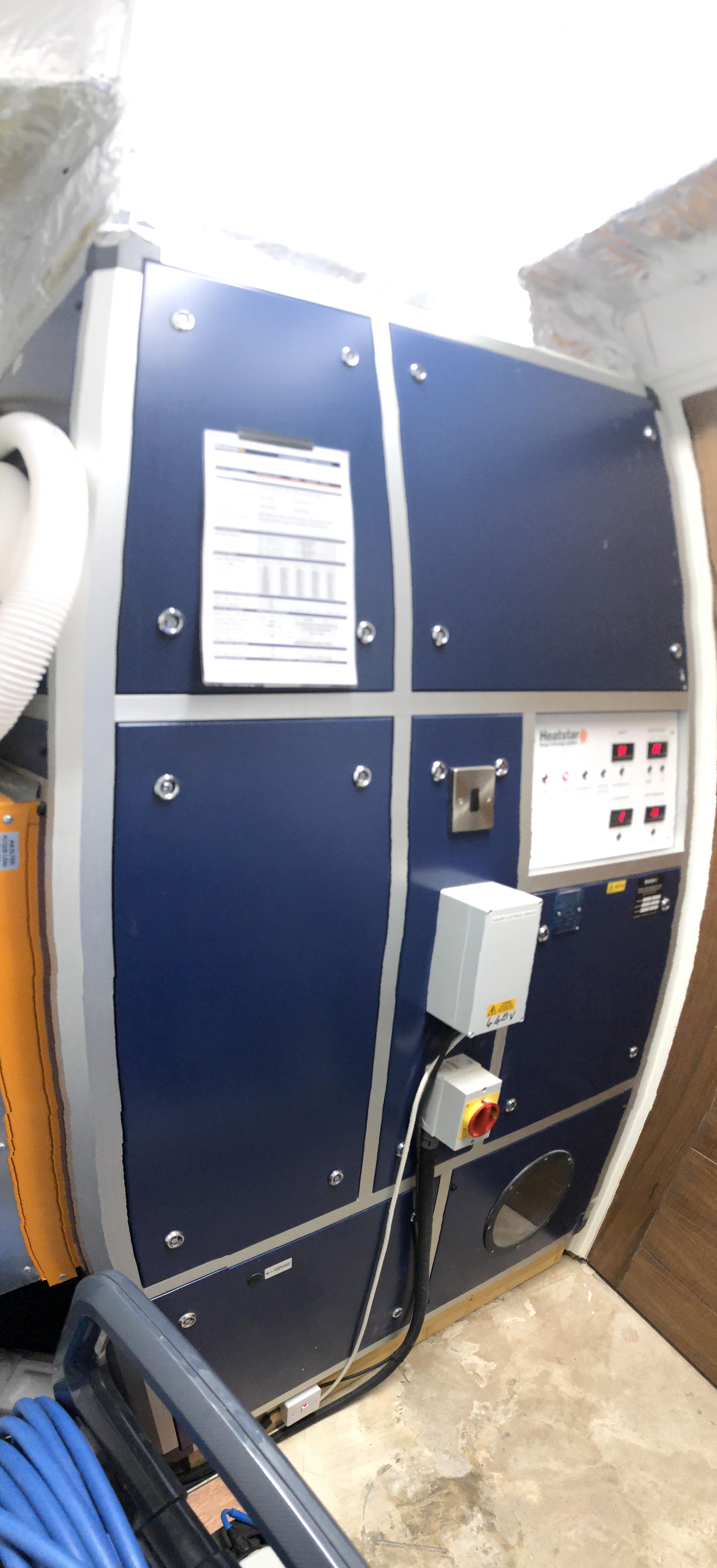

AliG Posted December 7, 2020 Posted December 7, 2020 1 minute ago, Thedreamer said: Do you recycle the heat leaving the pool? I would imagine you would recover a fair amount using an exhaust air source heat pump. Yes, the pool is covered as the first thing to do is try to limit the evaporation. Then there is a massive Heatstar machine which sucks humid warm air out of the room above the pool. It feeds the heat back into the pool and cool air out into the room across the windows. It also kicks in to heat the room up very quickly with hot air when you open the pool cover. So this keeps the heating costs low but at the cost of £20k of machine and ductwork. It also uses a lot of electricity, but it is hard to isolate exactly how much. 1
