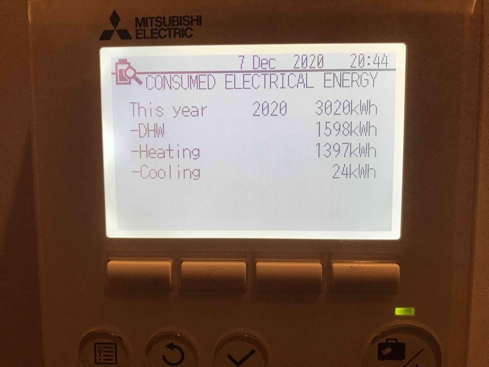

DamonHD Posted December 6, 2020 Posted December 6, 2020 76m^2 Last year consumption and generation figures: http://www.earth.org.uk/saving-electricity-2019.html 1992kWh e (consumption), 3855kWh e (generation), 3157kWh gas (DHW + spac heat). So final energy per m^2 * ignoring generation, exergy, carbon intensity, etc: 68kWh/m^2 * allowing for generation: 17kWh/m^2 * space heat alone (allowing 4kWh/d for DHW): 40kWh/m^2 for space heat Rgds Damon 1
ProDave Posted December 6, 2020 Posted December 6, 2020 Mine comes out at 1648kWh for the year, that's not any estimate, that's the current real world measured electricity usage. It's about 150 square metres so 11kWh per square metre. That's the electricity driving an ASHP so in terms oh heat input assuming a COP of 3 that would be 33kWh of heat per square metre per year. I hope that figure will drop when we finally get the sun room complete as I hope that will be able to add some solar heat into the house on a sunny day. Solar PV generation exceeds that amount. 1

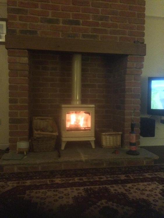

Thedreamer Posted December 6, 2020 Posted December 6, 2020 Been in the house for nearly 6 months, but coming in at 25.92 That me taking the electricity energy units 1815 units / 6 x 12 / 140. 3 hours ago, Oz07 said: That's why wood burning people have got to declare also. Yes, I need to declare this, burn a trug of free logs each night as well. 1

ProDave Posted December 6, 2020 Posted December 6, 2020 34 minutes ago, Oz07 said: @ProDave do you have a separate meter on the ashp side of the leccy? Yes I specifically installed another electricity meter to measure what we use for heating. This shows "other stuff" in the house uses at least twice as much as heating the house. PV generation exceeds heating usage, but does not quite cover heating and DHW
Oz07 Posted December 6, 2020 Author Posted December 6, 2020 Is your water ontop of your figure then? Ie just for heating

ProDave Posted December 6, 2020 Posted December 6, 2020 1 hour ago, Oz07 said: Is your water ontop of your figure then? Ie just for heating Yes that's just space heating. DHW is on top of that. I don't see the point of relating DHW useage to square metres. That is a function of how many people not how big and well insulated the house is. And just to clarify this is not energy usage for "stuff" either. The non heating and non DHW electricity used here is roughly double heating + DHW. So if all my heating and DHW dropped to zero, the electricity bill would go down by about 1/3 This compares to our previous house where our electricity usage was about the same as our total here but in addition at the old house we were spending over £1000 on oil every year. 1

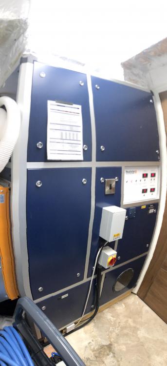

Oz07 Posted December 6, 2020 Author Posted December 6, 2020 I'll be interested to see if mime reduces on a per annum basis. Sap estimates closer to 40kwh m2 @ProDave Good point about hot water not being anything to do with house performance per se. Unfortunatley i can't separate mine unless I start measuring things. Still no comments on if mvhr increases your heating demand. Even allowing for opening bathroom Windows and running extractor for 40 mins a day in the old place I suspect the mvhr system here gives me more loses over 24hr. So much for heat recovery!

Ferdinand Posted December 6, 2020 Posted December 6, 2020 7 minutes ago, Oz07 said: Still no comments on if mvhr increases your heating demand. Even allowing for opening bathroom Windows and running extractor for 40 mins a day in the old place I suspect the mvhr system here gives me more loses over 24hr. So much for heat recovery! I set the boffins on this some time ago wrt my trickle fans (HR and not HR) which lose more energy than MVHRs, and the amount of heat than can be carried in the volume of air put out by an MVHR - once you have allowed for the 70-90% of heat that is recovered - makes it quite negligible in terms of the actual numbers. IIRC it is of the order of 10s of £££ per year at most. It may be in a thread in Boffins' Corner somewhere. F
Oz07 Posted December 6, 2020 Author Posted December 6, 2020 Is the sane argument not made in reverse though for picking mvhr over extractor, as in extractor expel a lot of air you've paid to heat?
Ferdinand Posted December 6, 2020 Posted December 6, 2020 13 minutes ago, Oz07 said: Is the sane argument not made in reverse though for picking mvhr over extractor, as in extractor expel a lot of air you've paid to heat? Yes - but in my case my house is a full reno (3 walls and a hole in the ground) which does not reach "near passive" level from 10 years ago by somebody else to make a chalet bungalow with a warm roof, so I can't fit an MVHR without huge dismantling - so I went for a PIV loft fan upstairs and a HR trickle unit downstairs. Not ideal, but the best I can do. Were I building new, I would be going near passive and MVHR. Love the typo - "sane argument". That's usually the one I'm not making ?. F
Hobbiniho Posted December 6, 2020 Posted December 6, 2020 (edited) Interesting point regarding the DHW usage, i suppose mine is relatively low as i am a single man so will use not a lot of hot water, redoing the figures takes my consumption down from 42.8KWh/m2/year to 39.9KWh/m2/year and generation from 89.6KWh/m2/year to 81.7KWh/m2/year For the argument about MVHR i always understood it to be more about having a basically net 0 gain/loss in heat its heat recovery not heat addition, normal extractors dump hot air outside and replace it with cold through trickle vents, MVHR uses outgoing air to heat the incoming air to inside temperature. People that i speak to that have MVHR say they are amazed at the air quality and overall "freshness" and lack of condensation. Edited December 6, 2020 by Hobbiniho KWh
PeterW Posted December 6, 2020 Posted December 6, 2020 2 hours ago, Hobbiniho said: MVHR uses outgoing air to heat the incoming air to inside temperature That is only partially true - you get a maximum 80-85% transfer which means that when you have a delta of 16°C between inside and outside you will only be getting 13°C uplift. This means you can soon start cooling the air in a house when it Is only 4°C outside.
