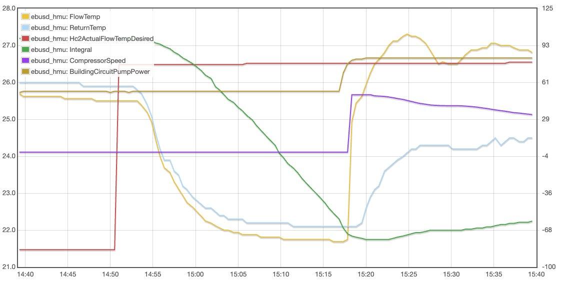

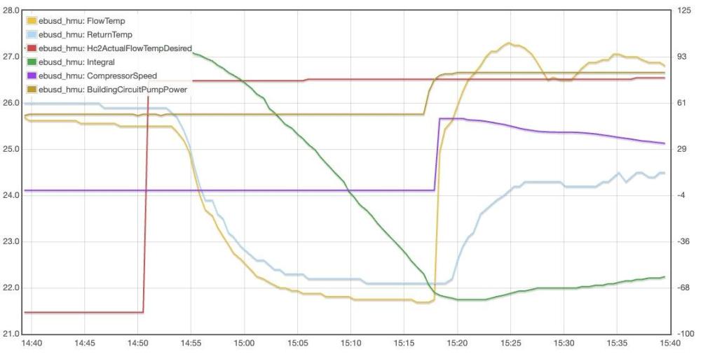

Dan F Posted February 15, 2024 Posted February 15, 2024 (edited) This shows this working, along with the compresor modulation: Target flow temperature increases (red) Nothing happens immedialty, as there is high integral from pevious low target temp. integral (deg.min) gradually reduces from 99 to -60 based onthe delta between actual and target flow temperatures. Once integral hits -60 heating pre-run starts and pump power increases (brown) Shortly afterwards compressor starts (purple) Compressor modulates trying to match desired flow temp (yellow) Integral increases if actual flow temp is above desired flow temp, and decreases if actual flow temp is below target. If the heat demand < min output, then (even at min compressor) the actual flow temperature will generally be above the target. If this occurs, then integral gradually increases based on excess deg.minutes. Once integral reaches 0, compressor is turned off. If the heat demand > min output then integral chaneg slightly, but won't increase to 0 over time and the unit continues to run. Edited February 15, 2024 by Dan F 1

Dan F Posted February 21, 2024 Posted February 21, 2024 On 15/02/2024 at 01:56, Dan F said: I've tested this, but doesn't work on my arotherm+. It seems to just ignore the configuration and fire up the compressor at -60 ° minutes anyway. Have you happened to have tested this? Expand @J1mbo I resolved this in the end, it was a firmware bug. The old firmware doesn't respect the "-100degmin" setting, it also double-counts the change in integral resulting in increased cycling! New firmware works as expected.
Dreadnaught Posted September 14, 2024 Posted September 14, 2024 @Dan F, as an amateur non-engineer, I have been thinking deeply about the control system for the Arotherm Plus heat pumps. This thread, and your graph above in particular, has been helpful for me. I wonder do you happen to know whether "Hc2ActualFlowTempDesired" is targeting the temperature of the flow to or return from the home? I could imagine it being either.
