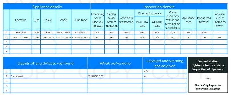

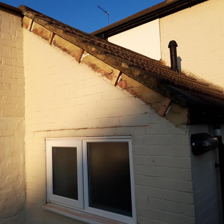

Onoff Posted November 25, 2020 Posted November 25, 2020 Just had the annual Gas Safety Check at a rental property. Just recently in fact rented it out again and in getting it ready had BG in ref the boiler where they did some repairs etc all under our landlords package with them. Then this year we get told we have an appliance that isn't safe because the flue can't be inspected: It goes up in an airing cupboard and out through an inaccessible roof over the bathroom extension So we've rung them to be told that since 2013 if they can't see something thay can't pass it. This despite the annual chacks up until now haven't flagged it as an issue. The guy went on that it was likely done by someone fresh out of college and a more experienced fitter wouldn't have flagged and thus passed it. We're quite welcome to find a 3rd party who will pass it and their cert will void the BG one! The report says he turned it off...he didn't. They made the suggestion we get a builder in to fit an access hatch, thereafter there'll be a £79 revisit charge. At a bit of a loss at the mo. Any suggestions?

Onoff Posted November 25, 2020 Author Posted November 25, 2020 44 minutes ago, Oz07 said: 7 years of gas safety refund for a start Best suggestion so far! ? Going to get my barrister big brother to check my draft letter of complaint to them. There's a nom 600x600 ceiling where the pipes go up in the airing cupboard into that roof. I'm guessing pipes to the bathroom will run across it there. Seems a bit daft putting a hatch up into what is a draughty, cold roof thus surely well ventilated? Would have thought there's more risk of fumes coming through the hatch unless they have seals of some sort. Or maybe BG would prefer an access hatch through into the kid's bedroom? Found a bit here: https://www.gassaferegister.co.uk/help-and-advice/gas-safety-in-the-home/get-your-appliances-checked/flues-in-voids/flues-in-voids-faqs/ So BG should have told us about hatches for the the last 7 years we've had the property! Really aggrieved about that. I've no issue going and fitting a hatch but it's the whole hassle thing for me and the in particular the tenants. The Covid issue too. I'll get on it asap whatever. Some sort of a surface mount hatch maybe? With gas seals, might be a tall order? BG overall are w***ers imho.
ProDave Posted November 25, 2020 Posted November 25, 2020 Unfortunately the BG man is right, they are supposed to inspect the flue and if the flue is inaccessible they can't pass it. the fact they have incorrectly passed it for 7 years won't hold much weight with the refusal now. So you are going to have to cut that hatch I am afraid. 1

Gav_P Posted November 25, 2020 Posted November 25, 2020 19 minutes ago, Onoff said: Indeed. The saving grace I guess being the draughty roof void. Wrong though that he says on his report turned off but seemingly didn't. Or did the tenant turn it back on? I think they have to ‘disable’ it if it’s unsafe, to make sure tenants can’t just turn it back on again as soon as they have left. ... I think there’s some labelling they are supposed to do like ‘condemned’. May be worth a quick investigation as to the correct practice is and add it to your complaint. I’ll ask my F-I-L who is a gas engineer. 1
Gav_P Posted November 25, 2020 Posted November 25, 2020 Probably worth calling Gas Safe to get confirmation of when the regs came in for inspecting the flue, but it’s been in place for longer that BG have been inspecting it. They can give you advice too. If they deemed it ‘at risk’ due to not being able to inspect the flue, then then should have isolated the gas supply, so it couldn’t fire up until turned back on by qualified engineer. Is it a condensing boiler? Do you have the gas analysis numbers from the flue gas test? And the o2 test? (This should be 20.9). There could be a ‘get out of jail free’ card for them if they have evidence that there are no joints in the flue (probably needs to be under 1.1m for this to be possible). Realistically they have cocked up big time and will want to keep this quiet... can you imagine if you open up the loft and ‘happen to find’ the flue joints have separated? I’m sure that wouldn’t look good for BG if it ended up in the press.
