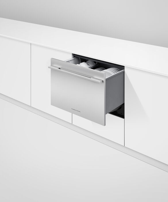

joth Posted November 17, 2020 Share Posted November 17, 2020 (edited) Another option is to use a half-height "drawer" style of dishwasher. You can even put a pair side by side, and stack one while the other is running. Fisher Paykel are most known for this, but looks like there's some other no-name versions available too https://www.fisherpaykel.com/uk/dishwashing/all-dishwashers/?prefn1=configuration&prefv1=Single Drawer https://www.wayfair.co.uk/Klarstein--Amazonia-55cm-EEK-A-Dishdrawer-10028325-10028326-L1053-K~U001182444.html Edited November 17, 2020 by joth Link to comment Share on other sites More sharing options...

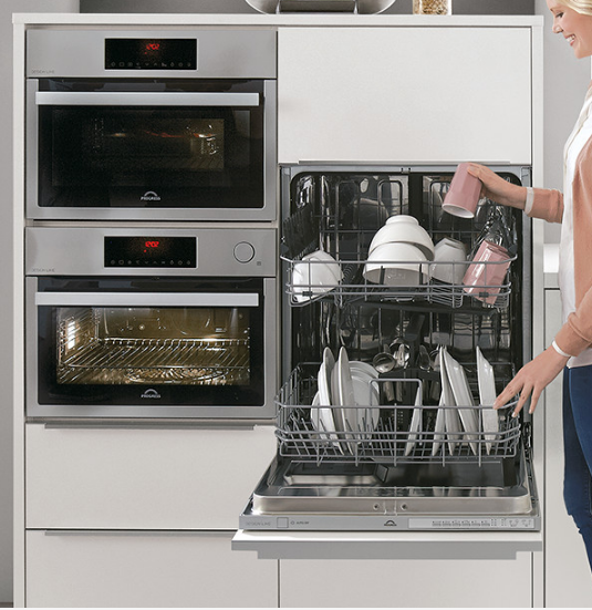

MJNewton Posted November 17, 2020 Share Posted November 17, 2020 (edited) 1 hour ago, ryder72 said: There is a solution available for this from most German suppliers. Its well thought through and takes into account the underswing of the dishwasher door. There's a retrofit option available for other dishwashers - http://adapt-r.co.uk/ (surprisingly pricey but could be worthwhile (neceessary) for some). Edited November 17, 2020 by MJNewton Link to comment Share on other sites More sharing options...

MJNewton Posted November 17, 2020 Share Posted November 17, 2020 In case you might not have clicked the Adapt-r link I see they've actually got a photo on their front page which may be food for thought: Link to comment Share on other sites More sharing options...
