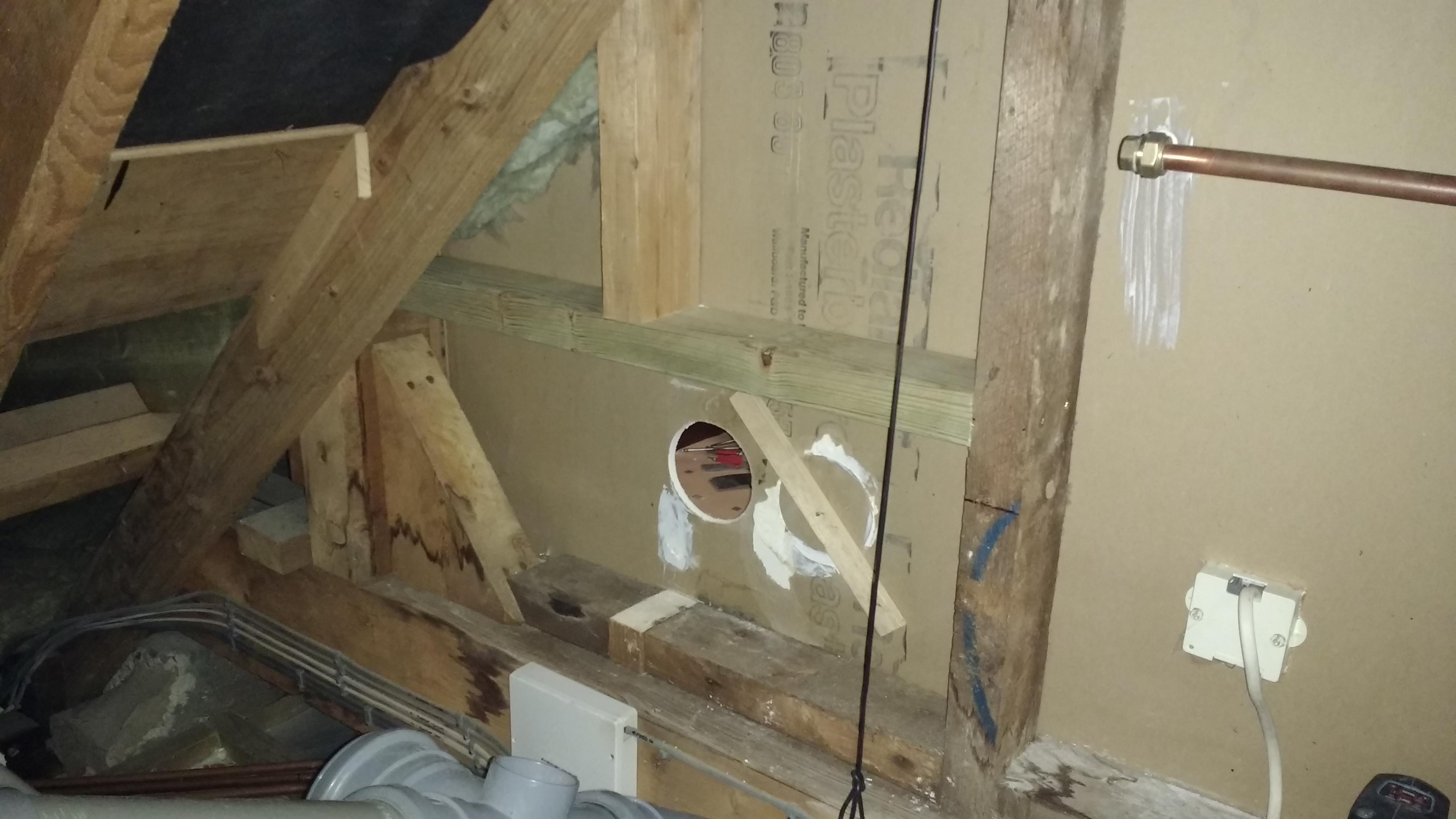

Onoff Posted November 22, 2020 Author Share Posted November 22, 2020 Didn't get very far today. Interruption after interruption. Cut the stud and blocked 3 holes up with some rounds of 3/8" pb stuck in with EBT (all I've got here). I'll chuck another bit of 4"x2" under that new horizontal one and wedge it on that big angled chunk at the bottom of the dormer corner 4"x4" post. Just don't know where the day went! Link to comment Share on other sites More sharing options...

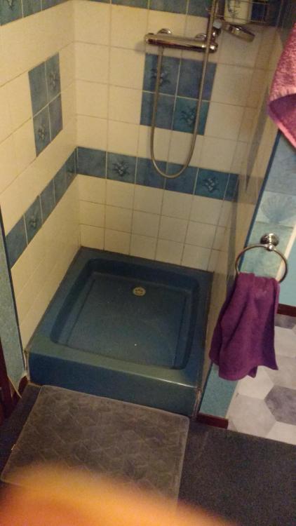

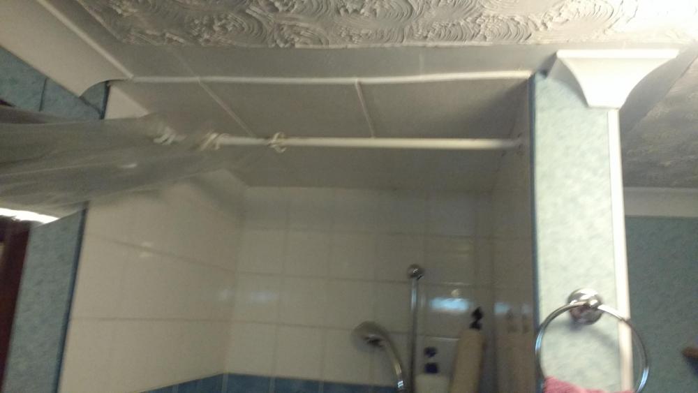

Onoff Posted November 23, 2020 Author Share Posted November 23, 2020 (edited) Mulling the cheapest route to shut SWMBO up! Old tray needs to go. Currently 800x800. I think she thinks we can keep the tiles! ? So 1200x800 tray to source. Waste route no issue. I'm half thinking of multi panel though I always think it looks a bit "caravan": Horrid Artex ceiling with glossed, polystyrene tiles over the shower. (We don't use this shower anymore btw). Edited November 23, 2020 by Onoff Link to comment Share on other sites More sharing options...
joe90 Posted November 23, 2020 Share Posted November 23, 2020 2 minutes ago, Onoff said: I'm half thinking of multi panel though I always think it looks a bit "caravan": NO, best thing I ever did was move away from tiles to wall panels. I HATE GROUT!!!. 3 minutes ago, Onoff said: Horrid Artex ceiling with glossed, polystyrene tiles over the shower remove tiles, dead easy, get it skimmed and painted, job done. ? Link to comment Share on other sites More sharing options...

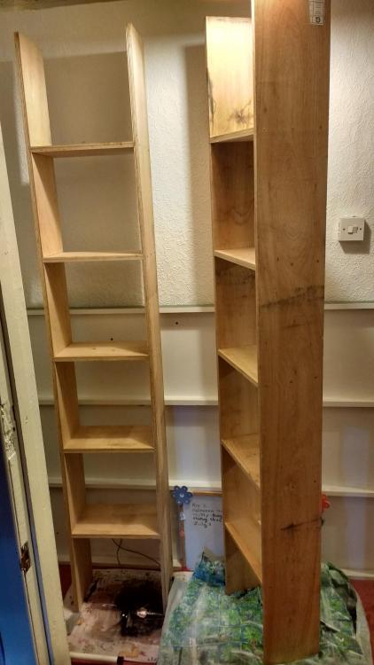

joe90 Posted November 23, 2020 Share Posted November 23, 2020 @Onoff, just love those storage units (fir a garage!!!,!). You say you don’t use that shower anymore so why are you putting a new shower in? Link to comment Share on other sites More sharing options...

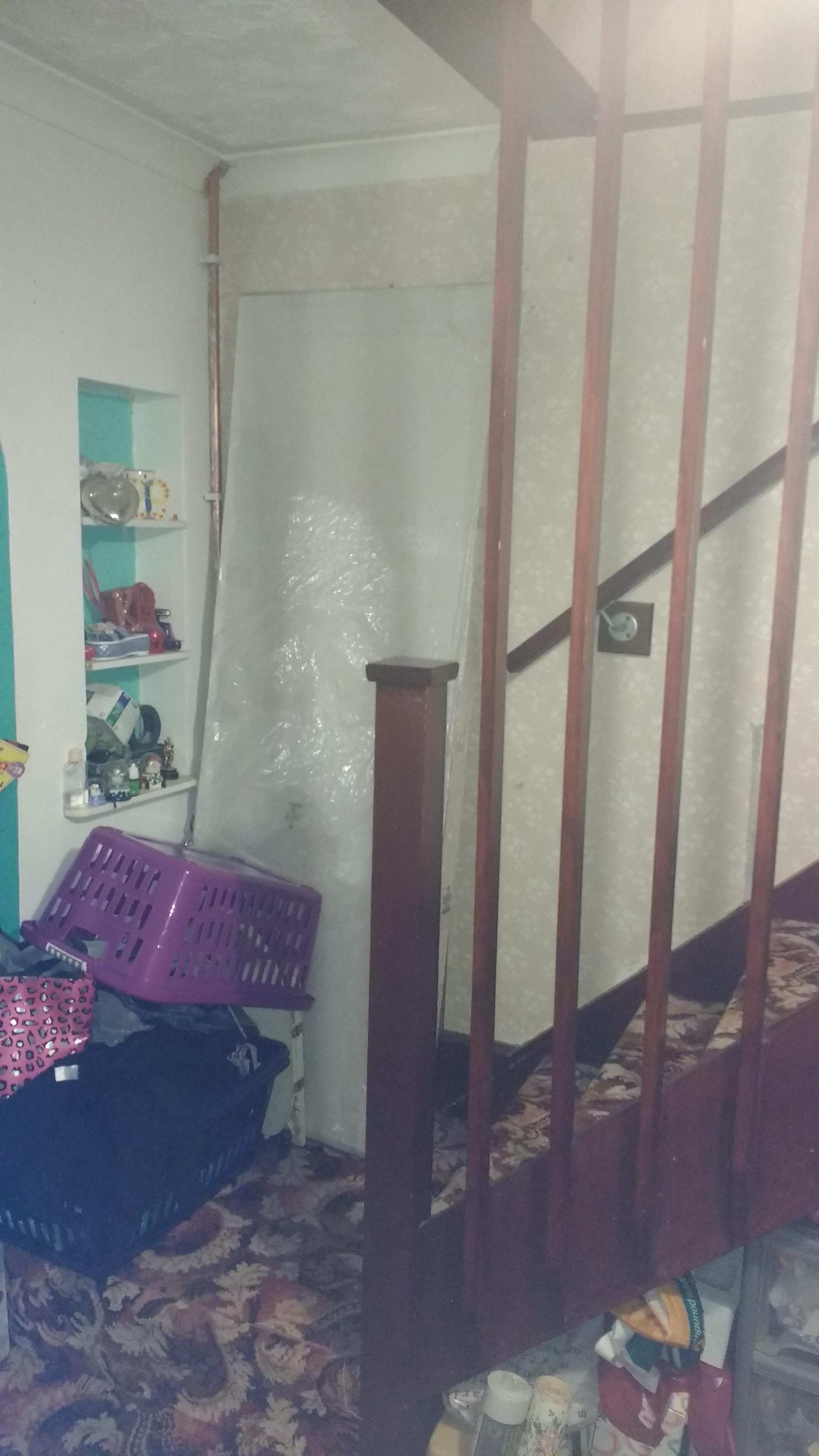

Onoff Posted November 23, 2020 Author Share Posted November 23, 2020 57 minutes ago, joe90 said: @Onoff, just love those storage units (fir a garage!!!,!). You say you don’t use that shower anymore so why are you putting a new shower in? In SWMBO's words, and I quote: "It'd get it (the sliding shower doors) out of the stairs room". Big white box on the half landing. Been there 10 years at least. Can't see the problem myself. Hmmm...I wonder if it's a ploy by her to delay me digging up the stairs room... 3 Link to comment Share on other sites More sharing options...
PeterW Posted November 23, 2020 Share Posted November 23, 2020 3 hours ago, Onoff said: I'm half thinking of multi panel though I always think it looks a bit "caravan": You’re thinking of the hollow plastic stuff aren’t you ..? Multi panel is nothing like that - dead easy to cut and fit (as long as you can get it upstairs...!) but 2 x 900 and 1 x 1200 will be about £400 or so with profiles so not cheap by any stretch. You could ask @pocster where he got his tiles ... and cross that place off your list ..! ? 4 Link to comment Share on other sites More sharing options...
Onoff Posted November 23, 2020 Author Share Posted November 23, 2020 2 minutes ago, PeterW said: but 2 x 900 and 1 x 1200 will be about £400 ... tiles are looking good all of a sudden... Or just say sod it and chuck a grand at it. Link to comment Share on other sites More sharing options...
PeterW Posted November 23, 2020 Share Posted November 23, 2020 Seriously even the speed you move at doing jobs, as long as you keep it simple and don’t go for some stupid-recessed-half-cut-lunatic-idea- laser-cut-sliding-glass-door-shower-shelf, and just go for a 3 sided rectangle of multi panel using the correct corner profiles and a standard tray, you could have that done in a weekend. You’ve even got access from the back so fitting the shower is a doddle, you can fit all the panels then drill the holes for the valve etc. Overboard the rest of the room with taper edge MR board and job done. 1 Link to comment Share on other sites More sharing options...

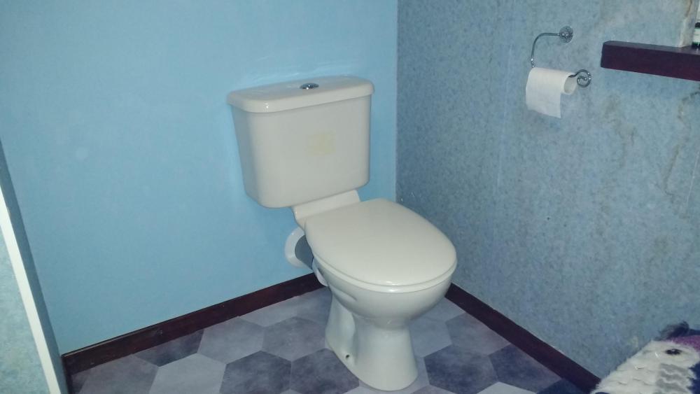

newhome Posted November 23, 2020 Share Posted November 23, 2020 You realise that once you’ve changed the bog in the en-suite you will be banned from using it ? ? ? ? 1 Link to comment Share on other sites More sharing options...
Onoff Posted November 23, 2020 Author Share Posted November 23, 2020 1 hour ago, newhome said: You realise that once you’ve changed the bog in the en-suite you will be banned from using it ? ? ? ? No sh!t! Link to comment Share on other sites More sharing options...

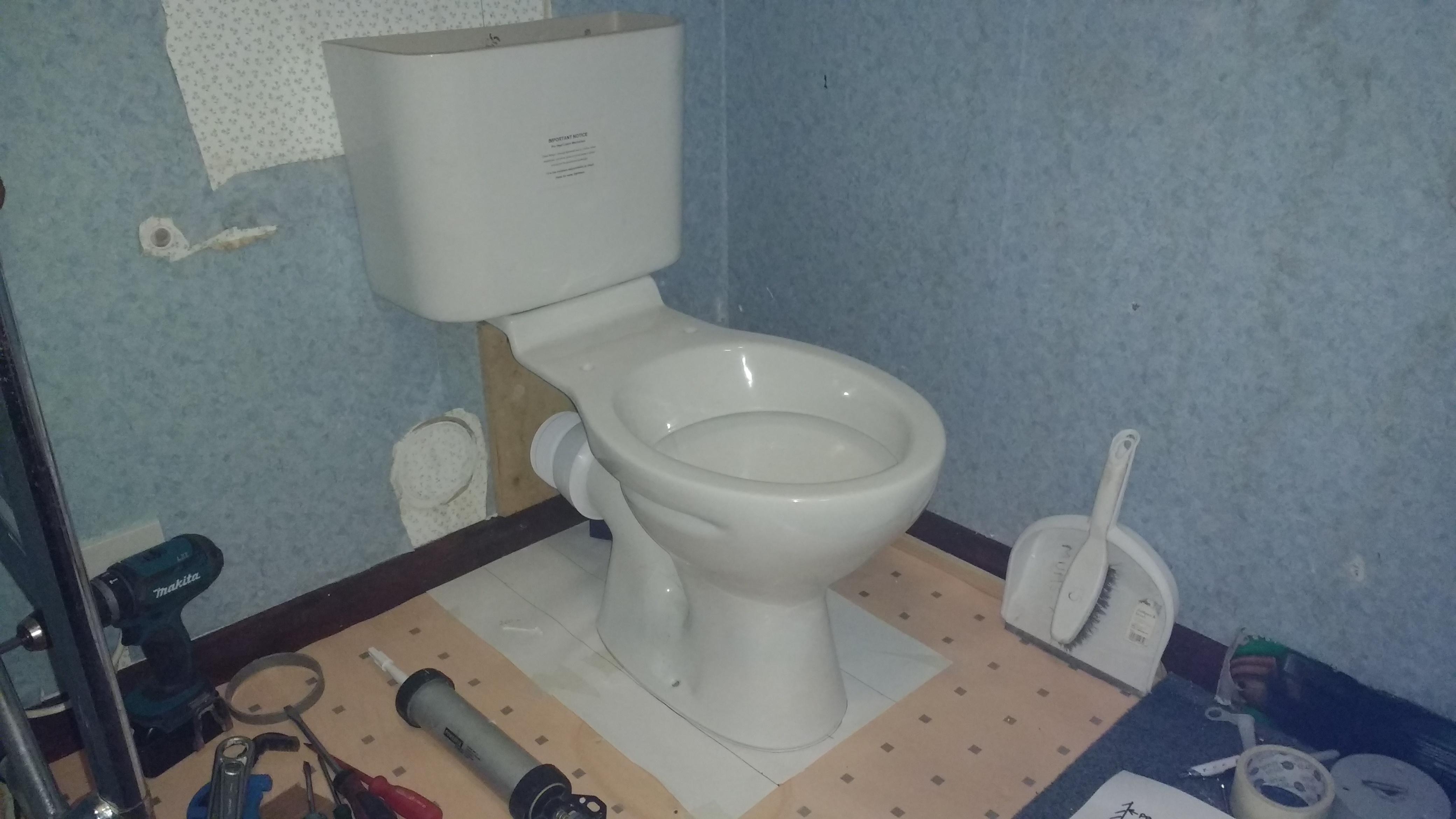

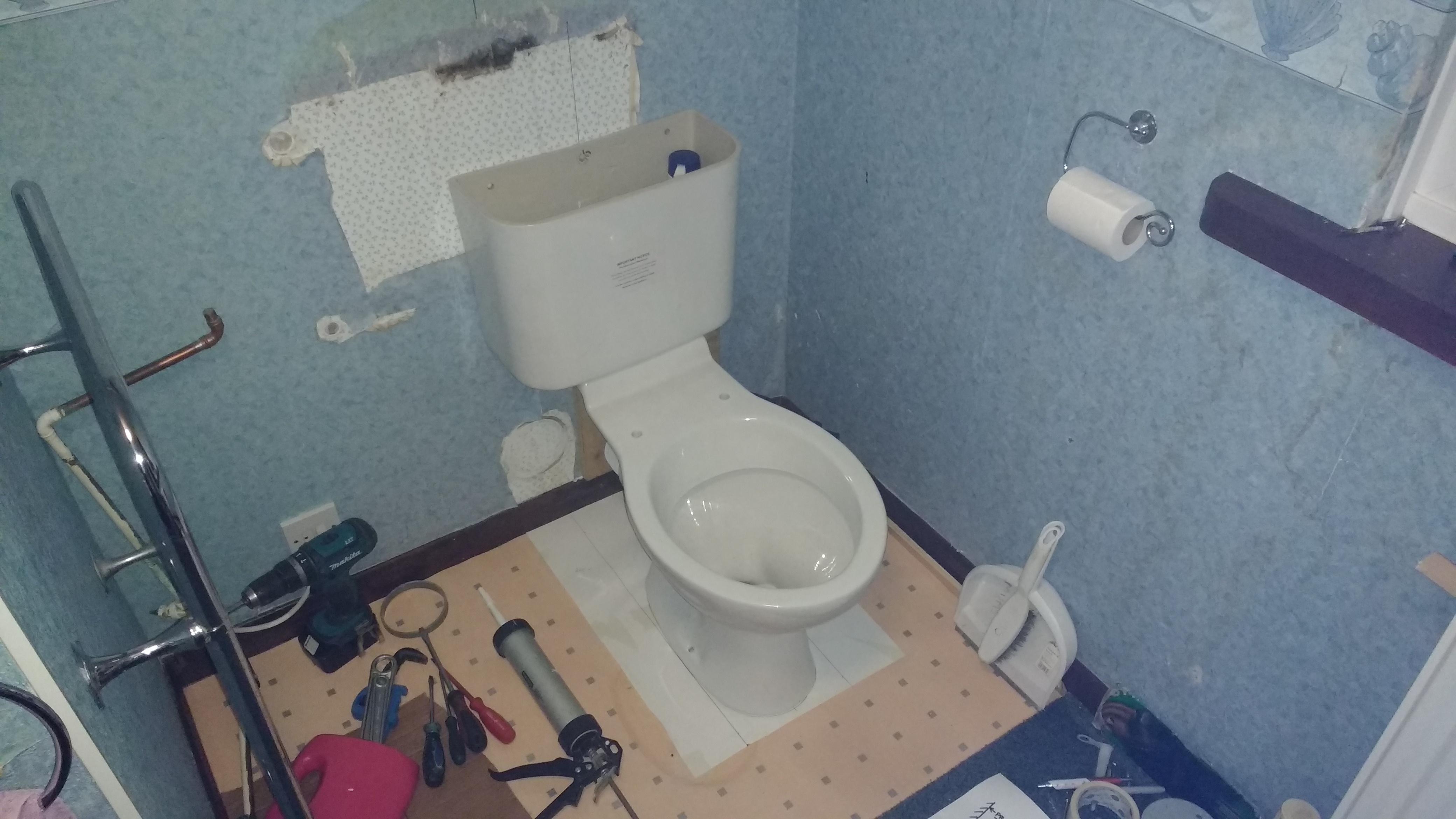

Onoff Posted November 23, 2020 Author Share Posted November 23, 2020 Just to make @pocster feel good: Let's be honest it looks like it should be coming out not going in! Link to comment Share on other sites More sharing options...
Pocster Posted November 23, 2020 Share Posted November 23, 2020 1 hour ago, Onoff said: Just to make @pocster feel good: Let's be honest it looks like it should be coming out not going in! What A state Link to comment Share on other sites More sharing options...
Mr Punter Posted November 23, 2020 Share Posted November 23, 2020 1 hour ago, pocster said: What A state Agreed. Really quite shameful. I feel violated looking at the images. 1 Link to comment Share on other sites More sharing options...
Onoff Posted November 23, 2020 Author Share Posted November 23, 2020 Believe me it's soul destroying doing it. 1 Link to comment Share on other sites More sharing options...
