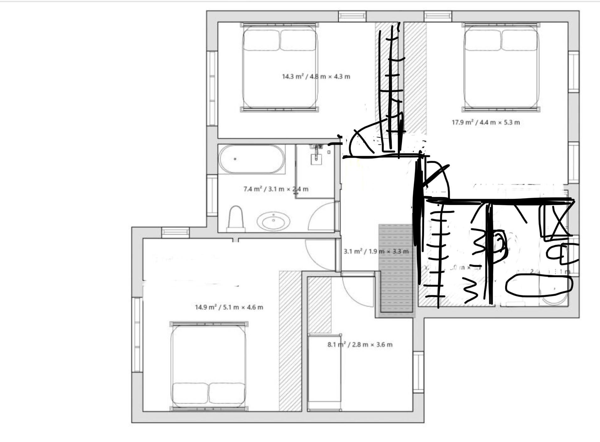

WWilts Posted November 12, 2020 Posted November 12, 2020 While the architect is mulling over things, we're letting our imagination run. 2 floors, 200 sqm. First floor plan options shown (our imagination). Instead of a 5 bed, aiming for a 4 bed and hope to end up with a reasonably attractive master bedroom. Split opinions in family. Which would you pick to live in, A or B or neither, and why? Thanks PS Can't change externals (approved).
DevilDamo Posted November 12, 2020 Posted November 12, 2020 To clarify, both of those options are showing four Bedroom's? I personally prefer the first option as it's a good balance for a 4-bed property... Bedroom 1 with an En-suite and the other Bedroom's sharing a Bathroom. Assuming there is a Cloaks on the ground floor, it can be seen to be a little over-kill to have four W.C.'s for a house of this size. 1

Omnibuswoman Posted November 12, 2020 Posted November 12, 2020 I prefer the first one too, although I'm hard pressed to express precisely why! Very generous room dimensions on both, but perhaps more generous than needed on the second design. 1
ProDave Posted November 12, 2020 Posted November 12, 2020 First one for me, the second does not flow well and the en-suite is too small. 1
Mr Punter Posted November 12, 2020 Posted November 12, 2020 I would prefer 2 x shower rooms en suite and 1 shared bathroom with bath and shower. I think you could have a re-jig. Can any en-suites go back-to-back? May be simpler to plumb. What is the small internal room 2.7m without a door in the first one? If you got rid of it it may be a nice space for desk / sofa. 1

WWilts Posted November 12, 2020 Author Posted November 12, 2020 1 hour ago, WWilts said: Which would you pick to live in, A or B or neither, and why? Here's option C, which some of the family favour. A, B or C (or none of them) for you to live in, and why?

AliG Posted November 12, 2020 Posted November 12, 2020 (edited) In option C it would be difficult to have the toilet there as there is nowhere to put the stack downstairs. You would have to put a shower in that space and the WC where the bath is. I would go option 1 with a small change - As the master bedroom has a large dressing room it doesn't need a wardrobe as well. I would move the door to bedroom 3 up a bit to make the landing larger and then use some of the wardrobe space to have a cupboard off the landing. I would also put a skylight over the landing. Edited November 12, 2020 by AliG 1
WWilts Posted November 12, 2020 Author Posted November 12, 2020 1 hour ago, AliG said: there is nowhere to put the stack downstairs. My introduction to "stack". Thank you. 1 hour ago, AliG said: I would move the door to bedroom 3 up a bit to make the landing larger and then use some of the wardrobe space to have a cupboard off the landing. Good thinking.

DevilDamo Posted November 12, 2020 Posted November 12, 2020 (edited) A minor comment in relation to the En-suite on the first option. If you are keen on having a 4-piece suite, I’d personally consider turning the bath at 90 degrees so it’s positioned width ways. Have the W.C. next to the bath, the washbasin next to the W.C. and then the shower in the same corner as shown but accessed opposite the En-suite door. Unless there is space to access the shower from the side next to the washbasin. If you don’t mind the En-suite having a 3-piece suite (as the Bathroom is a 4-piece), then have a walk-in shower running width ways on the bottom, W.C. and then the washbasin. The size of the shower will dictate the position of that window, which you could shift up a little. Edited November 12, 2020 by DevilDamo 1
WWilts Posted November 12, 2020 Author Posted November 12, 2020 5 minutes ago, DevilDamo said: A minor comment in relation to the En-suite on the first option. If you are keen on having a 4-piece suite, I’d personally consider turning the bath at 90 degrees so it’s positioned width ways. Have the W.C. next to the bath, the washbasin next to the W.C. and then the shower in the same corner as shown but accessed opposite the En-suite door. Unless there is space to access the shower from the side next to the washbasin. If you don’t mind the En-suite having a 3-piece suite (as the Bathroom is a 4-piece), then have a walk-in shower running width ways on the bottom, W.C. and then the washbasin. The size of the shower will dictate the position of that window, which you could shift up a little. Thanks. Externals on front (right of pic) a bit risky to attempt changes, but I get the logic.
Bozza Posted November 20, 2020 Posted November 20, 2020 +1 for A, but I couldn’t help myself but to suggest a couple of tweaks as attached. Mainly to give just a little more space at top of stairs, and to square off rooms a bit. Good luck ! 1

Ferdinand Posted November 22, 2020 Posted November 22, 2020 TI agree 1 is better. Remember that in your dressing room you really want space for a full length mirror and room to stand back very slightly to admire your outfit. I would treat it as 2 sides with the end of the walkway as a mirror. Or alternative provision. F 1
Bonner Posted November 22, 2020 Posted November 22, 2020 Agree with @Bozza, I know it looks like a waste of space but you will appreciate more space on the landing! 1
