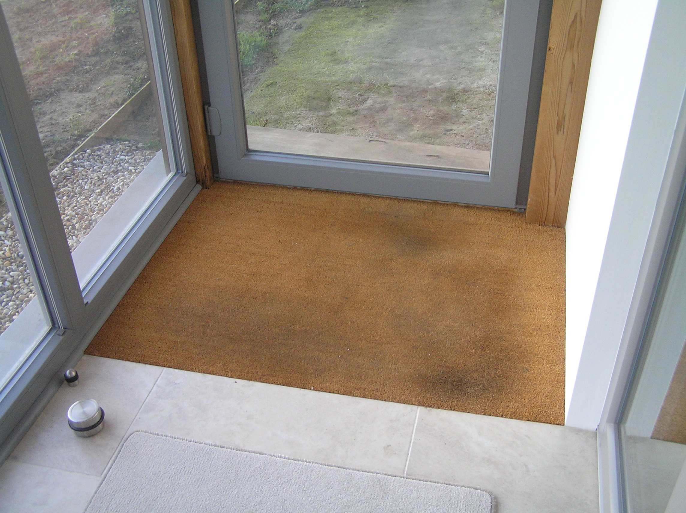

Gone West Posted January 20, 2017 Share Posted January 20, 2017 (edited) I would second the idea of a mat well. We did it in our porch and there are a range of thicknesses of coir matting which can be cut from a roll.. Edited January 20, 2017 by PeterStarck Link to comment Share on other sites More sharing options...

IanR Posted January 20, 2017 Share Posted January 20, 2017 Or whoever measured up. Did they ask where the Finished Floor Level is to be? We cut our mat wells in after the slab was poured. Wasn't the plan, the main contractor ran out of time when preparing for the pour and didn't get the formers in to cast them in situ. We cut ours in 25mm deep, to then leave space to use a self-levelling epoxy screed/mortar to create a level base. Finished depth will hopefully be 15mm and mat very slightly (2-3mm) over-flush to finished floor. Cutting it in after the pour was not a nice job in C35 concrete. Beforehand everyone was telling me how easy it will be. No one thought that after the job was done. It is doable though with the right tools. Link to comment Share on other sites More sharing options...
