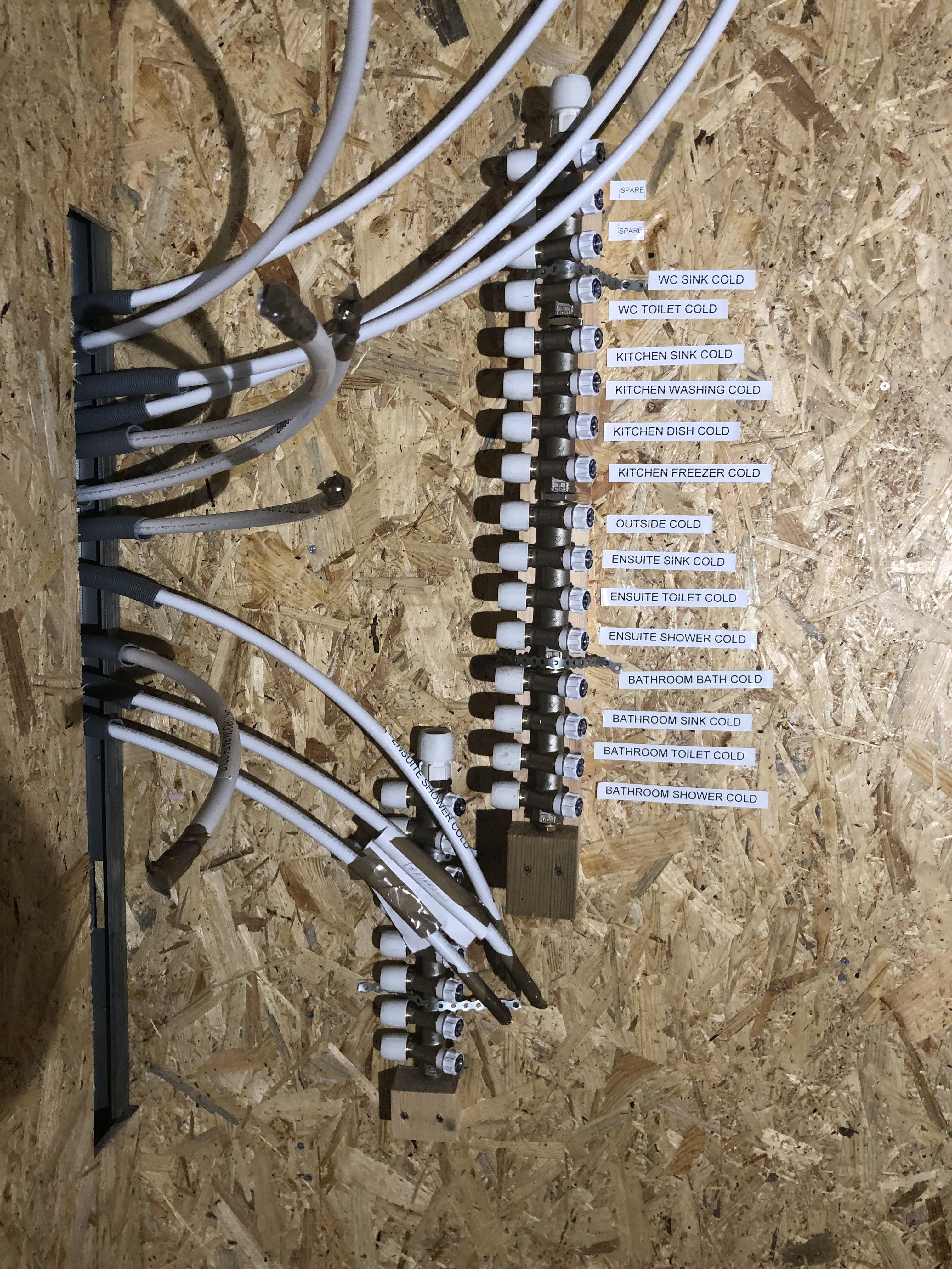

Russell griffiths Posted October 28, 2020 Share Posted October 28, 2020 Evening, just planning out all my hot and cold points around the house. I plan to use a manifold distribution system and if I run a singular pipe to all points in the house I end up with 16 ports needed on the cold manifold, now I can reduce this by having a couple of toilets teed from a basin pipe, or is 16 a nice happy number and I should just carry on. I have a big long wall to put the manifold on so that’s not an issue. Link to comment Share on other sites More sharing options...
PeterW Posted October 28, 2020 Share Posted October 28, 2020 Toilets tend to have built in isolators so I just run direct to them. 1 Link to comment Share on other sites More sharing options...
LA3222 Posted October 28, 2020 Share Posted October 28, 2020 Can't see why 16 would be an issue.....configure it as two banks of 8 so its not one great long line? I expect I'll be at a similar no. to what you jave. 2 Link to comment Share on other sites More sharing options...

PeterW Posted October 28, 2020 Share Posted October 28, 2020 @Thorfun Can run a 22 or 28mm supply to the plant room and then into the UVC Control block, taking the cold off as a balanced cold supply. From there you go to the hot and cold manifolds and then off in 15 or 10mm pipe to each outlet. You can run a standard loop from the balanced cold and the UVC hot with 22mm and tee off to each location with 15mm which is how it used to be done. Nothing wrong with that, you just end up isolating at point of use rather than supply. 1 Link to comment Share on other sites More sharing options...
Thorfun Posted October 28, 2020 Share Posted October 28, 2020 ok, thanks guys. I think I understand both methods now. I believe that every house I've ever lived in has had it the way @PeterW mentions as a standard loop (probably why it takes ages for the hot taps to get hot water!). but, even though it's more pipe I really like the idea of having a centralised location for all the pipes to that you can isolate them at one place. I've a feeling that if I get a professional to do the plumbing that they'd go for the standard loop way as it's easier and cheaper on materials and time! 1 Link to comment Share on other sites More sharing options...

PeterW Posted October 28, 2020 Share Posted October 28, 2020 Just as an advisory to those who do go manifold for the ease of isolating individual circuits - always cap the open end of the pipe at the point at which you terminate it, you will at some point turn the wrong isolator ...... 1 1 1 Link to comment Share on other sites More sharing options...

Oz07 Posted October 29, 2020 Share Posted October 29, 2020 Major benefit which you are forgetting @SuperJohnG is elimination of joints within the structure of the building. Ever piece of pipe is a full run with only joints at either end. Also whatever the technical term is but I can flush loo and it doesn't affect shower when running. 1 1 Link to comment Share on other sites More sharing options...

Nickfromwales Posted October 29, 2020 Share Posted October 29, 2020 13 hours ago, Russell griffiths said: Evening, just planning out all my hot and cold points around the house. I plan to use a manifold distribution system and if I run a singular pipe to all points in the house I end up with 16 ports needed on the cold manifold, now I can reduce this by having a couple of toilets teed from a basin pipe, or is 16 a nice happy number and I should just carry on. I have a big long wall to put the manifold on so that’s not an issue. Don’t be scared about having a big one Will suit your build timelines perfectly with you being able to connect and test over time / as you go. ? Link to comment Share on other sites More sharing options...
Pocster Posted October 29, 2020 Share Posted October 29, 2020 18 minutes ago, Nickfromwales said: Don’t be scared about having a big one Will suit your build timelines perfectly with you being able to connect and test over time / as you go. ? I certainly have a BIG one ?? 1 Link to comment Share on other sites More sharing options...
Thorfun Posted October 29, 2020 Share Posted October 29, 2020 4 hours ago, Nickfromwales said: If the OP has 16 x cold feeds ( assuming 3 x WC’s / 2 x cold mains appliances ) that’s 11 outlets requiring cold supplies ( so also assuming 11 hot supplies ) then the cold supply would need to get to at least the first two bathrooms in a minimum poor size of 22mm. Same for the hot, but the hot more like starting off in 28mm, then picking up the first bathroom, and then 22mm from there forward, and then reducing to 15mm as seen fit. Really if a bathroom is the last item then you can’t drop to 15mm until you’ve picked up the shower & bath. So, a minimum of 26 x T connections if you don’t adopt a radial manifold setup and fingers crossed after you’ve tested initially and boarded up. Another benefit is that for a new / self builder, you can just bring on items as work progresses, so no need to keep draining down / connecting / re-pressurising each time you add a new item. And, the party piece is hot return and flow rates. With a large single bore series setup you’ll be waiting for a very long time to get hot water out of basin sinks in particular as they are low flow / high frequency use and by the time hot had got there you’d have got fed up waiting. Pressure and flow rates are as uniform as you can get too, so question has to be.....why wouldn’t you do it? Not having isolations on the end of every run / at each outlet is a no-brainer, as most modern bathrooms won’t have somewhere for such valves to be easily / practically accessed, particularly for baths and showers etc. Regular ( series ) 0 Manifold ( radial ) 1 ( well 4 actually ). @Nickfromwales. is this how you plumb your customer's sites? or do you give them the option of either way as I presume the manifold way is more expensive on labour and materials? Link to comment Share on other sites More sharing options...

Nickfromwales Posted October 29, 2020 Share Posted October 29, 2020 21 minutes ago, Thorfun said: @Nickfromwales. is this how you plumb your customer's sites? or do you give them the option of either way as I presume the manifold way is more expensive on labour and materials? Every sizeable dwelling gets this discipline installed as standard. I never leave specifications to a client tbh. I make them aware ( at the quote stage usually ) of what will be installed and why. I don’t get into that degree of being micro-managed as people are asking for my professional opinion vs them wanting to go to a cheaper option due to bean counting. Clients could demand that I do it a certain way and I can then either cover myself with signed caveats, or refuse to do the job, particularly if I felt that was going to be more laborious for me ( what bean counters often decide to selectively overlook ) or to the detriment of the finished system and its reliable ( and robust ) operation. Hepworth manifolds have a good waterway and allow flow through with relative silence, but cheaper ball valves / other isolators can be both restrictive and noisy by comparison. For @Russell griffiths job I’d be feeding both ends of the manifold with water, so a bit like a ring. Costs aren’t a million miles away from ‘normal’ plumbing when you discount all the joints, costs of additional fittings, increased liabilities and the number of times you’ll have to drain down and refill during the course of an entire build. Ive had such good results with the manifold system why do anything else? “Tried and tested”. Members here with the traditional arrangement have given poor feedback on the amount of time it takes to get hot water out of the taps with the primary distribution having been in 22mm everywhere, or even worse, starting in 28mm ?. Not for me sir, no thanks. 1 2 Link to comment Share on other sites More sharing options...
joe90 Posted October 29, 2020 Share Posted October 29, 2020 +1 fir manifolds but not necessarily isolators on every one (except where partial completion requires it). I isolate the feed pipes into the manifolds (one hot and one cold) this will suffice for mending taps etc. I also ran hot to basins in 10mm which speeds up hot water getting there a lot and gives more than sufficient volume. 1 Link to comment Share on other sites More sharing options...
Nickfromwales Posted October 29, 2020 Share Posted October 29, 2020 Just now, joe90 said: +1 fir manifolds but not necessarily isolators on every one (except where partial completion requires it). I isolate the feed pipes into the manifolds (one hot and one cold) this will suffice for mending taps etc. I also ran hot to basins in 10mm which speeds up hot water getting there a lot and gives more than sufficient volume. Yup, the 10mm works surprisingly well. Link to comment Share on other sites More sharing options...
