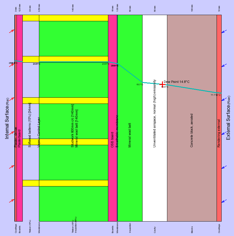

EquiumDuo Posted October 22, 2020 Share Posted October 22, 2020 Hi All, I've scoured lots of threads and I don't think I am doing anything extraordinary. But I have some questions. This is going to be the wall of a regular 4x bedroom house, rectangle shaped. Nothing too exciting. I've attached 2x photos, one is the wall make up: 12.5 mm Plasterboard Service Void 25/34mm (tbc) Vapour Control Layer (Dupont Airguard) 140mm Studs (filled with 140mm Rockwool Flexi) 19mm (tbc) OSB Permeable Membrane (Tyvek Housewrap) 50mm Cavity Partial Fill (Rockwool High Perf Cavity Fill) 50mm Airgap 100mm Dense Block External Render Nothing groundbreaking and mostly based on advice I've read here and the rockwool catalogue (plus some youtube videos). Please correct any mistakes, but this is what I'm looking at for the build. My main questions are: 1. A lot of suggestions for PIR boards (Celotex is mentioned often) to go in the cavity between the frame and the blockwork, but that doesnt make sense to me, PIR/foam boards seems air tight the way they should be layed out, whats the point opf a permeable membrane and rockwol etc to allow moisture out if you are going to put an insulated bin bag over the top? I'm literally imagining a wicking sports top, a hoodie and then a bin bag. You won't be very dry in that scenario. Is my analogy wrong or am I missing something? 2. With regards to the joists, I want to use engineered metal web joists (eg posi joist) between ground and first floor, how do these interact with the vapour control membrane and the permeable membrane? Looking at my second picture, is that how it all sits together? There would only be a small OSB/stud gap essentially between the end of the joist and the permeable mebrane, or is this just accepted as a comprimise? 3. For those of you choosing to go stick build yourself, how are you designing the walls/timber frame. Are you getting detailed plans from your architects? Are you buying a Haynes Manual or some other source? My google-fu is letting me down here. Thanks for your time. Link to comment Share on other sites More sharing options...
Thedreamer Posted October 22, 2020 Share Posted October 22, 2020 1 hour ago, EquiumDuo said: Hi All, I've scoured lots of threads and I don't think I am doing anything extraordinary. But I have some questions. This is going to be the wall of a regular 4x bedroom house, rectangle shaped. Nothing too exciting. I've attached 2x photos, one is the wall make up: 12.5 mm Plasterboard Service Void 25/34mm (tbc) Vapour Control Layer (Dupont Airguard) 140mm Studs (filled with 140mm Rockwool Flexi) 19mm (tbc) OSB Permeable Membrane (Tyvek Housewrap) 50mm Cavity Partial Fill (Rockwool High Perf Cavity Fill) 50mm Airgap 100mm Dense Block External Render Nothing groundbreaking and mostly based on advice I've read here and the rockwool catalogue (plus some youtube videos). Please correct any mistakes, but this is what I'm looking at for the build. My main questions are: 1. A lot of suggestions for PIR boards (Celotex is mentioned often) to go in the cavity between the frame and the blockwork, but that doesnt make sense to me, PIR/foam boards seems air tight the way they should be layed out, whats the point opf a permeable membrane and rockwol etc to allow moisture out if you are going to put an insulated bin bag over the top? I'm literally imagining a wicking sports top, a hoodie and then a bin bag. You won't be very dry in that scenario. Is my analogy wrong or am I missing something? 2. With regards to the joists, I want to use engineered metal web joists (eg posi joist) between ground and first floor, how do these interact with the vapour control membrane and the permeable membrane? Looking at my second picture, is that how it all sits together? There would only be a small OSB/stud gap essentially between the end of the joist and the permeable mebrane, or is this just accepted as a comprimise? 3. For those of you choosing to go stick build yourself, how are you designing the walls/timber frame. Are you getting detailed plans from your architects? Are you buying a Haynes Manual or some other source? My google-fu is letting me down here. Thanks for your time. How come you want to put glass wool in the cavity? Your set-up seems pretty traditional, therefore it would be unusual to have glass wool after the membrane. Usually the cavity for a timber frame is kept clear, unlike a block & block build. Why not just go for a upper glass wool product such as Frametherm 32, I used a mixture of 32 and 35. 32 is much more superior. Frametherm is a lot easier and nicer to work with than PIR. I used both. If I could go back I would use even more glass wool. We stick built our house, I have a blog here that might be of some interest. https://forum.buildhub.org.uk/blogs/blog/28-druim-nan-darach/ The spec was done by our house designer and a structural engineer. I deconstructed both plans into a bill of quantities and ordered pretty much all the materials myself. Recommendations on manuals, books etc Home Builder's Bible covers a lot and gives a broad overview of self building. Link to comment Share on other sites More sharing options...
EquiumDuo Posted October 22, 2020 Author Share Posted October 22, 2020 Thanks for the input, I was looking at a very well insulated house. And following some guidance on youtube videos. Lots of the american guys in the northern regions use these rockwool bats on the outside of the tyvek housewrap. The rockwool is breathable so the idea being it is permeable to moisture but resists the temperature gradient and adds more sound insulation. Also puts a fire barrier between the outside and the inside fo the building. Which is a nice to have (not really needed for me though). Also according to this website https://www.changeplan.co.uk/u_value_calculator.php The difference between with and without the outer mineral wool is 0.19 (with) and 0.25 (without). Is that significant? Thank you for the blog link, currently getting throuigh ProDave's blog atm. I also do have and am chugging through the home builders bible, really good book but it is quite dry at times Any thoughts on how to route the mebranes around the joists? Link to comment Share on other sites More sharing options...

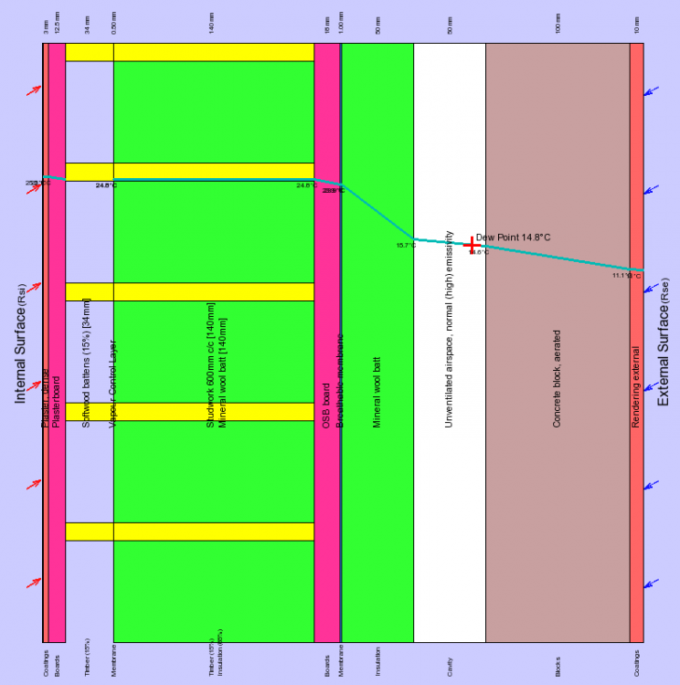

Hobbiniho Posted October 22, 2020 Share Posted October 22, 2020 Up here in shetland the "standard" timber frame would be similar to your build up except without the rockwool in the cavity, keep the cavity clear. However i would put a layer of 50mm PIR on the inside of the studs this can double up as the airtight later and you can put a 25mm layer in the ingoes in to the windows Link to comment Share on other sites More sharing options...
the_r_sole Posted October 22, 2020 Share Posted October 22, 2020 Get the mineral wool out of the cavity and put some rigid insulation on the inside of the kit panel. Check the joist manufacturer details for the fixings, most of the ones I've seen are on hangers rather than built into the wall like you've shown... engineers will give you panel drawings, although it's not rocket science! Link to comment Share on other sites More sharing options...
Hobbiniho Posted October 22, 2020 Share Posted October 22, 2020 Also what you have drawn in the second drawing showing the air tight layer is often called a " tony tray" Link to comment Share on other sites More sharing options...
ProDave Posted October 22, 2020 Share Posted October 22, 2020 I would seriously think of making the frame thicker to get more insulation in, as I did with my frame made of 195mm timber. Your floor joist detail. As has been mentioned, wrapping the air tight membrane around the joist ends is known on here as a "Tony Tray" You also need to enclose the ends of the joists with a ring beam all the way round the same thickness as the joists, mine were Glulam beams 300mm by 50mm. Link to comment Share on other sites More sharing options...
EquiumDuo Posted October 22, 2020 Author Share Posted October 22, 2020 Thanks guys, I wont be attempting this completely blind, the old man's a builder so will mostly be following his lead. But I am keen to make sure we've got the best solutions for our budget, so all your feedback is appreciated. The other source fo rockwool in the cavity was rockwool's own datasheet. Also I assume Tony Tray is good? I can't tell haha! Link to comment Share on other sites More sharing options...
Simplysimon Posted October 22, 2020 Share Posted October 22, 2020 i wouldn't be doing the joists like that, horrible cold bridge. put them in hangers on the inside face. as to a vcl if you use something akin to smartply propassive, it is effectively puncture proof, more expensive than poly sheeting but i would say considerably better. Link to comment Share on other sites More sharing options...
ProDave Posted October 22, 2020 Share Posted October 22, 2020 2 minutes ago, Simplysimon said: i wouldn't be doing the joists like that, horrible cold bridge. put them in hangers on the inside face. as to a vcl if you use something akin to smartply propassive, it is effectively puncture proof, more expensive than poly sheeting but i would say considerably better. Standard detail on most timber frames. It leaves the joist ends helping to support the upper storey timber frame and makes the joists very rigid. Yes, it gives you a cavity that needs filling with insulation but that is straightforward if a little tedious, and a good place to use up insulation offcuts. Link to comment Share on other sites More sharing options...
JamesP Posted October 22, 2020 Share Posted October 22, 2020 I have a similar build up to your own drawing except used 3 layers of Rockwool Flexi in my wall build up, 140, 70 and 50. Very good fit, easy to cut and not to toxic. . I had a 40mm layer of t&g Pavatex on the outside. No blockwork, just cladding. The first floor joists sit on the walls, no joist hangers with a similar detail to your original drawing. Very solid, no squeaks or movement. I felt it provided a very stable platform to add the first floor walls. Have fun. Link to comment Share on other sites More sharing options...

EquiumDuo Posted October 26, 2020 Author Share Posted October 26, 2020 This is the exact thinking that drove me to the design i chose. I think we can all agree that mineralwool/rockwool is moisture permeable, Looking at my wall layout, there is the hard line dupont airguard on the inside, and all breathable insulation outwards. I don't personally see the logic of adding insulation to the inside of that dupont airguard. In my mind that airguard is the boundary layer between what is considered inside and outside of my home. Insulation internally is driven primarily by acoustic performance after that. Not that I am not considering all your suggestions very carefully. I've modelled a lot of your ideas and its really interesting. I really hate the idea of the dense block because honestly I dont even see a point to it anymore, BUT thats very uncommon in my part of wales, so not sure how the powers that be will think about it (its even mentioned in the detailed planning as a condition of the external render look. "Textured render on dense block" Link to comment Share on other sites More sharing options...
