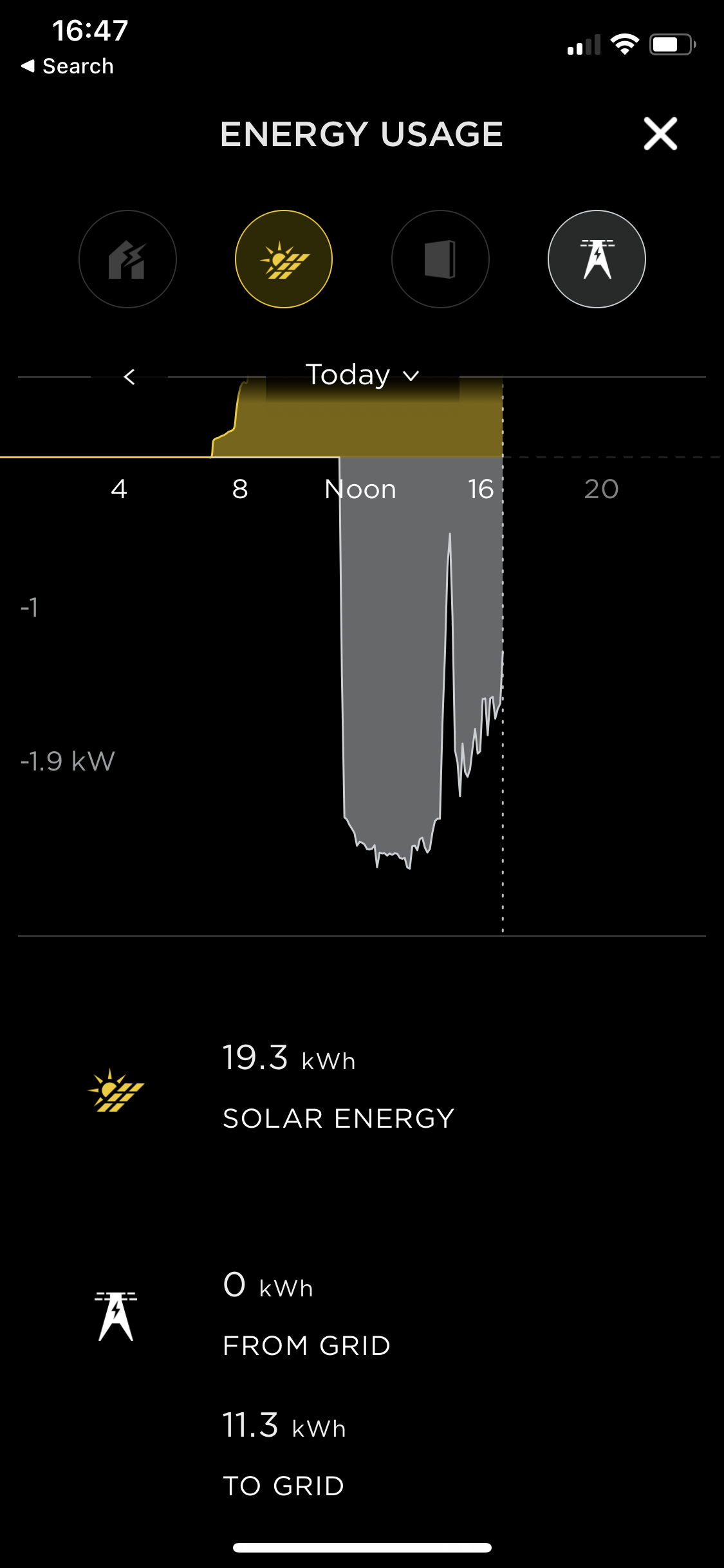

Stonking it today !
Battery full , car full - giving some to you guys ?
5 minutes ago, ProDave said:
The difference between an occupied and empty house?
About 14kWh generation here, almost all self used.
What size is your PV?
House not occupied at the moment so some low electric use for Cctv , ufh , ashp .
Pv 4kw
