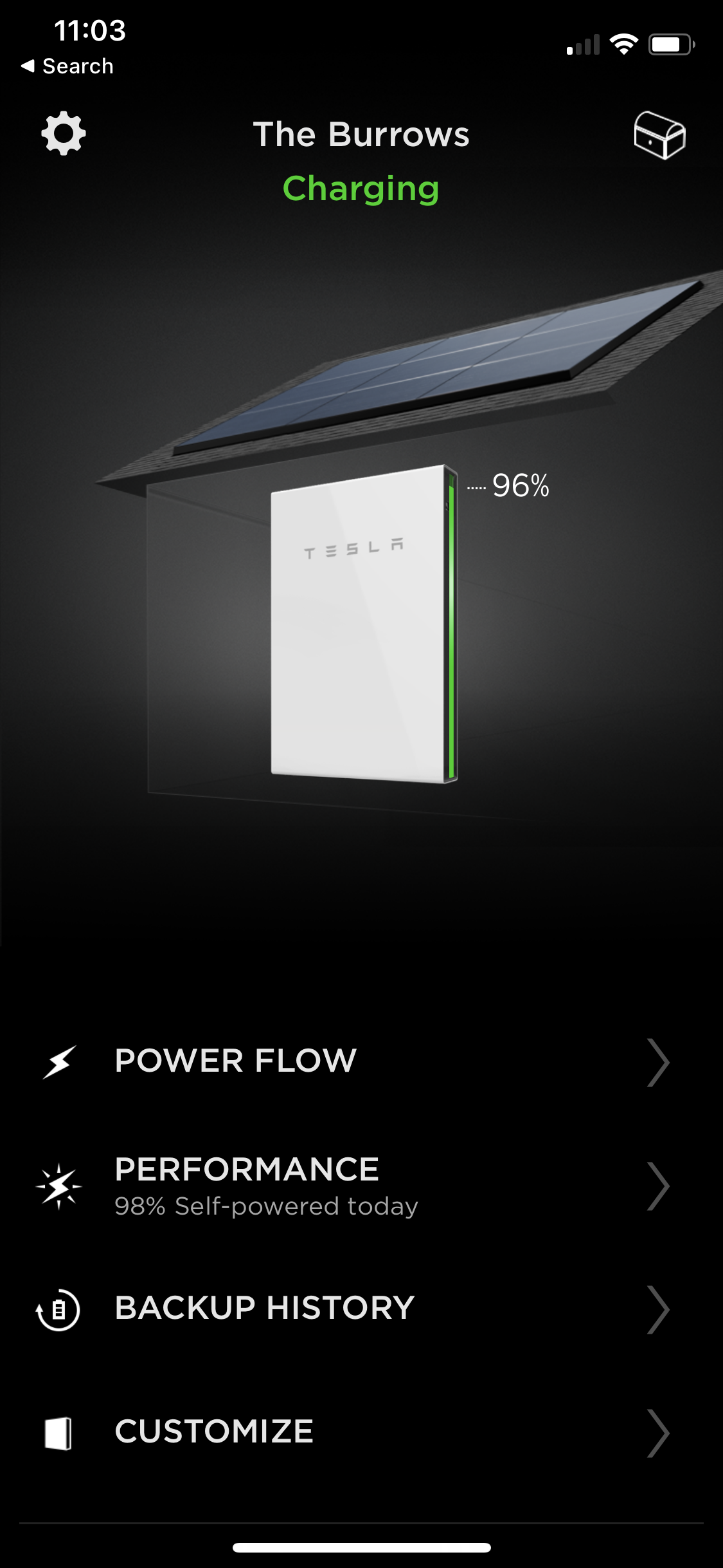

Batteries almost full again so will be helping you guys out soon ! ????
Where is all your power going. At this time if year, and with the clear skies and cold wind, you will be getting pretty close to peak production.
Does not bode well for when you move in and you have all your electric toys plugged in.

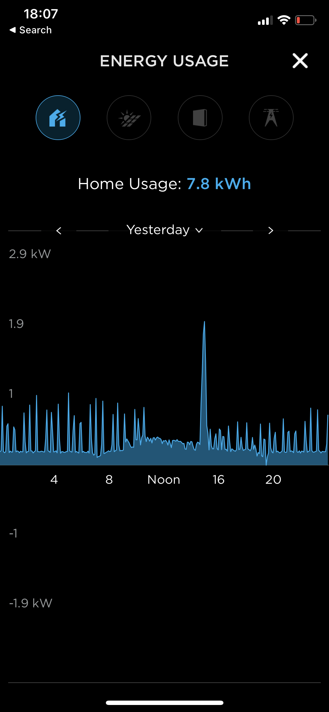

Consumption from yesterday . I assume most is ASHP and uvc
Probably, all very spiky isn't it.
I know it is not all commissioned yet, but is the ASHP cycling a lot?
And what is that large 'afternoon delight' spike' cameral lights?
looks like you need to use some of it to charge your phone! ?
Could be me running the shower and finding leaks
As an experiment, turn it off (ASHP) for a full 24 hours.
48 is even better.
Then see you next Tuesday.

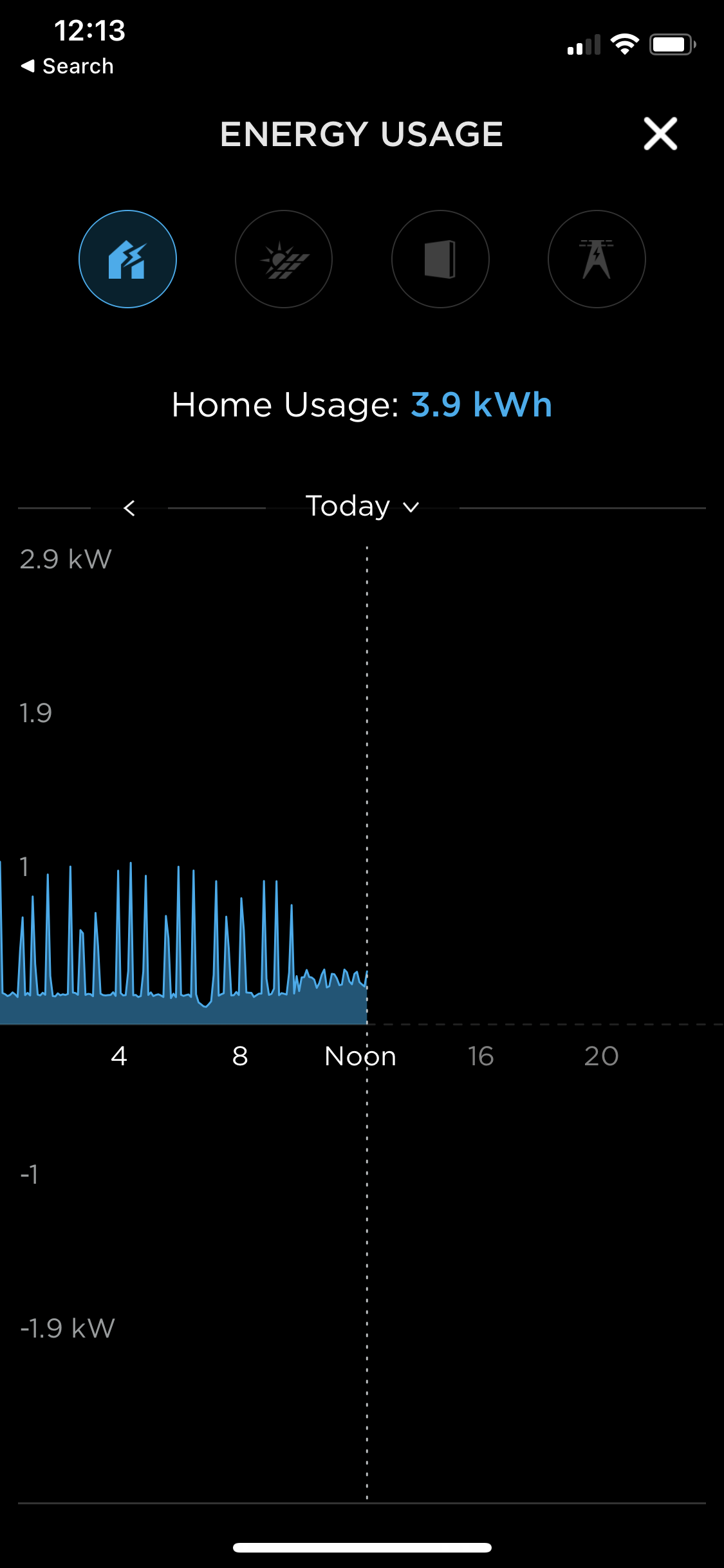

Looking remotely I can see it’s not ufh . So would guess ASHP and uvc are cycling . I seem to recall there was a buffer heating option which was on . Could that be the issue ? . Tomorrow I’ll turn off heating and hot water so expect consumption to drop
OT : Saw a white Tesla today and thought the reg was something like TE55 1AA but it doesnt show up on the MOT data base.
@SteamyTea just for you .
Spike gone !
What was it ? . I forgot I had a tiny floor area ( 6 sq m ) permanently on low for ufh ( to avoid condensation around my HA stuff ) .
Off now ?
