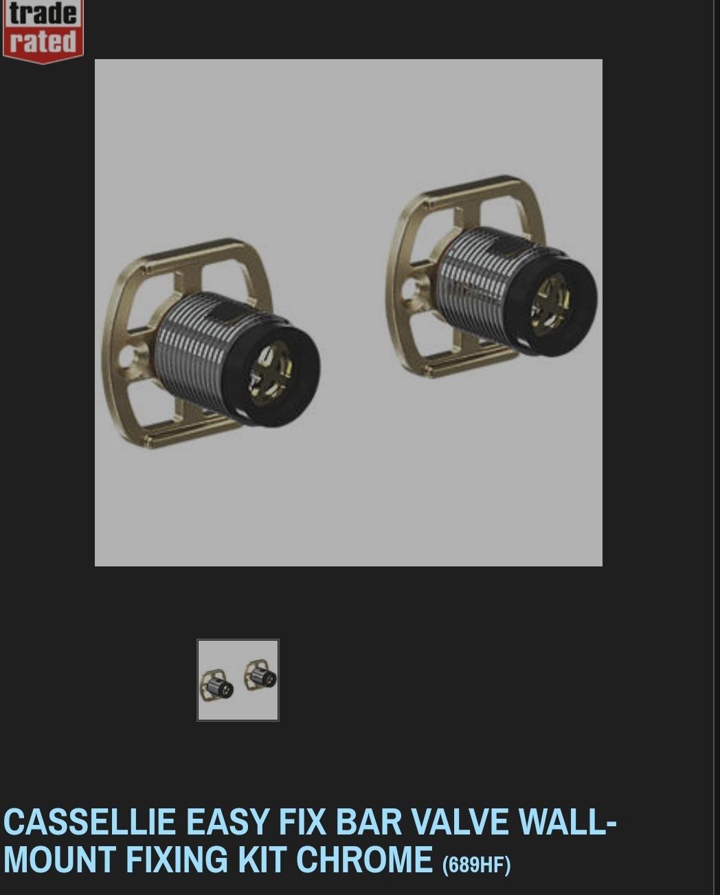

amavadia Posted October 17, 2020 Author Posted October 17, 2020 Yep this is the plan. To try and get the pipes at 150. I reckon I might be able to do it without removing tiles though.

Nickfromwales Posted October 17, 2020 Posted October 17, 2020 Just now, amavadia said: Yep this is the plan. To try and get the pipes at 150. I reckon I might be able to do it without removing tiles though. 100% don't remove any tiles!! That is a journey you really do not want to start....

ProDave Posted October 18, 2020 Posted October 18, 2020 The key thing I get from this thread is in future ask the forum BEFORE you start a job, then you would have known to get the pipes 150mm, bin the cranked bits, and drill the holes in the tiles slightly over size to give a bit of wriggle room. If you have access from behind, I would remove the pipes and uses something like a dremmel to grind a bit of tile away to elongate both holes by 3mm so you can get your 150mm spacing.
Onoff Posted October 18, 2020 Posted October 18, 2020 1 hour ago, pocster said: How many mistakes can you make before you should give up ? Asking for a friend ... Tell him he reached that trigger point a long time ago but like another idiot close to me just won't give up... 1
wozza Posted October 18, 2020 Posted October 18, 2020 10 hours ago, ProDave said: The key thing I get from this thread is in future ask the forum BEFORE you start a job, then you would have known to get the pipes 150mm, bin the cranked bits, and drill the holes in the tiles slightly over size to give a bit of wriggle room. If you have access from behind, I would remove the pipes and uses something like a dremmel to grind a bit of tile away to elongate both holes by 3mm so you can get your 150mm spacing. I used a mounting bracket for both of mine - even easier than the individual brackets. 1
amavadia Posted October 18, 2020 Author Posted October 18, 2020 All sorted. Thanks for all the replies. 2
PeterW Posted October 18, 2020 Posted October 18, 2020 Excellent !! Hope those holes were packed full of silicone before you put the bar on !!

LA3222 Posted October 9, 2021 Posted October 9, 2021 Bit of thread resurrection but need a sanity check before I go any further. Got a grohe shower with mixer bar to fit. At the minute I have 15mm hep in the wall. Reading this thread I believe the consensus is to bin the s union's supplied by grohe and to switch out to the fixings shown. So in the wall I will stick a 15mm hep elbow on the pipe going to 15mm copper into these bad boys. Anything fundamentally wrong/missed with this plan?
DIYER_straits Posted July 4, 2023 Posted July 4, 2023 @LA3222 I know this is quite an old thread now. I just wanted to check if you were successful with your plan as I am in the same situation now.
LA3222 Posted July 4, 2023 Posted July 4, 2023 2 hours ago, DIYER_straits said: @LA3222 I know this is quite an old thread now. I just wanted to check if you were successful with your plan as I am in the same situation now. I did it how I described above, the fittings I have been using are off amazon....I will dig out a link it a bit as I need two more to do my ensuite with.
LA3222 Posted July 10, 2023 Posted July 10, 2023 https://www.amazon.co.uk/Mounting-Valve-Fixing-Brackets-Shower/dp/B07KDVGPDB?pd_rd_w=GkL3J&content-id=amzn1.sym.99287ee2-be7b-47ac-a6c0-0ecc40c5b32b&pf_rd_p=99287ee2-be7b-47ac-a6c0-0ecc40c5b32b&pf_rd_r=CH79P9RQ37AJDRDV025Z&pd_rd_wg=tIaHp&pd_rd_r=07f07ee3-f4a4-4d2e-bb4a-37d73110e126&pd_rd_i=B07KDVGPDB&psc=1&ref_=pd_bap_m_grid_dv_rp_0_9_t
