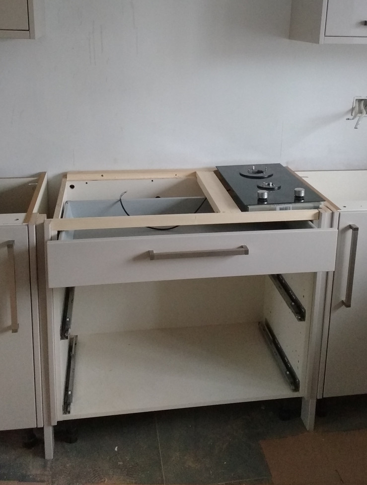

Hmm, interesting one. Is there any way that the support along the front could be a longer piece, built into the units either side? That would gain the advantage of becoming a built-in rather than a simply-supported beam.
Secondly, why CT1? I'd be more inclined to just bolt it together, or maybe epoxy.
Do the hobs sit on the unit frame or the work surface Terry? It looks like they will sit on the work surface, which in turn sits on the frame. In that case reinforcing the front rail as you suggest should give more than adequate support if it's a 30mm steel angle.
It should support the weight of a major pot of stew anyway!

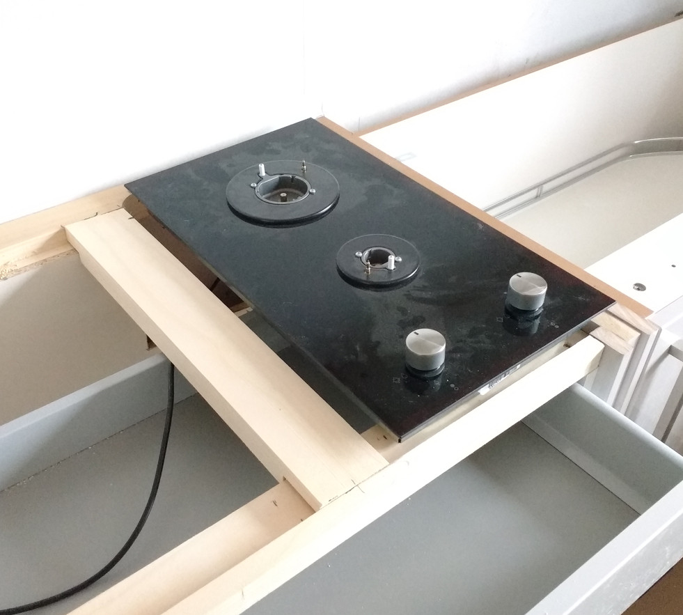

Richard, both hobs have a glass top surface which sits on the work surface.  The gubbins underneath is set back just about 15mm and hangs from the top surface and is 47mm deep.  The work surface is 30mm, so the gubbins drops down about 17mm below the bottom of the work surface.
So we will have a what is in effect a composite beam of roughly 50×50mm polyacrylate / polyester resin, 30mm wood faced in 3mm steel and a 3mm steel bottom plate.  Hopefully this will be stiff enough and strong enough under load to maintain the integrity of the worktop without subsequent  catastrophic failure.
Rob, I am continuously  bonding the wood to the steel because I want this composite beam effect and a hybrid polymer like CT1 is better for this.

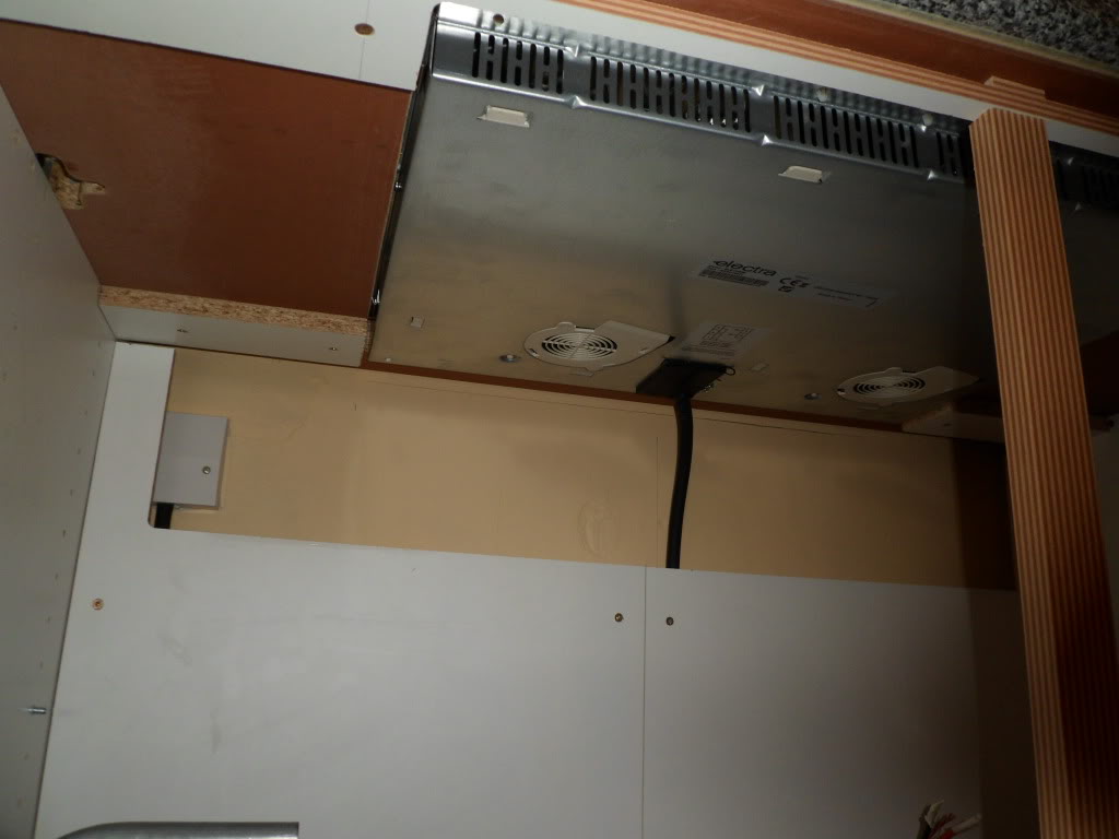

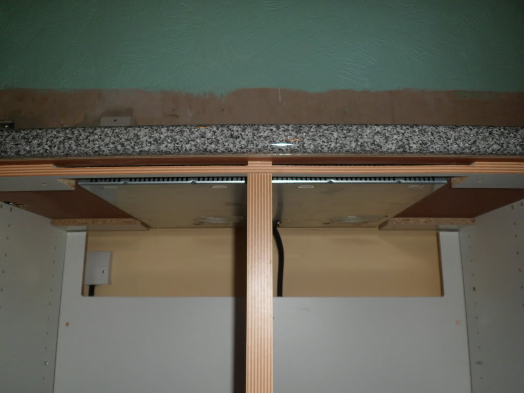

I ended up modding the hell out of one of our cabinets. Originally the induction hob was to go to the right, centred over where two cabinet sides meet which would have needed modding.
SWMBO then decided she wanted it dead centre of the 1000mm unit. Meant I didn't have to mod the cabinet sides BUT it put the hob switch closer than 300mm. As I'd run everything in 20mm steel conduit I WASN'T changing it! The back panel was halved neatly with extra battens added and comes out via a couple of screws.
I did route a 5mm gap in the horizontal member to allow better ventilation to the hob.
@Onoff, we've got full with drawers under the twin hobs.  If my design authority would allow me to remove the top one and put in a dummy then it wouldn't be a problem.  xD
Sorry bit late to this thread but I would do exactly what you suggested. Either that or a "flitch" beam construction (steel strip between two timbers).

I'd get a simple aluminium plate say 120 x 500 x 4mm and bond this to the underside of the two pieces of worktop.
Use sikaflex as it's a better adhesive than CT1 imo, full bed on both surfaces combed at 90 degrees to each other for 100% bond / contact. Clamp the front and back whilst curing and it'll be like one piece.
To compliment this, run an Alu angle behind the drawer unit ( front top rail ) again bonded with sikaflex.
Combined with the resin, to complete the gap filling in the actual worktop material, I'm sure this will be sufficient.

BTW, the steel 30×30 angle worked fine.  I used steel rather than Alu because of availability / lead times.
