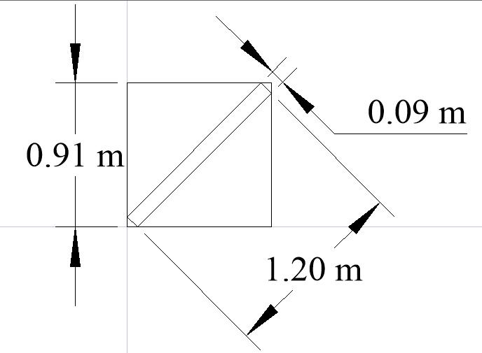

dnb Posted September 30, 2020 Posted September 30, 2020 The diagonal of a 3 foot square hole is 4 foot 3 inches. Guess that ladder is coming out again... 1
Mr Punter Posted September 30, 2020 Posted September 30, 2020 1 hour ago, dnb said: The diagonal of a 3 foot square hole is 4 foot 3 inches. Guess that ladder is coming out again... Anyone fancy calculating the maximum viable board thickness? Or do you have better things to do? Insulation board is normally metric 1200 x 2400.
dnb Posted September 30, 2020 Posted September 30, 2020 (edited) @Mr Punter Assuming the loft hatch is similarly metric, therefore 900mm (it allows space for fingers if it isn't metric) then the thickest 1200 wide of standard size board would be 70mm. 75mm is a little too thick unless you don't mind rounding off the corners or the board is at the low end of the manufacturing tolerance. Do you need to see working out? ? Edited September 30, 2020 by dnb 1
