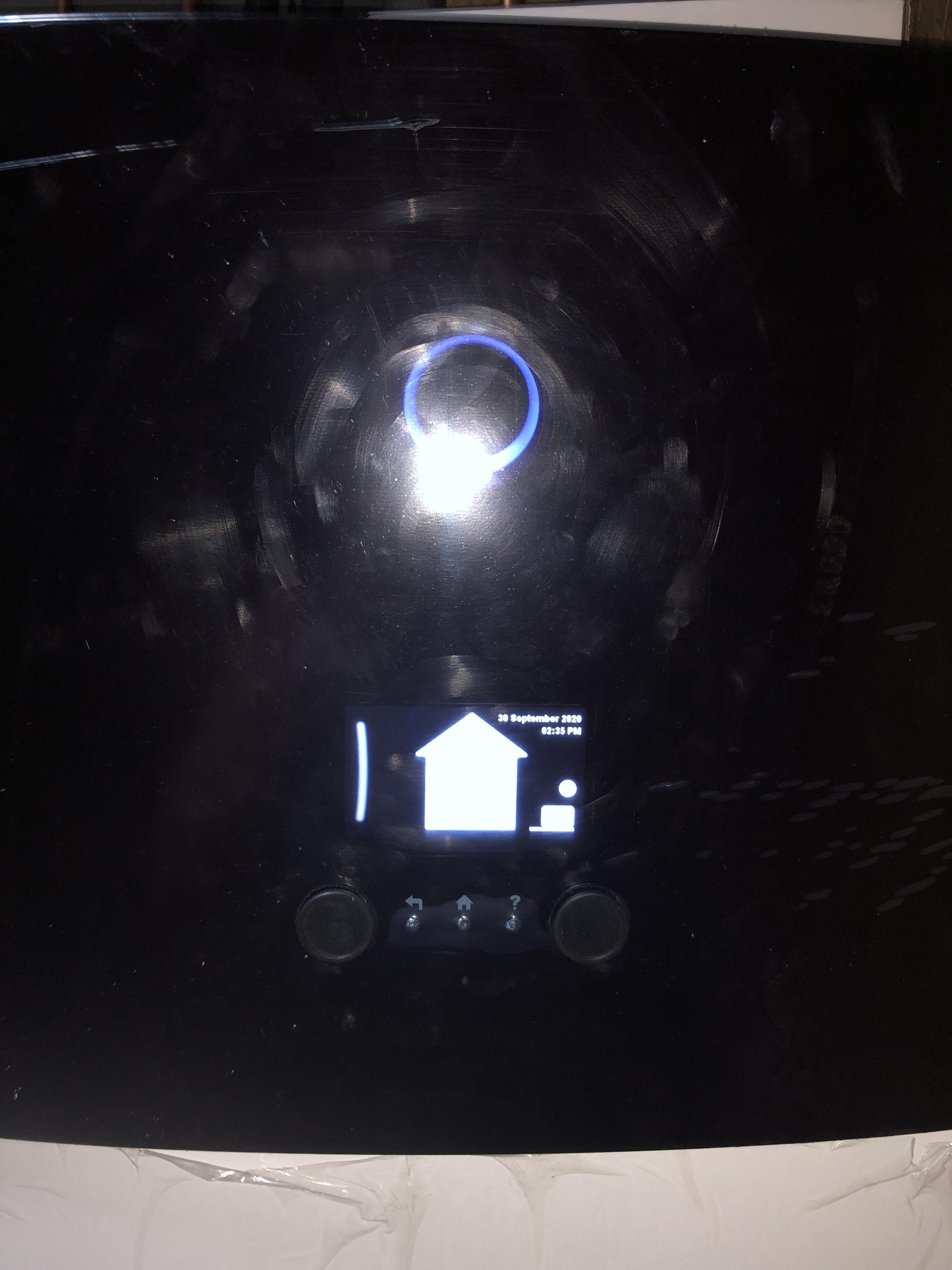

zoothorn Posted September 30, 2020 Posted September 30, 2020 On 27/09/2020 at 12:02, rbw said: Interestingly both Daikin and LG do quote sound levels for their indoor units, both at 28dB. No idea whether this is what is achieved in real world usage though. Thats very interesting.. lord if only Vaillant had: I have the ideal spot, well away from beds, I could have asked for my boiler/cylinder to be put!! I'm renovating it same time it was all installed! Im furious. As to your OP header 'what problems', after a 3+ hour call to Vaillant (yup) I realise -another- problem with this system, certainly for me: regardless of the time settings block periods you can input for both heating & HW to come on between.. the heating comes on anyway. Day and night. Its just intrinsic to how the system works now I'm just told. IE right now my next block heating period is 6pm to 8pm. But the rads are on (& noise as I said too). I cannot possibly afford to run rads constantly during the winter, but it overrides my decision to ask them come on for 2 hours am & pm... & puts the rads on any time during 24 hr period too (& never when I know when)!! so I am on constant tenterhooks now about this noise.. which is nigh on constant right now (& its mild outside). An utter disaster for me. I have had to agree to a £95 call out engineer on monday, altho its under guarantee, bc I have absolutely no other option (in case/ slimmest chance there -is- a problem with my boiler re. noise.. tho I know as its an electric pump doing it inside, its just highly likely the way its made/ nothing can ever be done to diminish it). Ruining my life this.
zoothorn Posted September 30, 2020 Posted September 30, 2020 On 28/09/2020 at 21:56, dpmiller said: I don't understand why the compressor isn't in the outdoor unit tbh... It is, & this is a pump.. but its not the pump I'm referring to. Once it enters the house boiler via the high presssure pipes (eminating from the outside compressor- introducing noise into the house this does itself via these 2 big vibrating pipes), there's a pump in the boiler > pushing I assume the water into cylinder. This is the primary culpit. ProDave is spot on as usual with his reply above. Lord alive I'm in such a pickle here. That's all I'll say as I've hijacked rbw's thread enough already. zoot

zoothorn Posted September 30, 2020 Posted September 30, 2020 (edited) 9 minutes ago, Onoff said: You maybe one of those unfortunate people who are acutely sensitive to the vibrations of the dilithium crystals inside ASHPs. A strapadictomy might cure it. I'd ask the engineer when he comes. No. I am not. I fall asleep in front of my hfi belting out, or dvd menu music blaring out I snooze thru & I wake at 2 am on sofa/ being middleaged now I snooze alot etc. As to a stridectomy I'll hav to look that up on the vaillant site. As the moment what I need is a lobotomy. But you'll say Ive already had one Onoff (before you type it). Edited September 30, 2020 by zoothorn
zoothorn Posted October 1, 2020 Posted October 1, 2020 Sorry to harp on.. but more noise issues with my split ASHP. For some reason I'm noticing -alot- more outside compressor noise (the box outside) so much that I can hear it all around my house exterior in fact & very irritating too, 20m away its intrusive for eg, in one spot as its a vibration thing there are resonant frequency 'patches' where its really prominent. the fan is fine. Also some of this noise is being transmitted out & in through the windows (a floor above it) into my upstairs. So I have this damn compressor noise entering my house A) via pipes > boiler > transmitted along pipes > to cylinder, & now B) externally up & in through window. And a motor within the boiler noise too, totally separate/ often both in conjunction. Right now in kitchen I have an incessant background drone & its unliveable with. And the frequency of the damn thing firing up/ off/ on/ off will only ramp up when its cold.. its fairly mild now. Omfg.
