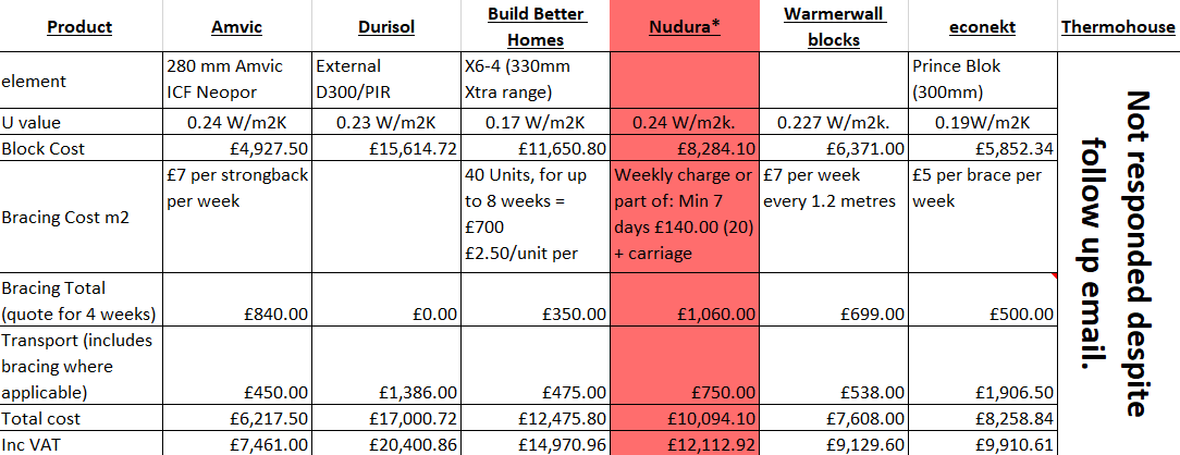

bradders3109 Posted February 4, 2021 Share Posted February 4, 2021 12 hours ago, Andy H said: distribution cost from Poland Andy I understood that Thermohouse was from Ireland but maybe wrong. Izodom are from Poland and you are quite correct the shipping costs are nearly £2000 but the block price counter balances this. My concern is that they don't have BBA certification as they are covered by EU certification. I've emailed my local building control to see if this is an issue with us having left the EU. My Durisol quote came in and was double the most expensive EPS block and three times the cost of Izodom (Not including the shipping costs). Link to comment Share on other sites More sharing options...

bradders3109 Posted February 5, 2021 Share Posted February 5, 2021 My compiled quotes are as below: *Nudura are requoting because there is now an additional wall to be constructed in ICF. I will post the new quote when it comes in. The amount of concrete required varies between 21m3 and 24m3. This is either down to misinterpretation of the drawings or different size cores in the ICF. The build is an extension to a detached house as per the attached diagram with ICF highlighted in blue. ICF Design.pdf Link to comment Share on other sites More sharing options...
Sree Posted February 11, 2021 Share Posted February 11, 2021 On 17/09/2020 at 12:49, ZacP said: So all of the ICF quotes are in. I've tried to standardise them as much as possible, but some have interesting notes which I'll detail below. Putting this up for others who might find it useful in deciding their supplier or working out costs, but also for any feedback or thoughts from the more experienced (that's all of you!). Our build is approx 220sqm footprint and 260sqm of wall. Durisol includes a 22% discount that they put on without negotiation Beco Walform have quoted for the 375 but say the 313 would save around £8K (inc vat) and only increase the U value to 0.165 (though the published value is 0.18) so much better value Nudura say that a U value of 0.24 is plenty and anything more gets really expensive Velox includes the steel that goes inside the wall. I've included a price of concrete at £100+vat/cbm. This is a little on the high side, but it gives comparison. None of the quotes include rebar (if required [except Velox]) - would have to wait for SE calcs. Can anyone suggest an amount (in £ or quantity) that they used on their build? I know that we'll be able to reclaim the VAT on a new build but were costing things as a worst case scenario. Labor to construct I'm guessing at 9 days for 1+1+me: 2 days build, 1 day pour (lower ground). 3 days build 1 day pour (upper ground). 1 day build, 1 day pour (gables, finishing off etc). Hope that helps someone and thanks for your thoughts! Hello, I’m planning to extend my home by about 1200 sq ft per floor. Planning approval submission is next week. I’m project managing it and don’t plan to DIY anything but the painting job so will be relying on subcontractors. Most probably will go the ICF route and have been in discussions with Nudura rep and their contractors. I plan to reach out to Amvic this week. My architect & his structural engineer partner are unsure about ICF so I need to find a structural engineer who’ll do this. The ICF system cost comparisons here is very useful. Has anyone done any comparisons re ICF vis-a-via insulated brick and block cavity wall? I’m not inclined to use cavity wall construction mainly to avoid “drama” from tradesmen but don’t want to be shocked later if it turns out to be more cost effective. Link to comment Share on other sites More sharing options...
