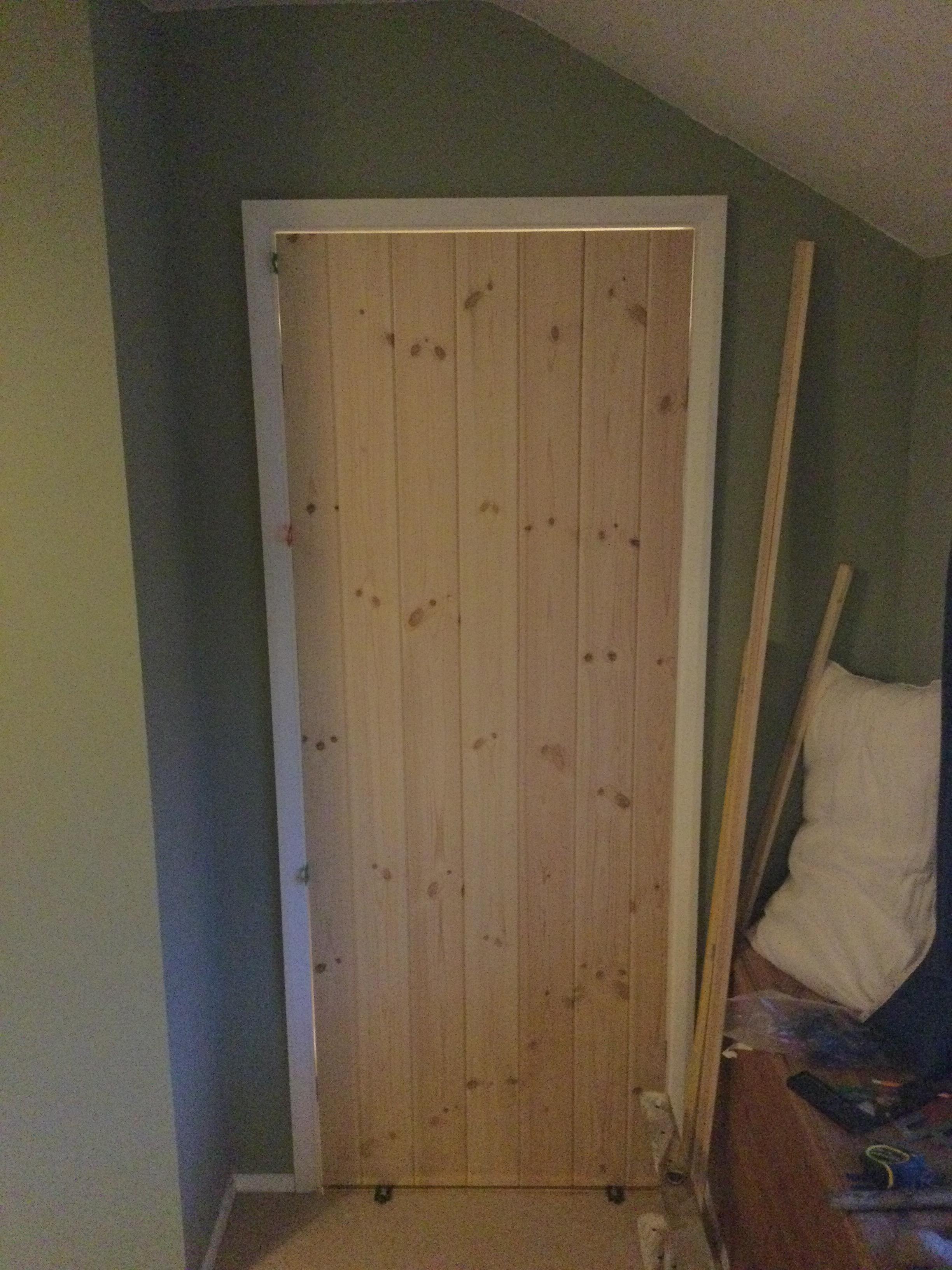

Can anyone advise here. door in position & Im happy about its size to frame: 2mm gap to frame --LHS here-- hinges side ( 1mm  gap @  2/3 rds way up, a slight bow in of frame here), 3mm gap above & @ rhs (latch side) nice even gaps here.. then lastly below: door hopefully skimming carpet opening in this side.
plant on strips not yet fixed, so door resting on 4 x temp stops, wedged in around.
I got a few issues. First is my door pulls out a bit, so there's a slight warp in it, top rhs as we look at it here, 5mm or so. So the door wont close flush onto the temporary stop behind, set in exactly 20mm as per door depth.
Then I have where to position hinges, specifically where on the frame to attatch them. I know i asked this before, but now 1 st time I have door in final position, where they can possibly attatch to isn't quite so easy to see.
thanks zoot.

Im assuming that is a ledger and rail door so the hinges should go on the rails..
If its a bit bowed or warped - could be made into it or just drying/settling, loosen the screws holding the rails and ledgers, push the door into the frame and then re tighten the screws, it should then stay put.
Ive got the positions on the door where the hinges go, up and down, on the 3x ledges I see on all the www eg's and makes most sense due to structurally thickest on these 3x ledges across.. but its how far inwards the hinges go on the door, when to fix them on, if ive got to also fix them to the frame, & where on the frame to fix them.
I cant undo any of the door as the ledge and braces are glued & screwed. So its really whether I just set the plant on strips to follow this warp, or, do I just pull the door closed forcing it in slightly onto the plant on strips set where a non warped door would sit 5mm in. Or is this 5mm warp normal to expect on such a homemade door?
thanks.
