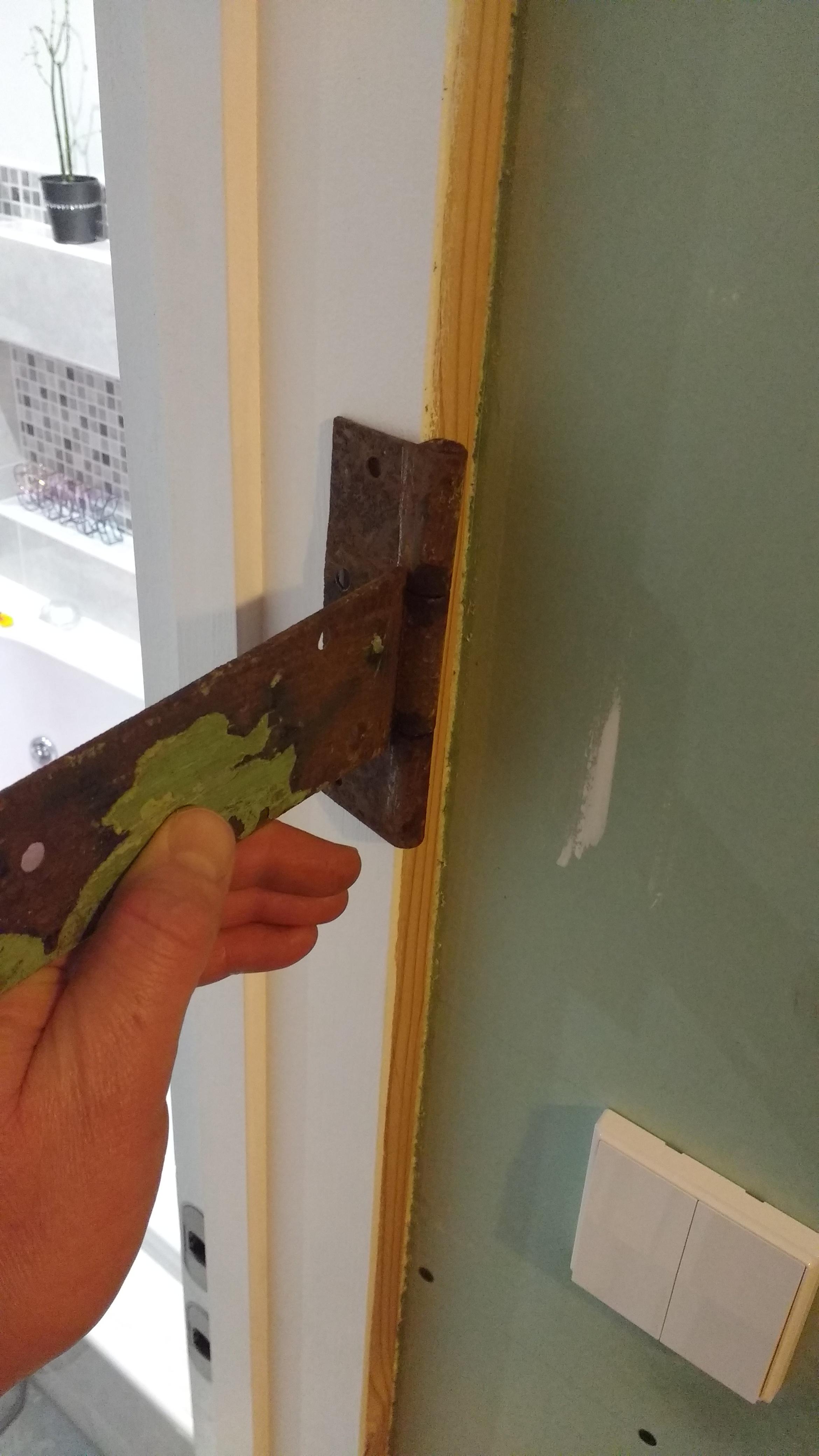

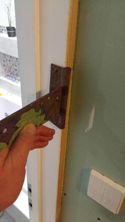

Ive got my door as photo above, in position, gaps all good. So I'm ready to get my hinges fixed. The only way I can see of doing this, as my architrave prevents me attatching hinge to this frame edge, and also, bc even if I could my screws would be almost at the periphery of the frame here.. is to fix like joe's idea, on the inside face of the frame. So actually I'll have to cut a bit out from my plant-on.. or maybe add plant-on over it I just thought of course.
So I need to chisel out a recess for the hinge. That's fine. What is tricky tho is using the hinge plate 'back side' this way (on the frame). And the weight of my door is alot it seems, whether I need to be very specific about the screws chosen for these 3x fixings (into the 'back' of each hinge plate as it were), if I need to sit the hinge on a "shelf" for support within the frame, IE my chiselled reccess bit. Should the screws' shafts be as wide say as the hinge holes? thats a big 6mm hole.
Then I can only think, in order to get the hinge in correct position on the door face, I gotta attatch hinges to frame 1st > put door into position with wedges etc back like it is now > fix hinges onto doors. IE do it in reverse-way to your suggestion/ usual way iirc, of fixing hinges to door 1st: If I did it this way, Id never get the hinge position correctly onto the frame.. unless a big fluke.
And lastly, have you any idea what I'm talking about-? thx zH
For a change YES!
The hinges need to sit dead centre of the rails, the end. First thing I'd project centre lines onto the door face in light pencil.
Is the architrave on and fitted? I'd have left it off and set it back a bit from the jam so you don't have to chisel it out.

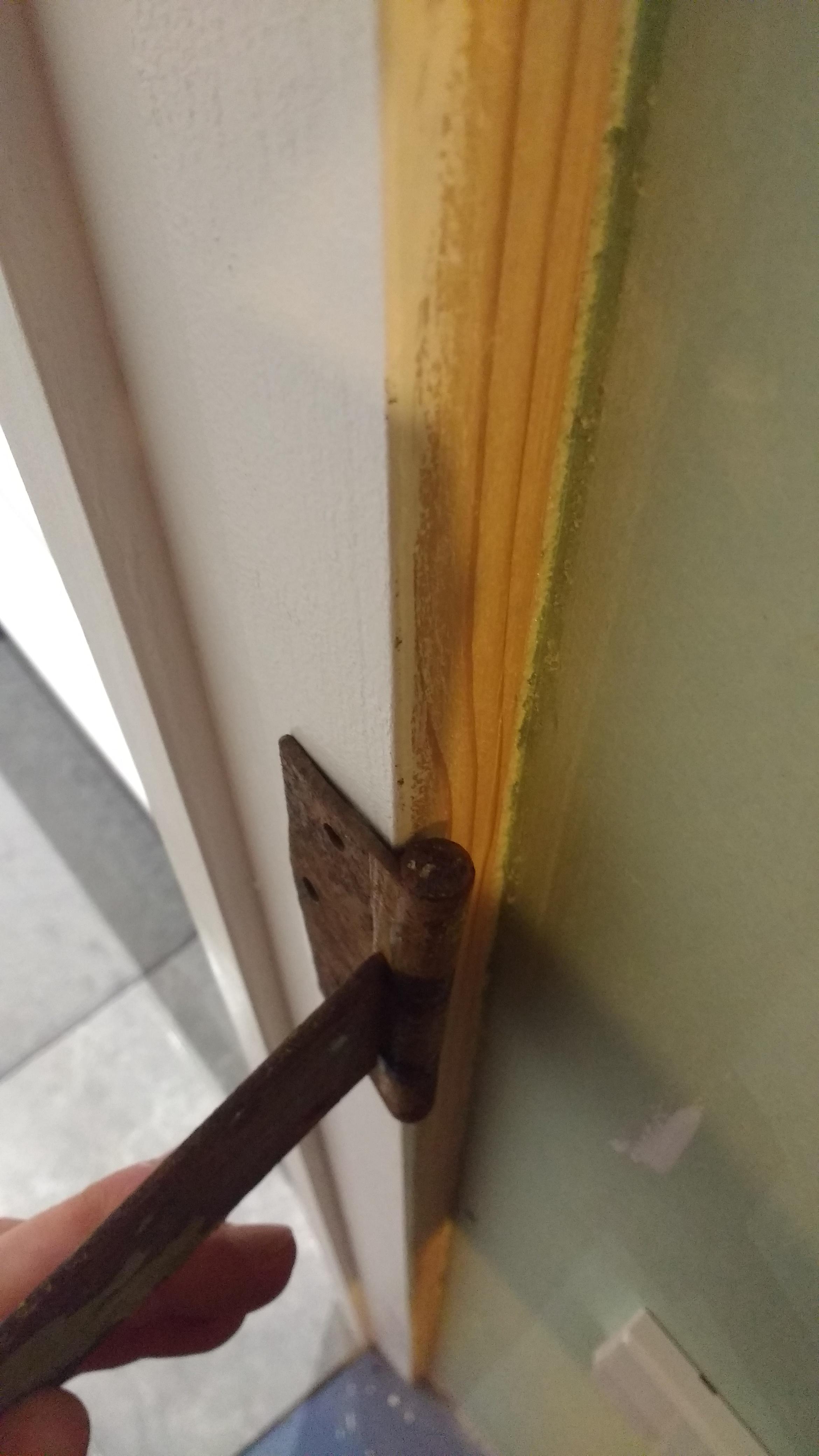

Correct me if I'm wrong but your hinge has to go like this:
(My hinge is bent to buggery btw):
Now one problem you have is that I imagine like this sh!tty old hinge the countersunks are only one side? I'd not think too hard about this, just use round head screws where it attaches to the jam. They'll push into the door edge a tad, so what. See where they mark it and drill a little recess if necessary for each screw head. It's called compromise!
How thick is the door plus the rails?
Screws: What is the hole size in the hinge? Use a twist drill to gauge this.
I'd wedge the door in with the right gap at the bottom so it clears carpet etc. Then slide the hinges up, opened like in my photo so they are on the centre line. Mark where they are going to go. Remove the door and cut out for the hinges. Ordinary hinges but principle's the same:
20190530_191933

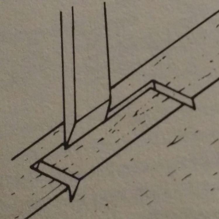

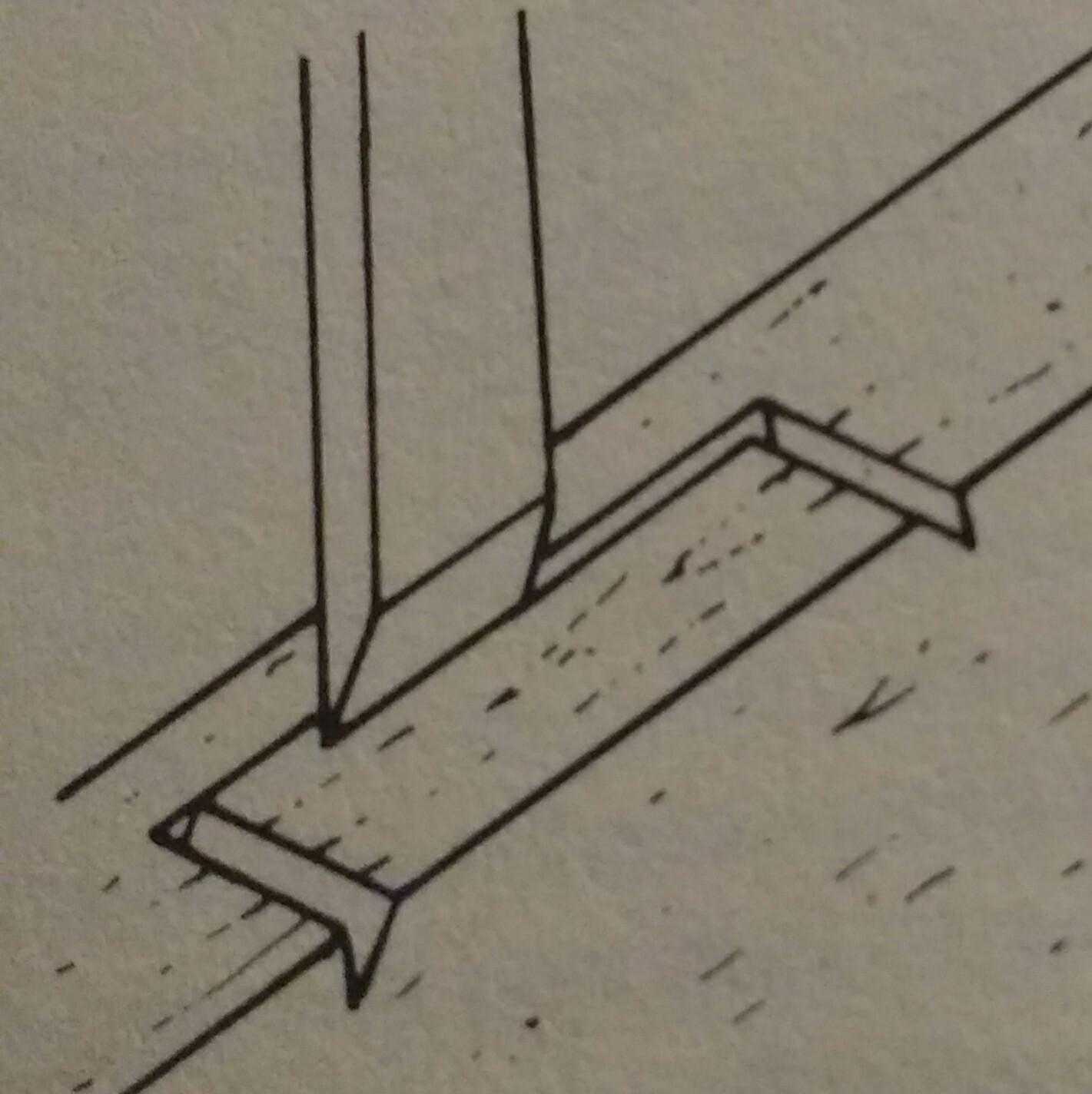

When you mark out use a chisel like below:
20190530_191543
If you f*** up drilling the holes then PVA in matchsticks (more than one if required), cut off level and redrill ?:
20190529_213958
20190529_214223
Having the screw heads all rotated the same way looks nice imo:
20190530_185518
Get on with it!

Top tip when chiselling out for hinges. Make sure the bevel faces the waste side. This should ensure you cut to the line and not over it.
