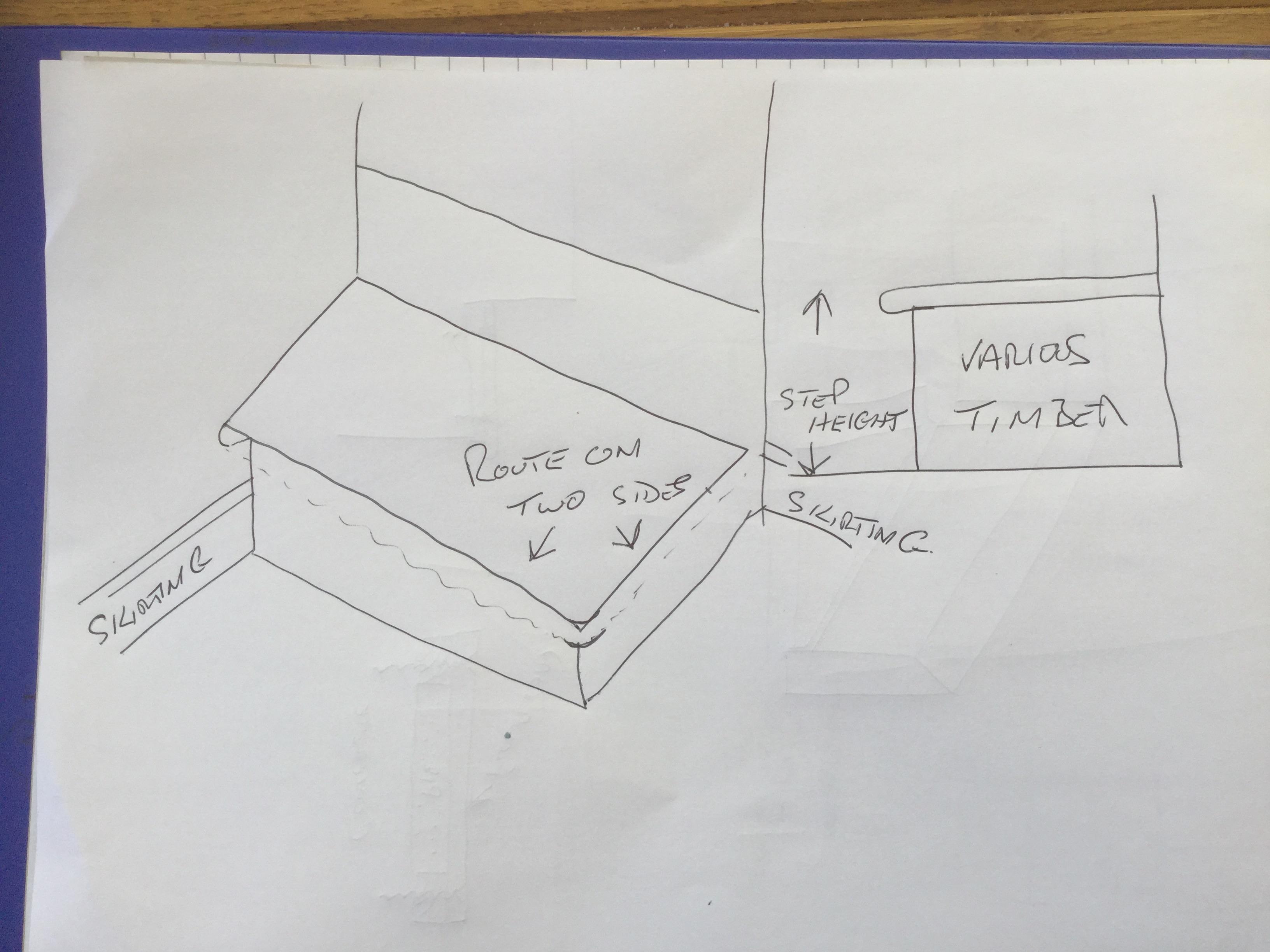

joe90 Posted September 26, 2020 Share Posted September 26, 2020 2 hours ago, zoothorn said: how to make the lower 1st step (on the caber floor) so that its RHS is 'acceptable', as it will be seen. Do I clad it in something, skirting an option for here? No, skirting on walls only, make up height with any timber, step from 18mm caber or similar, bigger on front and RHS BY 25mm then route (if I remember correctly you have a router?) from the top and below before it’s fixed. Link to comment Share on other sites More sharing options...

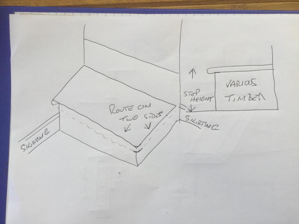

zoothorn Posted September 26, 2020 Author Share Posted September 26, 2020 @joe90 really appreciate your sketch joe, very helpful. Is the suggestion to square-edge rout the top edges > then add something like Peter's trim suggestion? (he replied just after your sketch). or rout the edge with a 18mm bullnose bit I don't have. I do have a 1/4 roundover I use for my amp cab edges.. maybe flip the top over & make do with whatever this might be called (a zoot bell end probably). My lowest new step LHS differs from yours in sketch.. my wall is set away from this step 6" or so: I assume leave a gap, & I skirt just one tiddly bit along wall here to butt up to the step (pain to carpet here but so be it I guess).. IE.. Not just make the lowest step wider than the others LHS so it meets the side wall-? Link to comment Share on other sites More sharing options...
joe90 Posted September 26, 2020 Share Posted September 26, 2020 1 hour ago, zoothorn said: rout the edge with a 18mm bullnose bit no, route with a 9mm rounding over bit, first from one side then turn over and do the other, you end up with a bull nose which goes around the front corner. 1 hour ago, zoothorn said: My lowest new step LHS differs from yours in sketch.. my wall is set away from this step 6" or so: I assume leave a gap, & I skirt just one tiddly bit along wall here to butt up to the step (pain to carpet here but so be it I guess).. IE.. Not just make the lowest step wider than the others LHS so it meets the side wall-? if it were me I would run the step right into the corner to stop you having a silly corner to get skirting into. Link to comment Share on other sites More sharing options...
zoothorn Posted September 27, 2020 Author Share Posted September 27, 2020 16 hours ago, joe90 said: no, route with a 9mm rounding over bit, first from one side then turn over and do the other, you end up with a bull nose which goes around the front corner. if it were me I would run the step right into the corner to stop you having a silly corner to get skirting into. Ok I'm actually thinking its only one small 6" bit of skirting needed (if I were to make lowest step same W as others).. &you see Ive put a 45* mitre on the long wall skirting this bit would meet. I can make it a cm less so it goes in & it won't really be seen.. it just means a fiddly 6" like 'chimney' of carpet to fiddle into this bit.. which won't be my job. I think maybe this way is easier for me. Ok understand the 9mm roundover idea/ I will see if I have one. Thanks- making these 2 steps today, if I can.. Link to comment Share on other sites More sharing options...

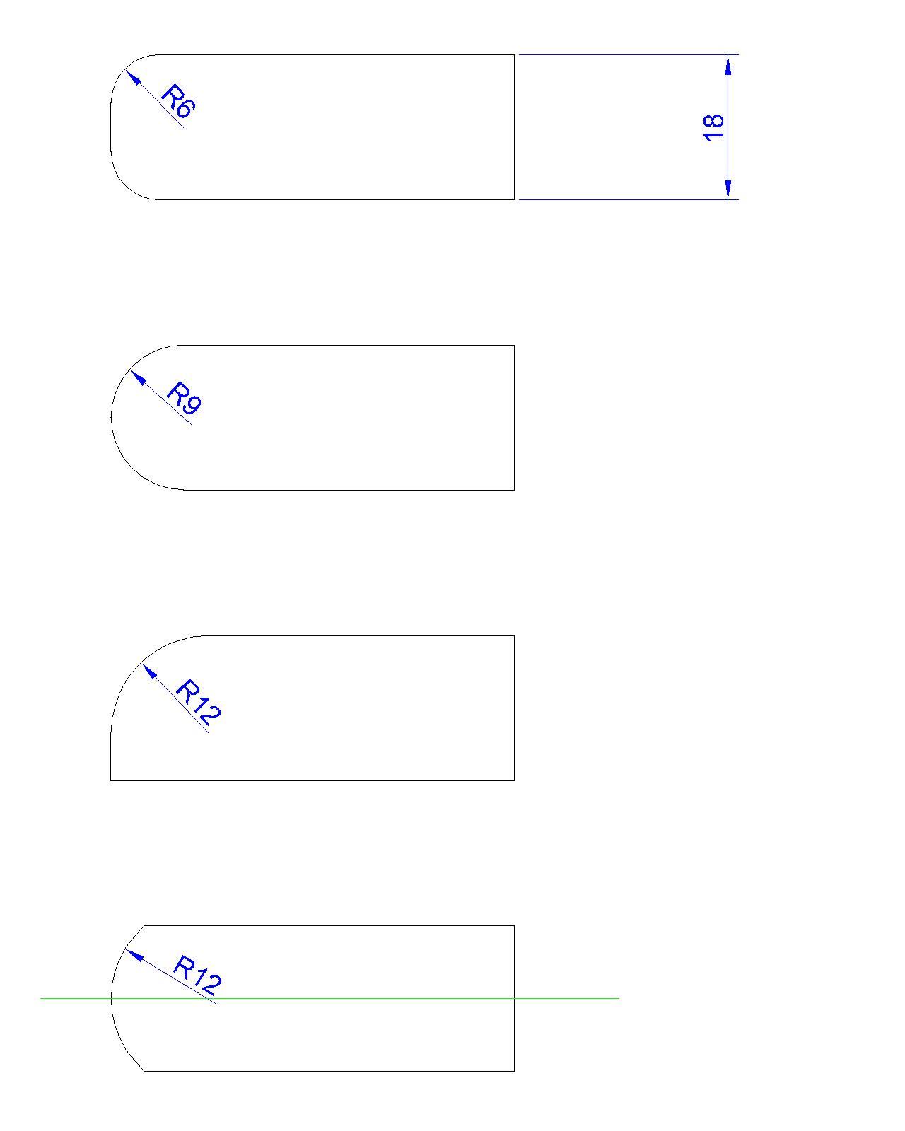

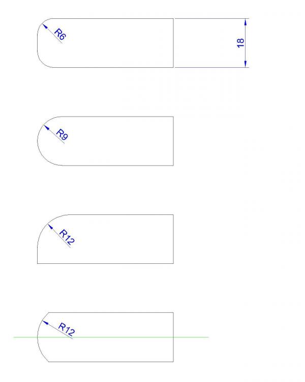

Onoff Posted September 27, 2020 Share Posted September 27, 2020 (edited) Loads of options depending on what router bits you have: Edited September 27, 2020 by Onoff Link to comment Share on other sites More sharing options...

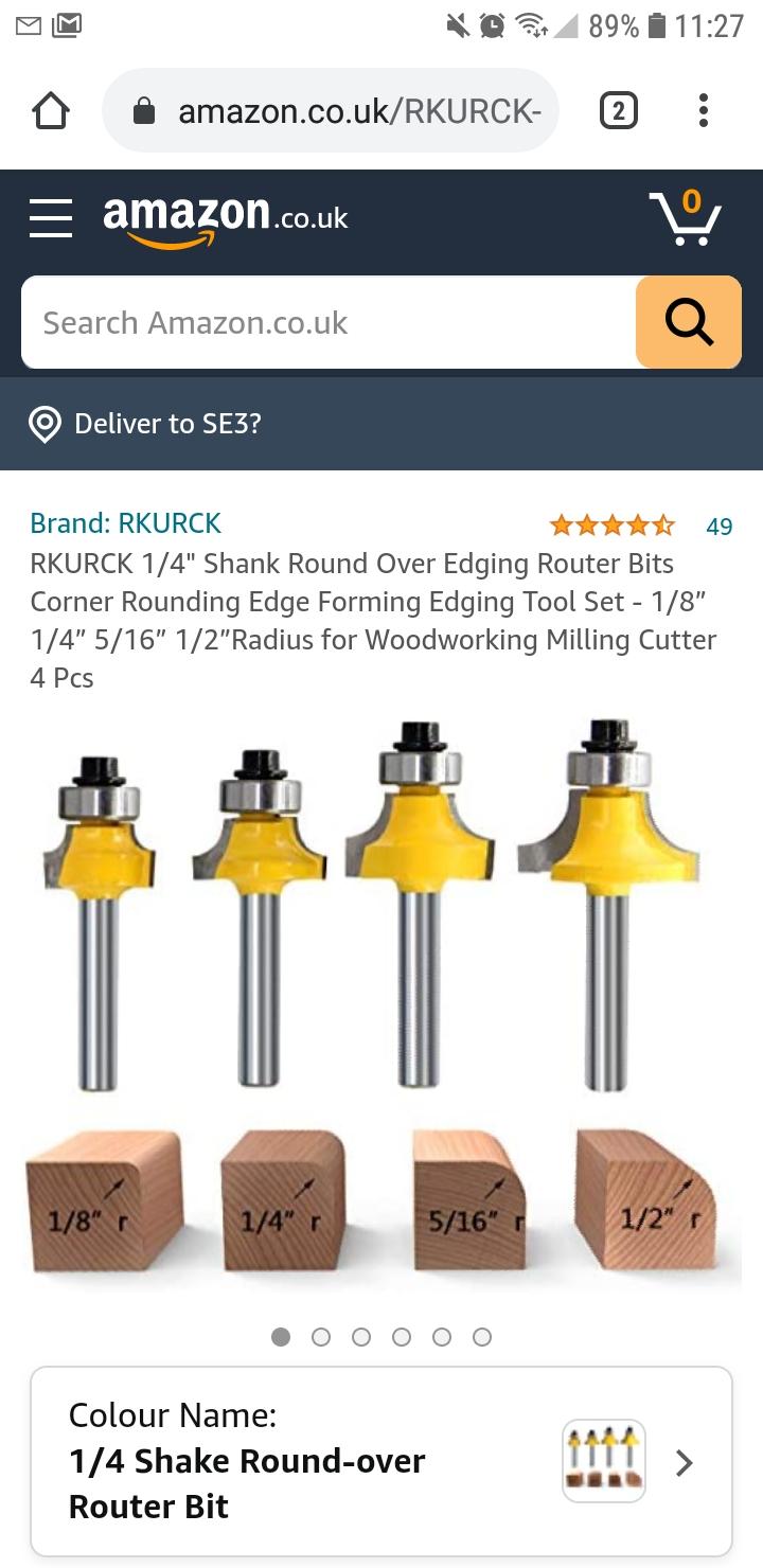

zoothorn Posted September 27, 2020 Author Share Posted September 27, 2020 @Onoff ok understood- thanks for that. The 1st R12 example I saw on skirting deemed "bullnose" in jewsons (& the more usual last R12 profile above.. but can't quite understand how this is done to be different to the previous one but nevermind I don't have an R12 anyway).. now that's one bizarre bull's nose shape in my book. Link to comment Share on other sites More sharing options...
joe90 Posted September 27, 2020 Share Posted September 27, 2020 I think r6 or r9 will look good. Link to comment Share on other sites More sharing options...
Onoff Posted September 27, 2020 Share Posted September 27, 2020 (edited) 1 hour ago, zoothorn said: can't quite understand how this is done With this sort of bit. If it's all covered in carpet then the radius is fairly immaterial. It's just something for the carpet to curve round rather than a sharp edge. Edited September 27, 2020 by Onoff Link to comment Share on other sites More sharing options...
zoothorn Posted September 27, 2020 Author Share Posted September 27, 2020 @Onoff yes thanks that does remind me to replace mine (I have 1 router with r'over bit in permanently in for my cab edges.. but forget what r it is, but it'll do as you say) with a quality one for a change.. helpful post! thanks. Link to comment Share on other sites More sharing options...
