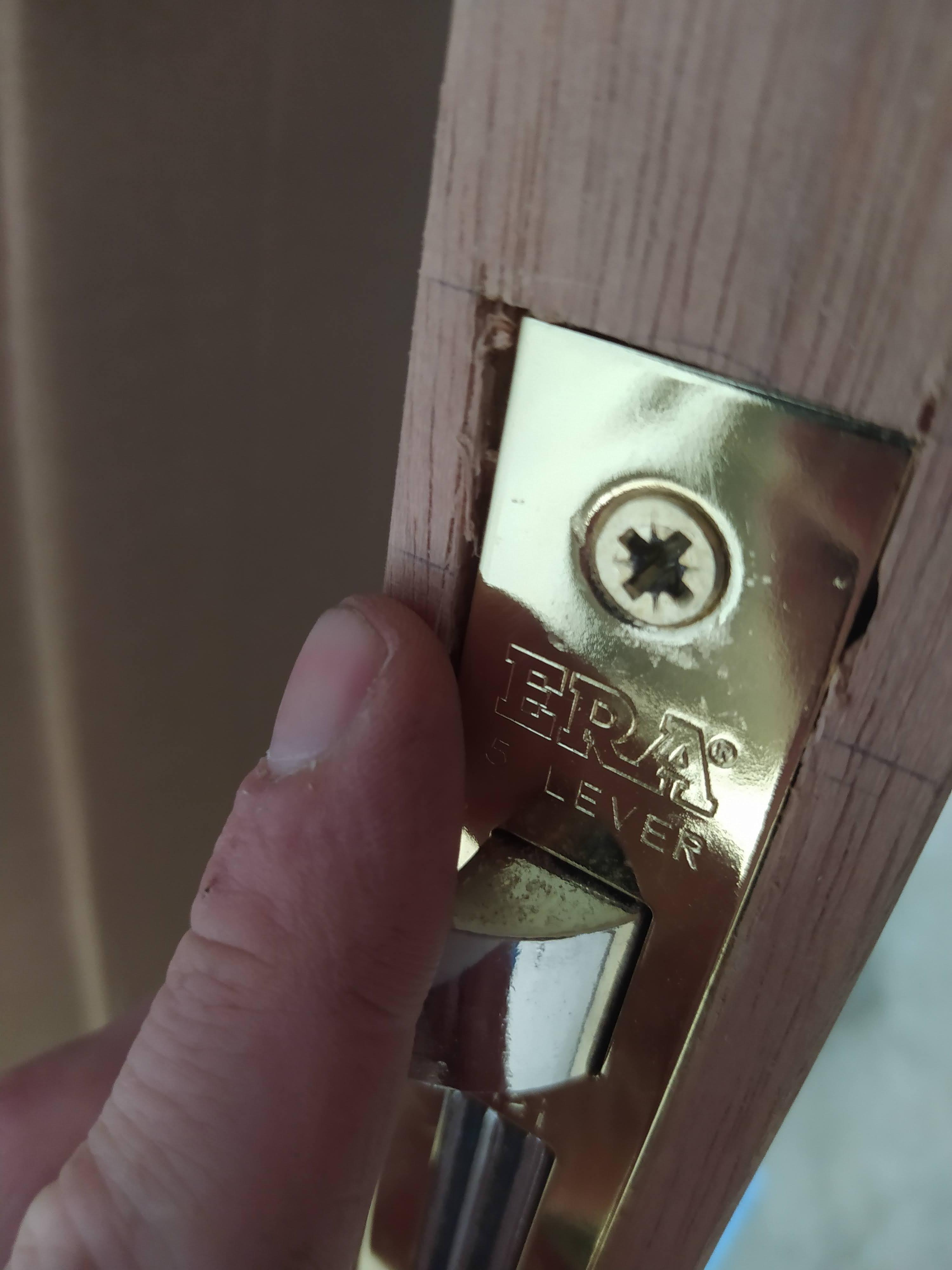

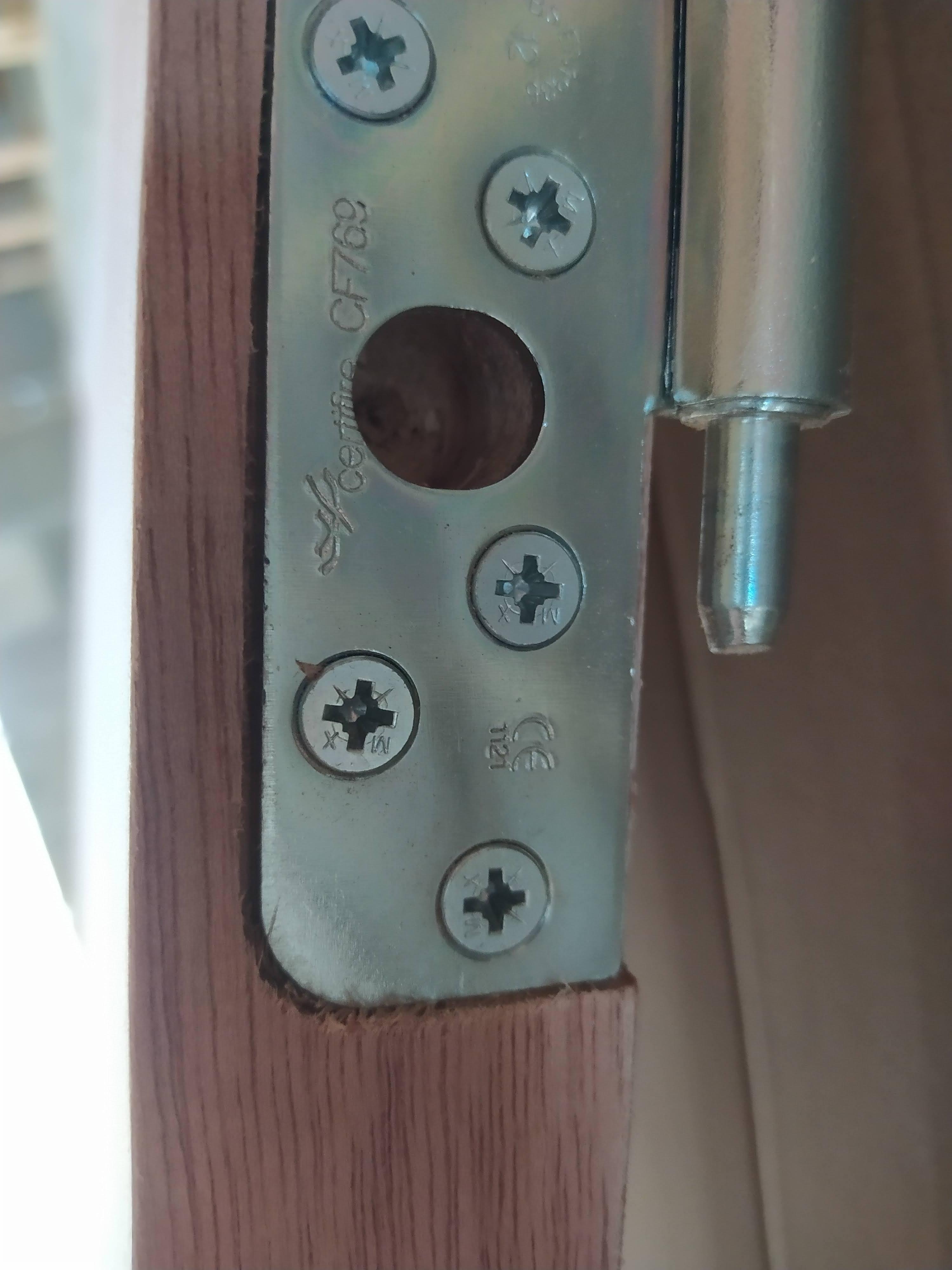

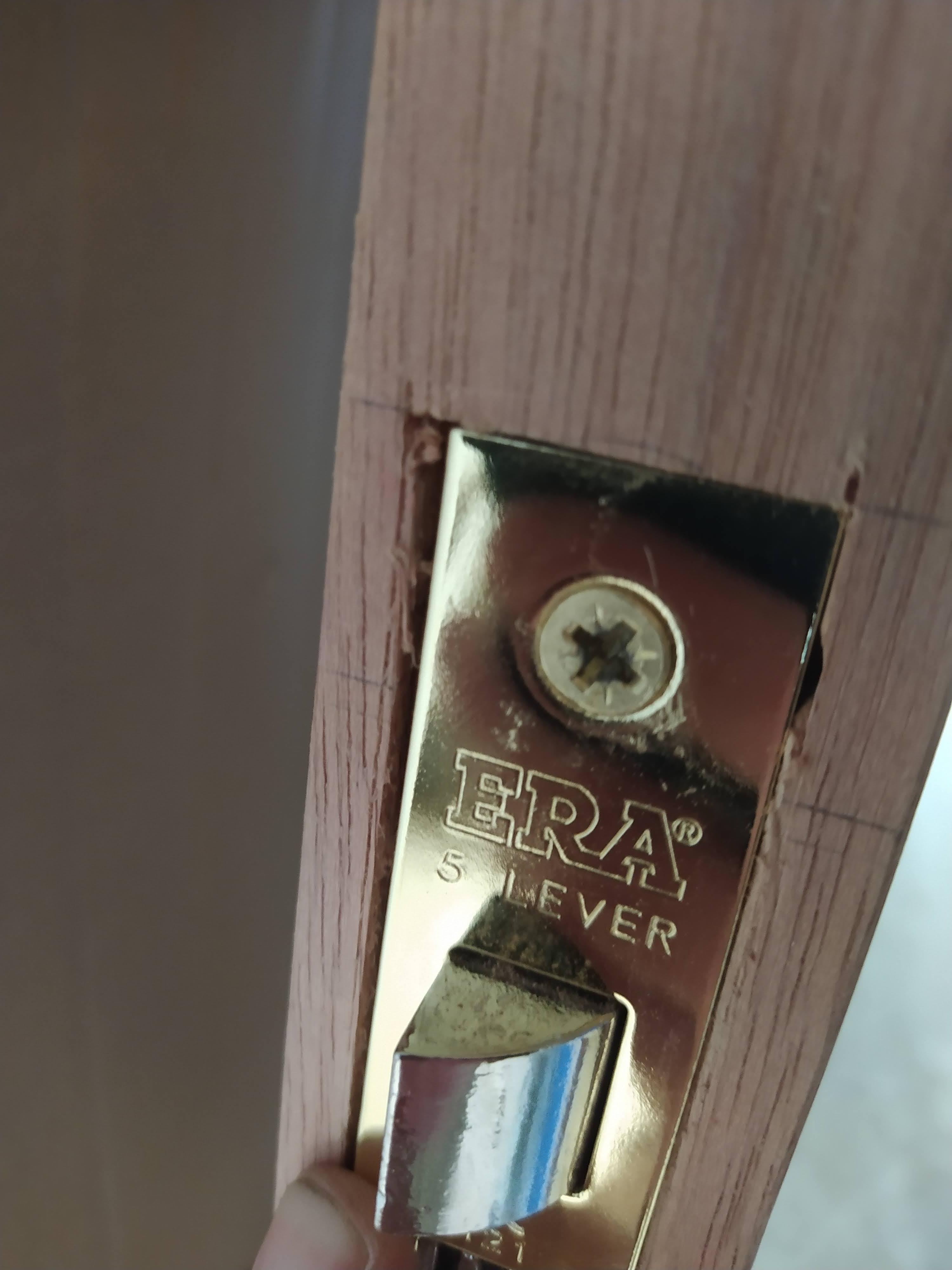

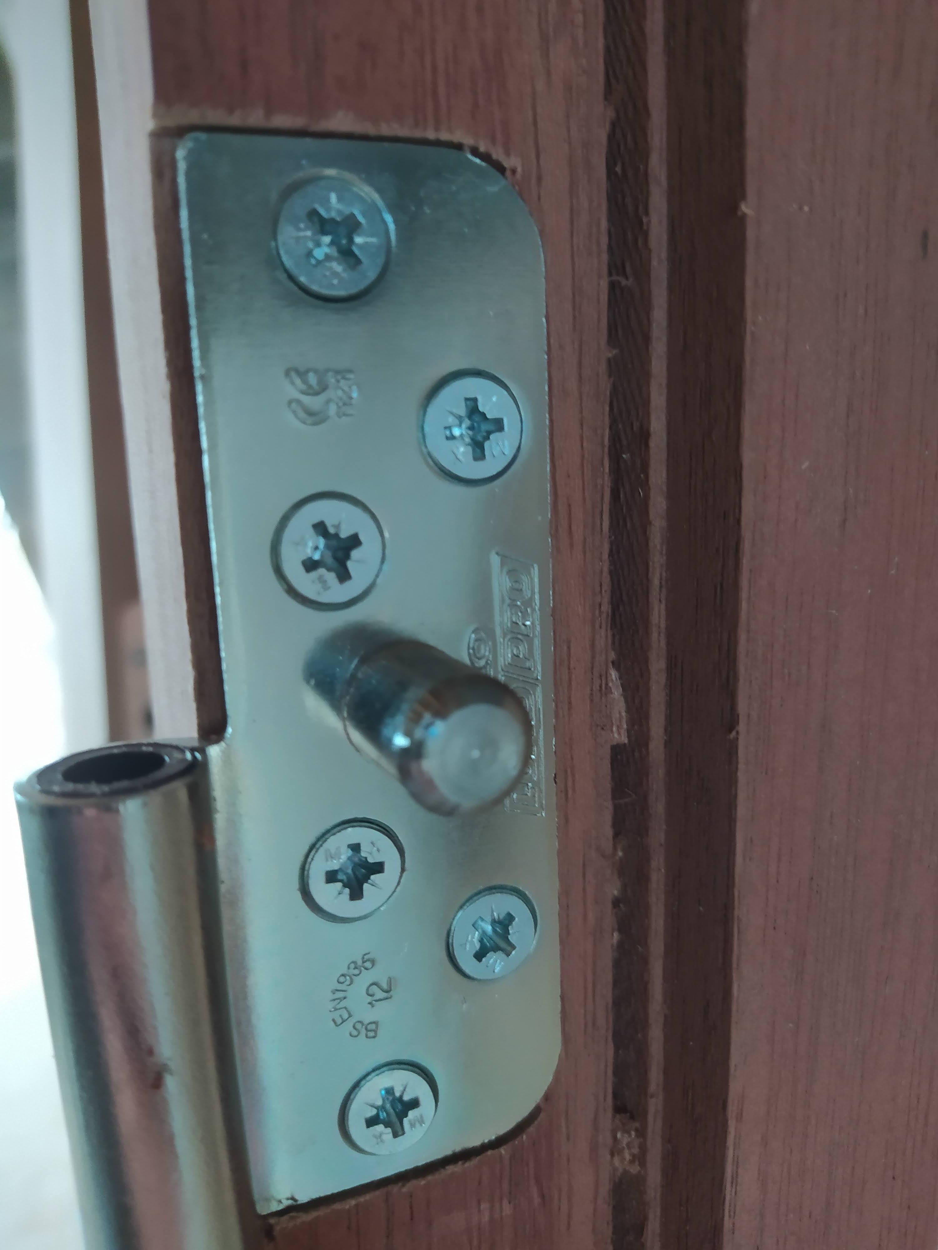

willbish Posted September 3, 2020 Posted September 3, 2020 I took delivery of a prehung doorset from an online door retailer. Is this quality a bit below standard? I was expecting them to use a jig and router but it has been hand chiseled. I reckon I could have done as good a job myself despite only having done a few hardwood external doors.
markc Posted September 3, 2020 Posted September 3, 2020 OMG! the lock rebate looks awful, yes ive seen much worse on new build houses but anyone selling `pre-hung` doors etc should be geared up with the necessary tooling and jigs etc. I would complain and want a decent discount as a minimum.
Mr Punter Posted September 3, 2020 Posted September 3, 2020 Send it back it is awful. It looks like they used a pocket squirrel.
ProDave Posted September 3, 2020 Posted September 3, 2020 Put it this way, if I had employed a joiner to do that, he might not be getting paid, at least not his full price. That's the sort of rubbish I could do myself, which is why I choose to get someone better.
joe90 Posted September 3, 2020 Posted September 3, 2020 I would not pay for that (and I can do much better).
Declan52 Posted September 3, 2020 Posted September 3, 2020 Is it possible that that door originally came with different hardware and was changed to what we see now. Both the hinge and door catch are not for them holes. Either that or Stevie wonder has bought a set of chisels and a lump hammer. No chance I would be paying for that.

Mr Punter Posted September 3, 2020 Posted September 3, 2020 The hinges were bad but the latch was mental! Agree to them having the chance to put it right. Maybe they outsource to others and are not aware of some issues.

scottishjohn Posted September 11, 2020 Posted September 11, 2020 58 minutes ago, willbish said: A partial refund for repair has been offered, £55.45 My response was to ask if they could put me in touch with the joiner that will come to fix it for that ? how is a joiner going to fix rebates that are too big?-unless he is going to fit larger door furniture

Declan52 Posted September 17, 2020 Posted September 17, 2020 What exactly did they mean by they could collect the door when passing?? As in I think we might be in your area in December, January and will lift it then type of thing or did they give you an approximate time scale to do this. I think you have been pretty fair with them throughout and have gave them enough time to come to a satisfactory conclusion which so far they haven't. So what happens now are you going to try and source bigger hinges and lock to try to hide the poor work???
willbish Posted September 17, 2020 Author Posted September 17, 2020 No timescale to collect. Judging by the speed of communication it could well have been Christmas. I'm going to take the £55, and yep get some larger hinges. With regards the lock, no idea yet, filler and then router? I just need to get the frame fitted tomorrow for the renderer to start. Will sort the door another day
