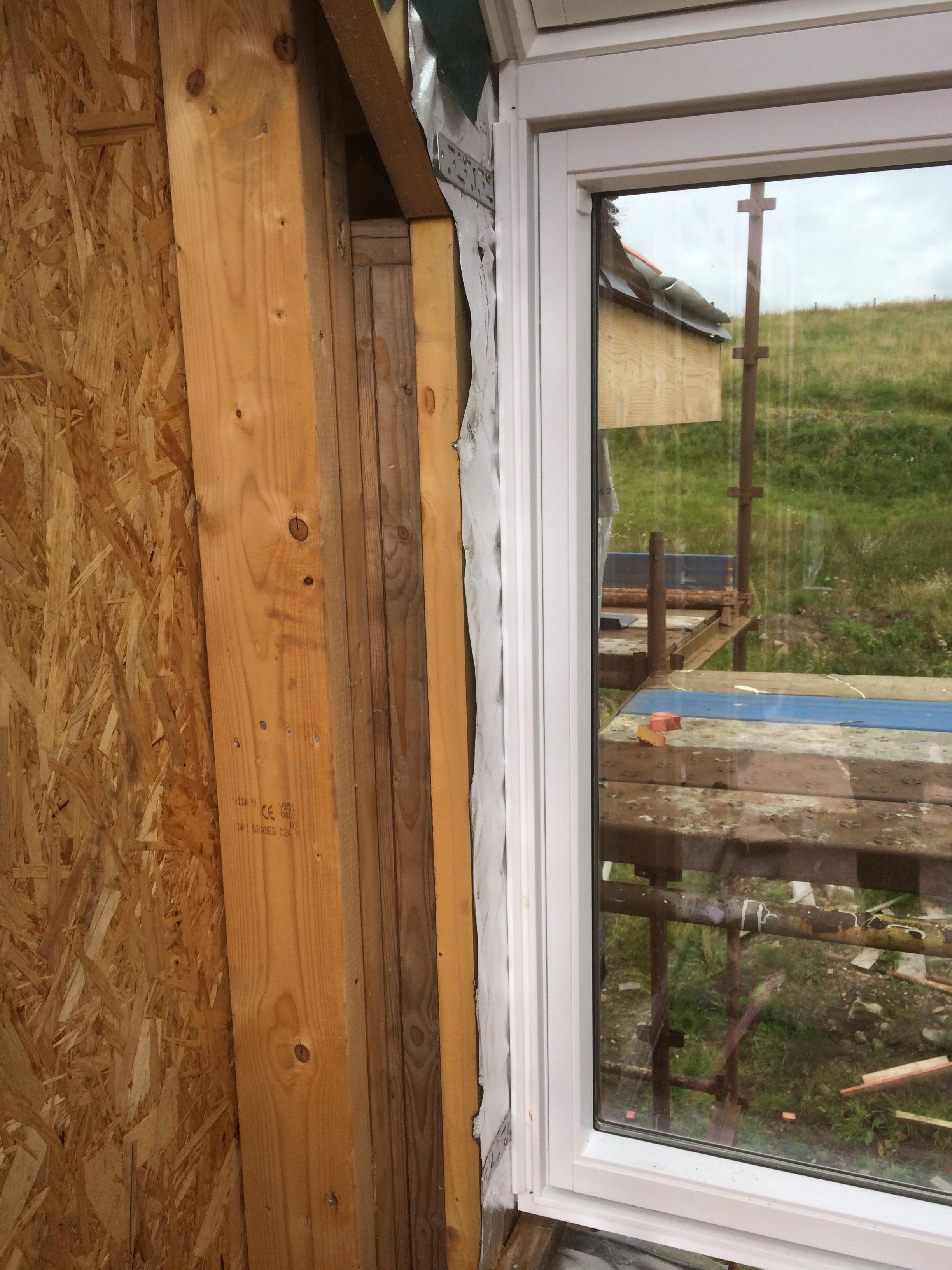

GrantMcscott Posted August 18, 2020 Posted August 18, 2020 Hi I have put in some of my windows with a tolerance around the frame. I have been looking on the internet but not sure how to fill this gape now. This is a timber frame house and the windows have fire stops around them. Is there a flashing kit or tape for the outside I can use Should I just use expandable foam and sealants to the breather membrane With water Ingres and air tightness what is the correct way to do this 1

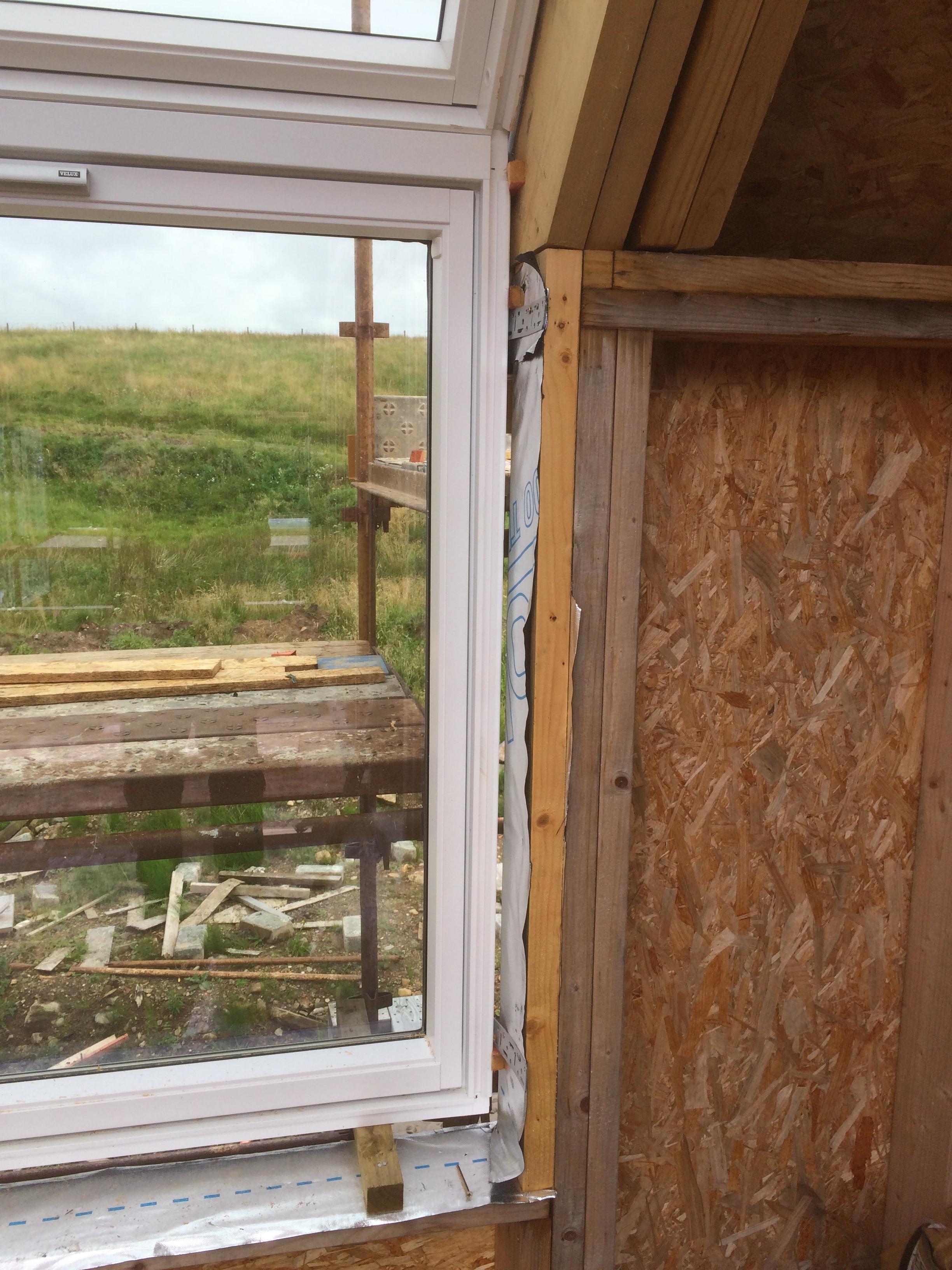

GrantMcscott Posted August 19, 2020 Author Posted August 19, 2020 Here are photos I need to seal the gaps after a sill has been fitted but was going to fill gaps left and right to make it a bit more water tight to the building wrap What do do you use inside and out to do this properly so it is air tight and water proof
ProDave Posted August 19, 2020 Posted August 19, 2020 Outside edge, compriband expanding foam. Inside edge, tape to your building frame with air tightness tape. If you are going for full air tightness you will be doing this anyway.
Gone West Posted August 19, 2020 Posted August 19, 2020 My windows were fitted, by the suppliers, with a strip of Compriband around the centre of the frame. I then fitted another strip of Compriband around the outside edge and I foamed the inside edge with Soudal Low Expansion Flexifoam. I didn't use any airtightness tapes or membranes and achieved 0.47ACH. 1
craig Posted August 19, 2020 Posted August 19, 2020 (edited) First picture you appear to be pretty tight to the frame, using the thin nozzle for the PU foam, might be a challenge to fill. I would try and squeeze in a 3 to 7mm expanding compriband and repeat on the right side on the inner and outer section of the frame but you might just be too tight. You won't need anything else, no need for airtighness tape. I would PU foam the bottom and apply an airtightness tape here, you have got a large gap at the bottom. I would suggest compriband but it wouldn't be economical to do so. A single roll would be approx 5 to 8m length and you would waste about 4m of it, costing in excess of £100 for 1 roll. Edited August 19, 2020 by craig 1
Gone West Posted August 19, 2020 Posted August 19, 2020 I should have said before that Compriband is great but the only problem is that it expands very quickly when the weather is warm. When trying to squeeze the tape in between a window opening and window frame it can be tricky. Also if the gap is larger than the tape is meant for, it may not be weathertight. There is a range of tape sizes for different gaps. If 3 to 7mm isn't thick enough there is 5 to 10mm or 7 to 12mm.
Mr Punter Posted August 19, 2020 Posted August 19, 2020 Keep Compriband in the fridge if you are using it in warmer months. 1
craig Posted August 19, 2020 Posted August 19, 2020 (edited) 1 hour ago, PeterStarck said: Also if the gap is larger than the tape is meant for, it may not be weathertight. Just a fyi, a tape designed for 7 to 12mm gaps for example would give 900 pascals at 7mm and works for thermal insulation and acoustic insulation. 12mm the same but the pascal drops to 600. Past the 12mm you lose the gaurantee on weather tightness but would expand upto 21mm but ideally not past the tape width. https://www.illbruck.com/en_GB/product/tp600-compriband-600/ technical data sheet, page 3 of PDF. Edited August 19, 2020 by craig

joth Posted August 20, 2020 Posted August 20, 2020 OP appears to be using Compriband inside a timber frame - this is interesting as our installers turned up with rolls of the stuff but refused to use it because the windows were being installed inside OSB boxes, where they said airtight tape and squirty foam is a better finish and that the Compriband only makes sense when the windows are installed directly into brick/block finish walls. Any truth in that?
markc Posted August 20, 2020 Posted August 20, 2020 Compriband is excellent for sealing against brick/blockwork and does work equally well against OSB, i reckon they just took the easy option
craig Posted August 20, 2020 Posted August 20, 2020 1 hour ago, joth said: where they said airtight tape and squirty foam is a better finish and that the Compriband only makes sense when the windows are installed directly into brick/block finish walls. Any truth in that? None what so ever. They have taken the easy option. Compriband does more than just seal a window, it has thermal, acoustic and weather tightness properties.

craig Posted August 21, 2020 Posted August 21, 2020 (edited) 2 hours ago, joth said: Out of interest, do you have any source for this? Ideally I'd like something that quantifies the improvements. Trying to understand if this is small marginal gains or a fundamental point any passivhaus should have insisted on Cheers https://www.illbruck.com/en_GB/products/innovations/i3-system/ Essentially an i3 application (3 layers) in a PH it's a given to be honest, it doesn't matter who supplies the products but it should be installed as standard. PU foam is not water tight it's an insulation layer. ME508 or equivalent is not water tight, it is an airtighness layer. So what weather tightness has been applied on the external aspect of the window frame? That's why compriband is used. It has thermal properties, it has weather tightness properties, it has acoustic properties and we all know the importance of thermal performance in a Passive House. Edited August 21, 2020 by craig 1 1
GrantMcscott Posted August 21, 2020 Author Posted August 21, 2020 4 minutes ago, craig said: https://www.illbruck.com/en_GB/products/innovations/i3-system/ Essentially an i3 application (3 layers) in a PH it's a given to be honest, it doesn't matter who supplies the products but it should be installed as standard. PU foam is not water tight it's an insulation layer. ME508 or equivalent is not water tight, it is an airtighness layer. So what weather tightness has been applied on the external aspect of the window frame? Hi Craig Nothing has been applied to the exterior to make it weather tight. What would you recommend?
craig Posted August 21, 2020 Posted August 21, 2020 1 minute ago, GrantMcscott said: Hi Craig Nothing has been applied to the exterior to make it weather tight. What would you recommend? Just by the pictures, you may not have the relevant gaps for a compriband. I would apply ME501 VV. I only recommend Illbruck, as it's what we use all the time and it does the job, I don't get anything from it. https://www.illbruck.com/en_GB/product/me501-vv-duo-window-membrane-hd/ 1
