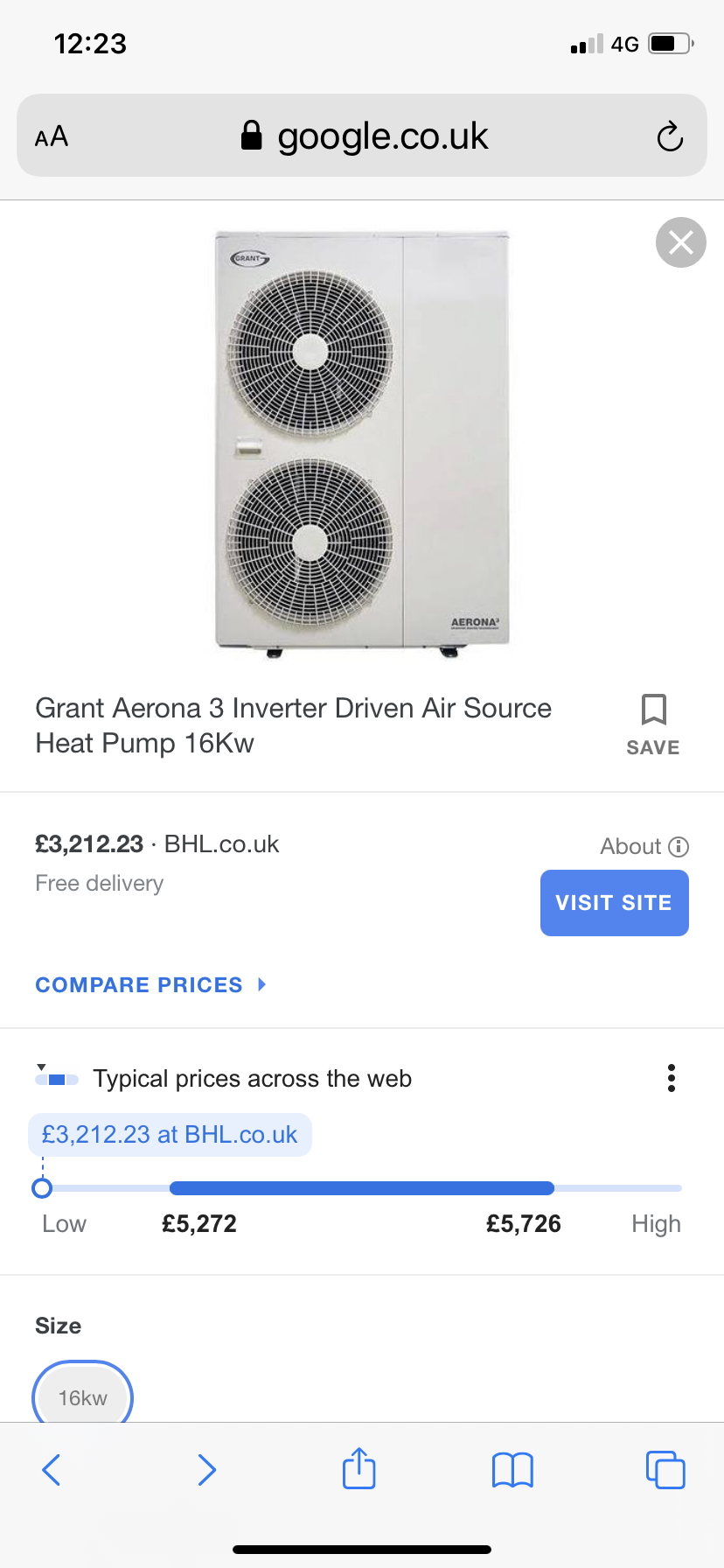

Roz Posted October 20, 2020 Author Posted October 20, 2020 18 hours ago, Nickfromwales said: How much more is the 10kW one? Over £1000 from a quick look on city plumbing, which surprised me!
PeterW Posted October 20, 2020 Posted October 20, 2020 8 minutes ago, Roz said: Over £1000 from a quick look on city plumbing, which surprised me! City Plumbing price will be full RRP unless you have an account and are logged in. 1
Roz Posted October 20, 2020 Author Posted October 20, 2020 1 minute ago, PeterW said: City Plumbing price will be full RRP unless you have an account and are logged in. They've been giving a discount when I email them, which I heard from our plumber was the same price he gets, which he wasnt very happy about. But still I think the difference between the two will still be large.
Roz Posted October 20, 2020 Author Posted October 20, 2020 16 hours ago, Dan F said: Also, remember that the power output varies based on outside temperature and flow temperature. So if possible get the datasheet and use the values on this rather than the "headline" number in the model name if possible when comparing with your requirements. By way of example a "7kW" ASHP I'm looking at is: - 7kW at 55C flow and -5C external temp. - 10kW at 35C flow and 2C external temp. We're in Cornwall so rarely get below freezing Grant 6kw: 0C air 35C flow -6.2kw 0C air 55C flow- 5kw -3C air 35C flow - 5.9kw -3Cair 55C flow - 4.7kw I am trying to find the Daikin ones but their website keeps failing for me.
Nickfromwales Posted October 20, 2020 Posted October 20, 2020 2 hours ago, Roz said: Over £1000 from a quick look on city plumbing, which surprised me!
Nickfromwales Posted October 20, 2020 Posted October 20, 2020 £3200 for a 16kw so twice the Uk average for a good quality gas combi. What price have you been given. ?
Roz Posted October 20, 2020 Author Posted October 20, 2020 (edited) 15 minutes ago, Nickfromwales said: £3200 for a 16kw so twice the Uk average for a good quality gas combi. What price have you been given. ? I was looking at £1970 plus vat for the 6kw Grant, their price is £1,338.43 which is a lot less! Nice find Edit: Their trustpilot reviews are weird I've got an issue with space though which might help make the decision between Daikin and Grant, apparently the Grant needs a 30 litre floor mounted buffer tank and we dont have any floor space for it... we just have a space in the top of a cupboard a metre away from the UVC? Edited October 20, 2020 by Roz

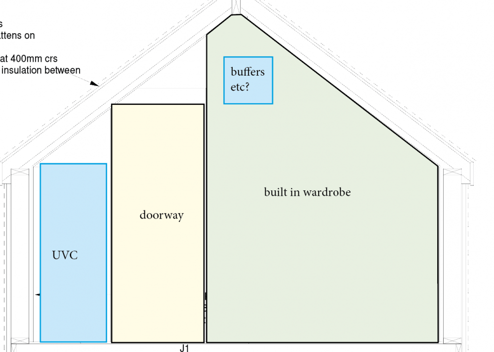

Roz Posted October 20, 2020 Author Posted October 20, 2020 (edited) 31 minutes ago, Roz said: I was looking at £1970 plus vat for the 6kw Grant, their price is £1,338.43 which is a lot less! Nice find Edit: Their trustpilot reviews are weird I've got an issue with space though which might help make the decision between Daikin and Grant, apparently the Grant needs a 30 litre floor mounted buffer tank and we dont have any floor space for it... we just have a space in the top of a cupboard a metre away from the UVC? 35 minutes ago, Nickfromwales said: £3200 for a 16kw so twice the Uk average for a good quality gas combi. What price have you been given. ? Like this... apparently the grant buffers have to be floor mounted This is upstairs. Edited October 20, 2020 by Roz
Nickfromwales Posted October 20, 2020 Posted October 20, 2020 That’s fine. I’ve put plenty of 35L expansion vessels on walls. Or, wall mounted buffers are common to outsource anyway. Link or Link They may be asking for that for defrost, so there is a body of water the unit can draw back to itself to assist / accelerate or provide defrost function without using an inbuilt immersion. A buffer is the most economical way to defrost vs direct ( 3-6kW!!!! ASHP immersion ) so a wise choice. Do you know if the buffer operates in line with heating and DHW or just heating?
Roz Posted October 20, 2020 Author Posted October 20, 2020 2 hours ago, Nickfromwales said: That’s fine. I’ve put plenty of 35L expansion vessels on walls. Or, wall mounted buffers are common to outsource anyway. Link or Link They may be asking for that for defrost, so there is a body of water the unit can draw back to itself to assist / accelerate or provide defrost function without using an inbuilt immersion. A buffer is the most economical way to defrost vs direct ( 3-6kW!!!! ASHP immersion ) so a wise choice. Do you know if the buffer operates in line with heating and DHW or just heating? So the fact that the grant one is a floor mounted one wouldn't stop you doing it in this scenario? I thought maybe that had just made my decision for me but I'm not so lucky ? I'm not sure about how the buffer operates, I wish I knew more about the heating system but it's been one of the areas I've shied away from . I know that the merchants has said you don't need an extra buffer for the Daikin copared to the Grant, With the Daikin you have to get an 18l 'intermediate vessel' but with the grant you need the Grant Sealed System Kit as well as a floor mounted 30 litre buffer tank (which comes with Kit 2 :https://www.cityplumbing.co.uk/Grant-Aerona-3-Installation-Pack-2-(Incl-Eight-Core-Accessories-Plus-A-30L-Insulated-Volumiser)/p/470493?gmcpid=470493&gclid=CjwKCAjwlbr8BRA0EiwAnt4MTom45M-h3mwv5ojuy8U8y1uoFXjSMjPr47CczalekdDktULrIX6UYxoCeacQAvD_BwE&gclsrc=aw.ds#fo_c=2832&fo_k=aea9e118aa9151686c97a2d96f02ff32&fo_s=gplauk
Roz Posted October 20, 2020 Author Posted October 20, 2020 If you don't need the extra buffer with the Daikin though, thats still a selling point as all these buffers are taking up very precious storage space

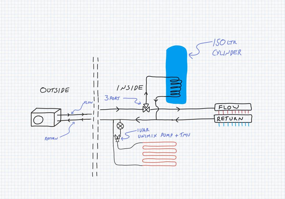

ruggers Posted November 26, 2022 Posted November 26, 2022 So Looking at the 7kw and 5kw Arotherm plus to install in a self build not started yet, there's a few things I need to understand related to sizing the pump & heat loss. My heat loss with natural ventilation is 6.2Kw, or 4.6kw with MVHR fitted which will be getting installed. I can improve this slightly and both of these figures include 10% added on for exposed location due to height & coastal area up North. Both Vaillant and the Vaillant local installer have said that when sizing for an ASHP, they have to exclude MVHR from the heat loss survey and base it on natural ventilation as thats the worst case situation of when someone returns from holiday to a house that hasn't had it's heating on and theres no heat for the MVHR to recover. It's quite annoying because using the higher 6.2Kw figure means that I need to size my radiators much bigger, and the physical size of them increases which for my largest bedroom & my main bathroom end up huge. I wanted to lower the flow temperature to get the system running as efficient as possible but going below 42.5°C flow (40 MWT at DT5) is the lowest I can go. having a 40°C flow (37.5 MWT) means that my bathroom radiator has to be 2400w and it would look too big for that room. The heat loss for the bathroom is 559W before a scaling factor is applied. A small reduction in mean water temperature has a huge impact on enlarging the radiator size. If I was able to use my lower house heat loss figure of 4.6Kw, it would allow me to run at a lower flow & return as the heat loss per room is much lower.
HughF Posted November 26, 2022 Posted November 26, 2022 1 hour ago, ruggers said: So Looking at the 7kw and 5kw Arotherm plus to install in a self build not started yet, there's a few things I need to understand related to sizing the pump & heat loss. My heat loss with natural ventilation is 6.2Kw, or 4.6kw with MVHR fitted which will be getting installed. I can improve this slightly and both of these figures include 10% added on for exposed location due to height & coastal area up North. Both Vaillant and the Vaillant local installer have said that when sizing for an ASHP, they have to exclude MVHR from the heat loss survey and base it on natural ventilation as thats the worst case situation of when someone returns from holiday to a house that hasn't had it's heating on and theres no heat for the MVHR to recover. It's quite annoying because using the higher 6.2Kw figure means that I need to size my radiators much bigger, and the physical size of them increases which for my largest bedroom & my main bathroom end up huge. I wanted to lower the flow temperature to get the system running as efficient as possible but going below 42.5°C flow (40 MWT at DT5) is the lowest I can go. having a 40°C flow (37.5 MWT) means that my bathroom radiator has to be 2400w and it would look too big for that room. The heat loss for the bathroom is 559W before a scaling factor is applied. A small reduction in mean water temperature has a huge impact on enlarging the radiator size. If I was able to use my lower house heat loss figure of 4.6Kw, it would allow me to run at a lower flow & return as the heat loss per room is much lower. You sound like you know what you’re doing, and you’re going for full planning on this new build so there is zero reason for you to go through an MCS installer and use their heat loss calcs. Buy the unit (whichever unit you fancy) and pay your plumber to fit it, or do it yourself. It’s really not complicated.
ruggers Posted November 26, 2022 Posted November 26, 2022 @HughF I can't install it, to obtain the 5k grant you need to go through MCS, to get the full warranty you have to be a registered installer and Fgas certified. I can size everything up & I can fit the underfloor, the radiators and piping but not the plant room install or unvented cylinder. All these new regs, Part L and complying with things that require heat loss surveys for weather compensation, and then we don't stick to the figures used from the results.
