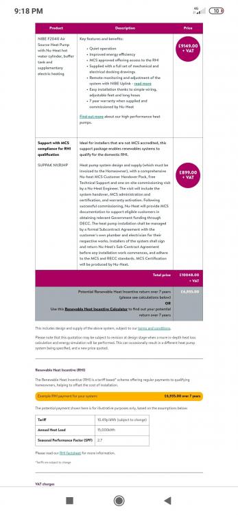

Soooo, met plumber and he is going to sort out pricing comparison for 300/400 litre tanks.
I mentioned making sure tanks had immersion element as we are obtaining some pricing for solar and he said he will raise this with Alto energy. He was sceptical on how much solar would actually contribute to hot water of the ASHP and seemed to think we couldn't do this going down the RHI route.
I'll wait to see what he comes back with and in interim see what prices I get back for solar.

Now we have finalised the solar materials quote we have had an updated plumbing quote. It's around £900 more and the changes seem to be from the initial heat pump and 210 cylinder (quoted as per the plumbing quote above £7749.08):
To this (£8690)
A Mitusubishi 11kw 1P air source heat pump, 400 litre Gledhill Heat Pump Pressurised cylinder, low loss header, 40litre expansion vessel, 4 x circulating pumps, 3 port zone valevs and all other required items for new design.
As per the suggestions on here we asked for the larger tank, to 400 litre rather than the 210 one as I believe this will go in our favour for solar and hot water.
I'm still really confused and then came across this thread on a similar matter by @gc100
OurPV controller we had earmarked is the Solic200 but we can look at alternatives.
I still can't work out if what the plumber is now saying we need to work with the solar is correct.
Along with the heat pump is my plumber correct in saying we also need a 400 litre Gledhill Heat Pump Pressurised cylinder, low loss header, 40litre expansion vessel, 4 x circulating pumps, 3 port zone valevs and all other required items for new design.
@ProDave @Nickfromwales
Can you confirm if this makes sense or is far more complicated than what we need.
@PeterW forgot to include you too as you provided some initial advice.
Just want to make sure this is all OK before giving him the go ahead and I'm not missing something or paying over the odds for something we don't need.
I think the previous 210litre tank was around £2500 but I believe the Gledhill 400litre is cheaper but then there is the additional parts and work so perhaps that accounts for the price difference. I'm so confused.

Tanks are a personal preference but assuming he is going with the Gledhill pre-plumb it seems ok. Is he integrating it with the heat pump and the Mitsubishi controller as I thought the quote was for the Mitsubishi pre-plumbed cylinder ..??
Initially he had quoted for the pre-plumbed Mitsubishi 210 but has now changed the quote completely and got rid of this because apparently we can't have it with the solar immersion controller thingy (and we wanted the bigger tank) and has replaced it with the 400litre Gledhill and all that other stuff.
Ok - not sure why he’s got 4 pumps but worth checking. Has he provided a design schematic ..? Expansion vessel, low loss header would have been needed regardless as they are not built into the pre-plumbed tank.
Also ask for brand and spec on the pumps - some are really noisy !!!
Nope just updated the quote. If they were all required before I'm not sure why it's quite a bit more expense.
I'll ask which brand the pumps are.
