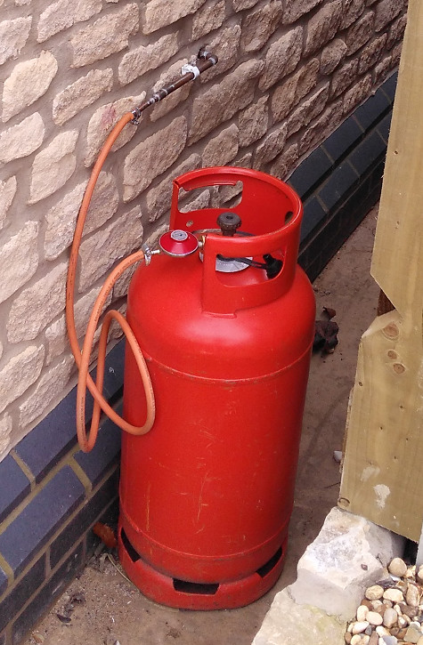

JanetE Posted December 31, 2016 Share Posted December 31, 2016 Not sure if this is the correct place for this topic! Just fitting out the kitchen and we are having a 2 ring gas hob as a backup for our electric hob. The cylinder will sit outside and we have to run the pipe through the wall. I know we need to use 10mm copper and I assume the best option is to get a pipe spring so we can fit it without any solder bends. As the hob will use very little gas we see no point in having more than one cylinder. We shall make a box to cover it from the weather. So we need to get the correct connectors for this as well. Terry has done quite a lot of plumbing but not with 10mm for LPG. Would be grateful for your suggestions Link to comment Share on other sites More sharing options...

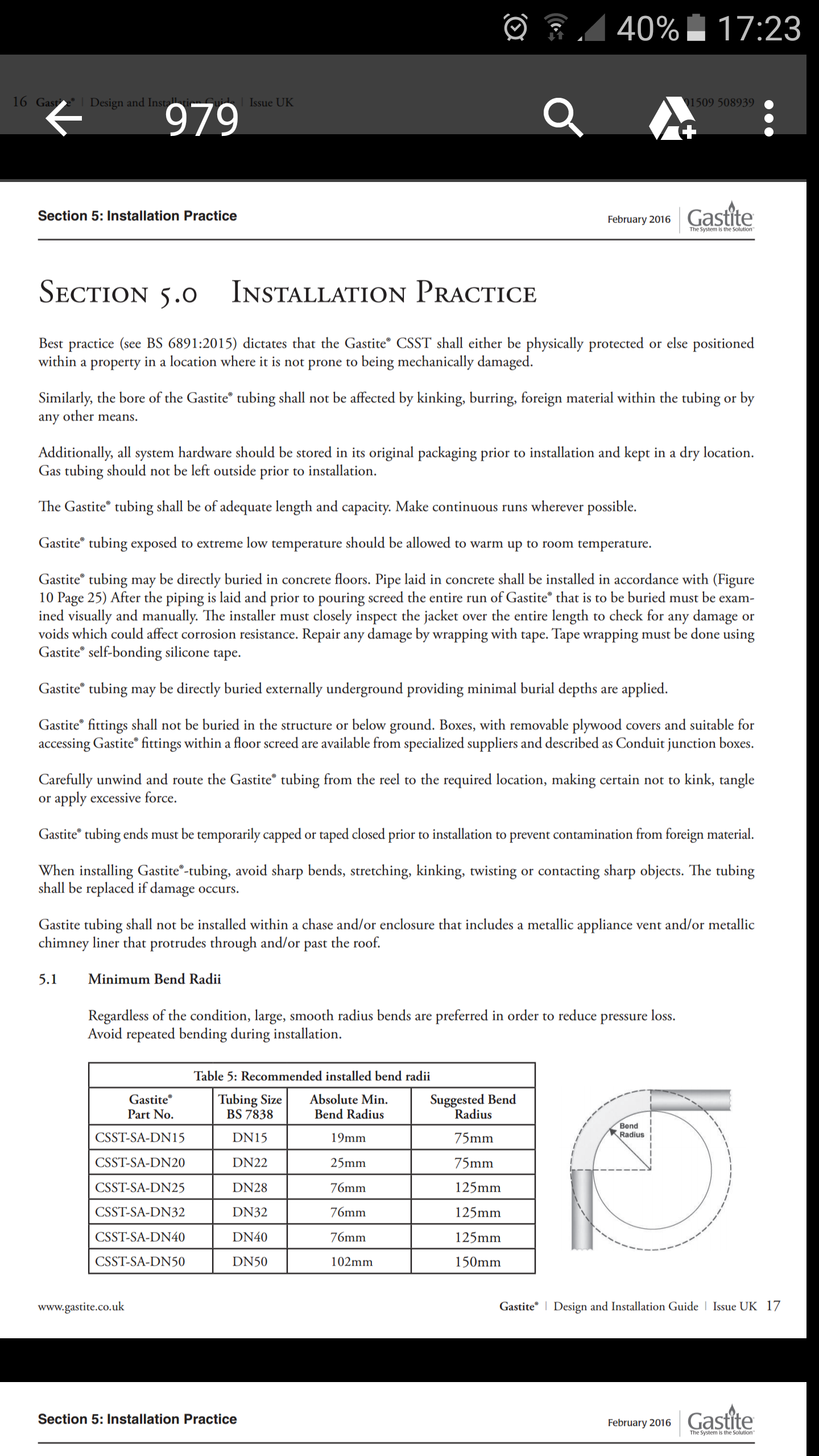

dogman Posted December 31, 2016 Share Posted December 31, 2016 Has anyone used the "gastite" pipe. I was going to run a length under the slab in to the kitchen for the plumber to fit later. Not sure if it has to be ducted but i was going thinking it would be best. http://www.gastite.co.uk/pdf/installation_guide.pdf Link to comment Share on other sites More sharing options...
Nickfromwales Posted December 31, 2016 Share Posted December 31, 2016 @JanetE Go for the plastic coated soft copper and endeavour to be 'joint free'. Remember that you'll have to remove the coating to get a bending machine to fit the radius . Re-cover with yellow electrical ( pvc ) tape, no probs there. You can mount the LPG bottled remotely, e.g. behind / alongside an outbuilding, or right at the rearmost quarter where they won't be seen. They don't have to be against the house, and fwiw, I'd prefer them well away from the skin of my TF house in case of a leak. Go for the best of all options :- 1) Fit small bottles. Lower line of sight for the 'cover' as you haven't got one single 5' bottle to try and hide. 2) Fit an auto-changeover arrangement with 2x small bottles. No running around in the rain with a spanner whilst the sprouts go cold. 3) You won't need to buy a gauge as you'll see the auto changeover indicator has 'flipped' and then just change the empty at your convenience as you'll know it's spent. 4) Soldering LPG is permissible ( quick google finds the regs ) in a fixed installation. Do not have a compression fitting where it's not accessible or in a void of any kind. You may end up using the gas hob more than you expect as, personally, I dislike cooking on electric, so think twice about a single bottle arrangement . Link to comment Share on other sites More sharing options...
Alexphd1 Posted December 31, 2016 Share Posted December 31, 2016 Yeah gastite pipe is good. We run one in our slab to the island. You don't need to sleeve it. Keep a eye on eBay as you often get off cuts but the fittings are very expensive. Link to comment Share on other sites More sharing options...

PeterW Posted December 31, 2016 Share Posted December 31, 2016 3 hours ago, Alexphd1 said: Yeah gastite pipe is good. We run one in our slab to the island. You don't need to sleeve it. Keep a eye on eBay as you often get off cuts but the fittings are very expensive. Did your plumber advise it was OK to bury in the concrete as is..? Link to comment Share on other sites More sharing options...
Alexphd1 Posted December 31, 2016 Share Posted December 31, 2016 (edited) I'm the plumber (that's going to come back to haunt me)??? we left a long tail to get up behind the kitchen units to upstairs where we will have a compression fitting into copper pipe. As long as it's one length ie no fittings it's fine in concrete, if you need fittings in the concrete then it gets complicated. Remember it's compression fittings on to the gastite pipe and they need to be accessible at a later date. Edited December 31, 2016 by Alexphd1 1 Link to comment Share on other sites More sharing options...

PeterW Posted December 31, 2016 Share Posted December 31, 2016 20 minutes ago, Alexphd1 said: I'm the plumber (that's going to come back to haunt me)??? we left a long tail to get up behind the kitchen units to upstairs where we will have a compression fitting into copper pipe. As long as it's one length ie no fittings it's fine in concrete, if you need fittings in the concrete then it gets complicated. Remember it's compression fittings on to the gastite pipe and they need to be accessible at a later date. So if you read the U.K. Version of that it says you're ok buried in concrete, the US version says you can't ....! How bizarre....! Plastics Express do kits with 5/10/15m of pipe and two fittings from about £60 1 Link to comment Share on other sites More sharing options...
