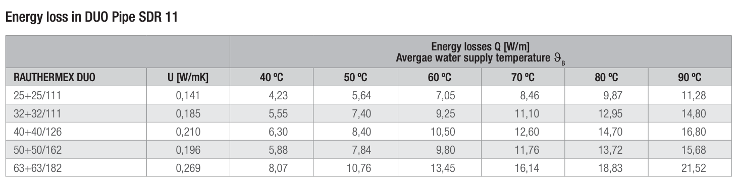

paulc313 Posted August 3, 2020 Posted August 3, 2020 Afternoon Everyone, We are going to purchase a ASHP for our self build. I have reservations about the noise from the pumps ( I work in Environmental Health and deal with noise complaint from them). Also my mum and dad just visited, staying in an Airbnb which had one and the you could hear it ticking over during the night which would really annoy me. I think I've found an alternative position that would make it inaudible but it is 25 metres away next to my father in laws workshop. We will be running a cable anyway from the workshop as were putting PV on the workshops roof to top up the hot water. I just wondered what the heat loss will be like with a 25 metre pipe that's well insulated, could anyone calculate this or know what it would be? Thanks Paul
Dreadnaught Posted August 3, 2020 Posted August 3, 2020 (edited) This was the pipe that was recommended for me to use in a similar situation. My ASHP will be about 15m from my plant room. It is pricey at £50+ per metre. And it is big and fat too (125mm outer diameter) so, if it needs to turn vertical to enter you dwelling, it will need to be buried deep to obtain the radius bend (perhaps 800mm+). http://www.buffertanks.co.uk/shop/microflex-duo-underground-insulated-pipe-kit-2m-32mm-outer Edited August 3, 2020 by Dreadnaught

Dan F Posted August 3, 2020 Posted August 3, 2020 (edited) On 03/08/2020 at 15:51, Dreadnaught said: This was the pipe that was recommended for me to use in a similar situation. My ASHP will be about 15m from my plant room. It is pricey at £50+ per metre. And it is big and fat too (125mm outer diameter) so, if it needs to turn vertical to enter you dwelling, it will need to be buried deep to obtain the radius bend (perhaps 800mm+). http://www.buffertanks.co.uk/shop/microflex-duo-underground-insulated-pipe-kit-2m-32mm-outer Expand I paid £22/m2 for Rauthermex 25+25/111mm DUO Pipe. We are using it for ASHP flow/return, and put it under slab to avoid penetrations in wall and also because our plant room doesn't have an external wall. Edited August 3, 2020 by Dan F
